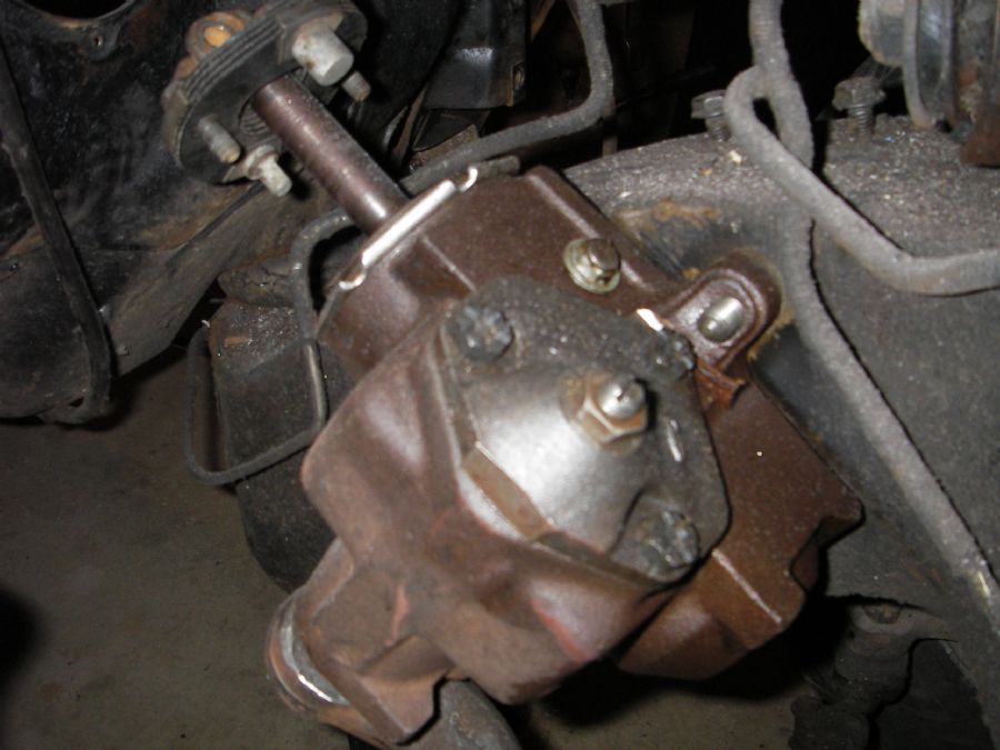

Just took the power steering box off of my 1972 GTS and the part number stamped on it is;
D20A-3B153 It originally had a 429 engine that was swapped out with a 351C, but I don't think that matters It has the Ford integral power steering gear box. Does that part number sound right to anyone?

D = 1970's 2 = year of the decade, 1972 O = Fairlane (1962-68, Torino (1969-76), LTD II (1977-79), LN7 (1982-83) A = Light
Truck Engineering Division 3B153, this portion of the number is the same for every similar part. see here, Edited by Rockatansky - 23-February-2024 at 12:30PM |

That part number, D2OA 3B153 is listed in the parts catalog as the original part number, ie the factory part original to the car. The other part numbers I have listed in this thread are the replacement part numbers. FWIW, the catalog lists the original part numbers as follows: D20A 3B153 - AA D20A 3B153 - AB D20A 3B153 - BA D30A 3B153 - BB |
