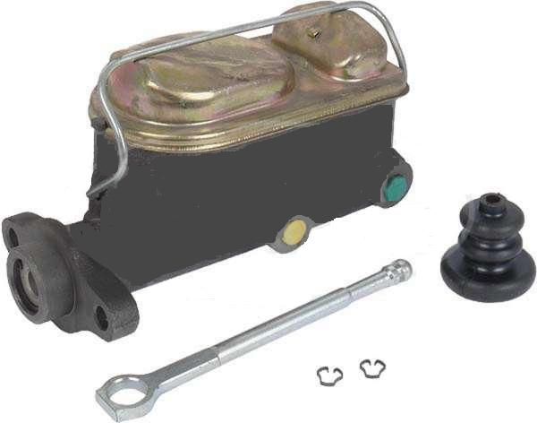

A manual brake master cylinder has a different pushrod than a power brake master cylinder. The manual brake master cylinder pushrod always stays attached to the master cylinder.
In other words: If you have a 1972 Torino with manual brakes you have to disconect the master cylinder pushrod from the brake pedal, to remove the master cylinder from the firewall.
