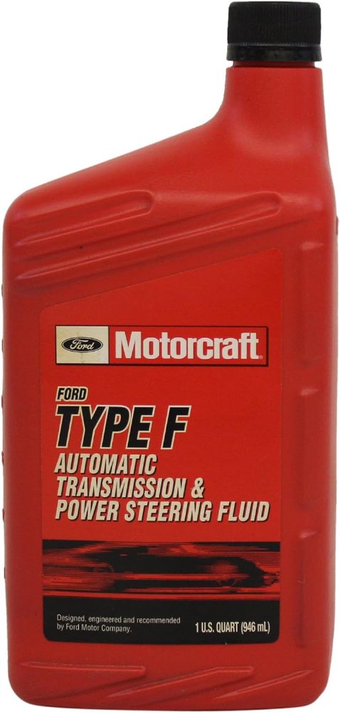

Type F from motorcraft has power steering fluid on the label, as that's what it's used for the majority of the time anymore. If you can't find type F, I'm pretty confident power steering fluid will work. At the end of the day it's a hydraulic system, so long as the viscosity is in the ballpark and the additives don't eat the seals and hoses, it should be fine.
