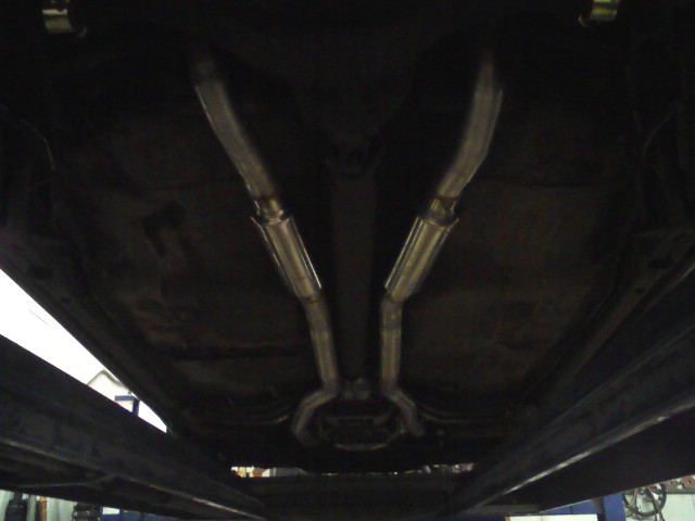

got my new stainless mufflers today! i decided i might as well just do all of the new exhaust system now (when i get the headers back) switching from 2" to 2 1/2" it should flow a lot better, and sound totally awesome Wink

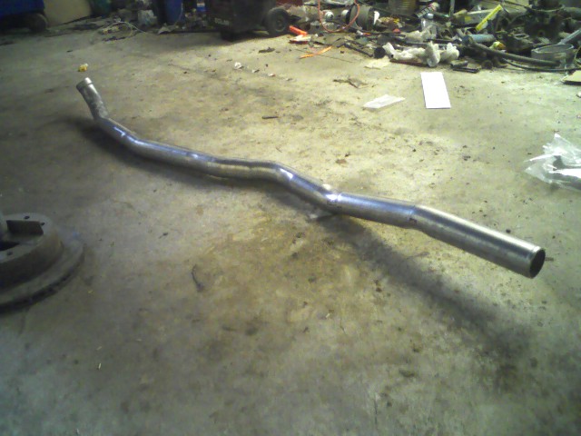

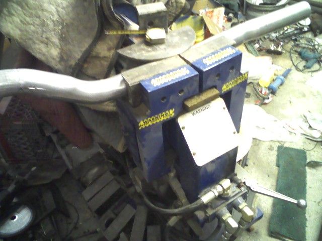

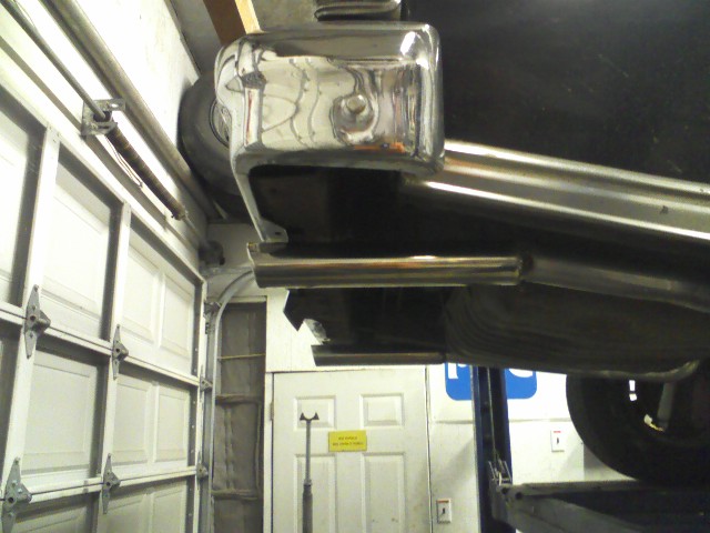

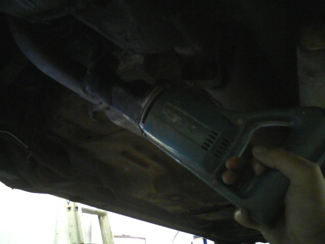

picked up (3) 2 1/2" 10' exhaust tubing saturday, got my 3"  polished stainless exhaust tips today, now all i need is my headers back from the ceramic coaters, then i can start bending and welding up my new exhaust system. so in the mean time i decided to woodgrain the right side dash panel, what a P. I. T. A.  that piece is to get off of the car!!! Angry but the end result came out great!

Posted By: californiajohnny
Date Posted: 13-January-2014 at 6:04PM
i joe'd my old exhaust off LOL
Date Posted: 13-January-2014 at 6:06PM
i started bending up new 2 1/2" exhaust pipe
Date Posted: 13-January-2014 at 6:10PM
drivers side head pipe done, still need to weld new stainless muffler onto it and bend tail pipe.
Date Posted: 14-January-2014 at 6:43PM
got the passengers side bent and welded new exhaust done
Date Posted: 14-January-2014 at 6:44PM
2 1/2 " exhaust with 3" stainless tipsWink
Date Posted: 14-January-2014 at 6:47PM
welding last tip, ran out of argon/co2 CensoredCensored, but i managed to get it tacked in place so i can hear what it sounds like!
Date Posted: 14-January-2014 at 6:52PM
OMG!!! she sounds SWEEEET!!! (kind of like a cross between glass packs and flowmasters) engine appears to be a lot more responsive, i can't wait to take 'er out on the road for a road test!!!!Thumbs Up
