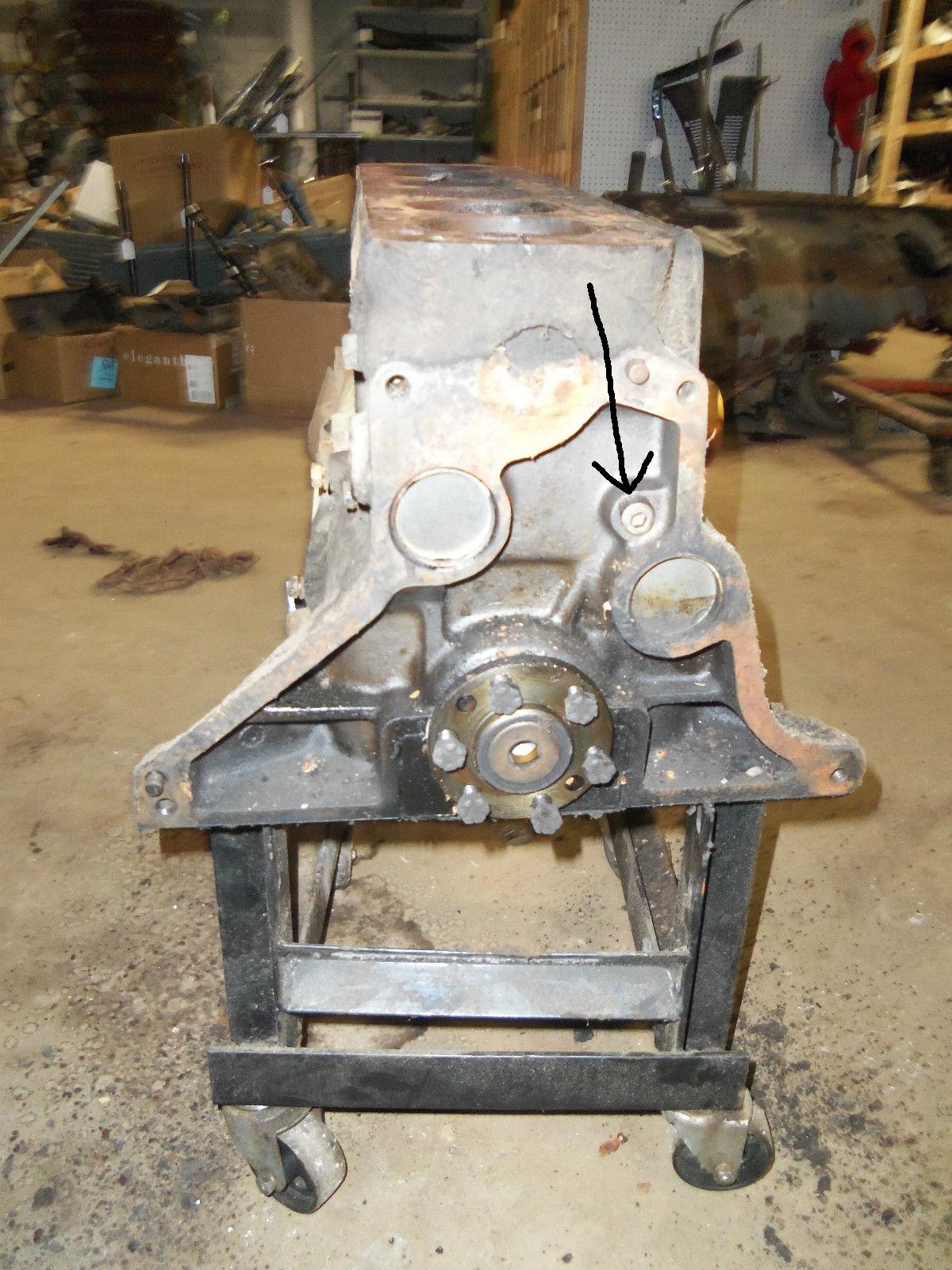

Posted By: dave302
Date Posted: 26-August-2014 at 7:32PM
The back/rear of this 1954 through 1964 ford inline six cylinder block has an NPT Type of oil gallery plug installed on it. Maybe this is missing on your engine?

Posted By: dave302
Date Posted: 26-August-2014 at 8:05PM
This is a picture of the front of the same 1954 through 1964 ford inline six cylinder engine block that i had posted five pictures above. I am posting this picture to show that the other picture of this engine (in the first/top picture above) is the rear/back of this same engine (not the front). Hopefully your rear oil gallery NPT Type of plug is not missing.
Posted By: dave302
Date Posted: 26-August-2014 at 10:02PM
In the worst case possibility, if your rear/back oil galley plug is missing, you can still install a new plug with the engine still in the vehicle. But the transmission will have to be seperated from the engine to install the rear plug.
