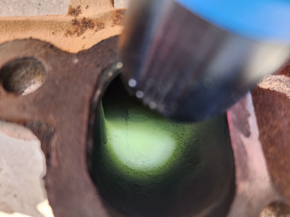

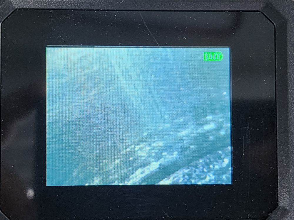

I verified TDC by rotating it until the pointer was at 0, then stuck a camera in the No.1 cylinder spark plug hole. It's either right on or extremely close.
The TDC is the one for #1 cylinder on its compression stroke. Put your finger over the hole as it approaches TDC, if it doesn't blow your finger out then it's on the exhaust stroke(the exhaust valve is open at that time).

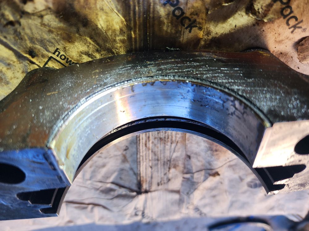

When I pulled the oil pan to change the rear main seal, I found the chunks of bearing foil from the thrust bearing in the pan. I swapped the thrust bearing out for a new one so I'd at least have some bearing material in hopes to keep the crank from rubbing the block. I had been worried that the damage was something I did, but I still had the oil filter that was on the car when I got it, so I cut it open and found bits of bearing in there. It definitely needs a new crank, but I drove it ~500 miles last October, and it used barely any oil, so it seems like the rings are good. But with the trashed crank, I didn't want to put in the time/money to replace all the bearings.

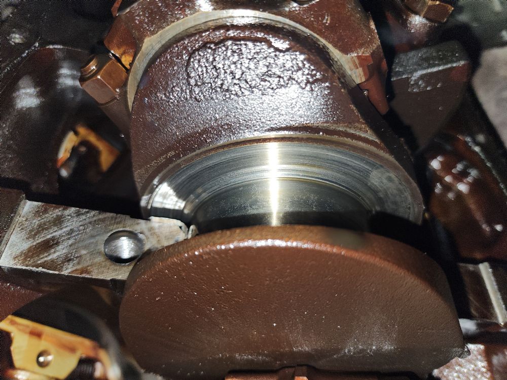

That's the thing. The crank has a groove worn into it that's as deep as the thrust bearing.

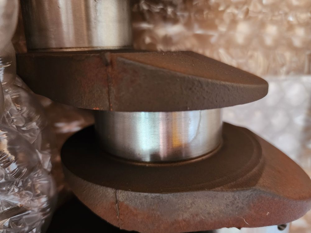

The crank I found for $250 is pictured wrapped in plastic and is marked as being ground 20 under for the mains and the rods, so it appears the machine work is done. The hope is to have the car running again by mid-May to drive 6 hours to a Fairlane Club show, and I'm concerned that if I get a short block for $2K, the lead time will be too long (plus I'd assume I'd want to have heads gone through, valve guides replaced, in addition to aftermarket valves, etc.). Where I live is rather isolated, so machine work isn't exactly convenient out here.

My rear main bearing is in the photo below. The main surface of the center bearing was a lot better, but the thrust surface was gone. I didn't remove the other three bearing caps to look at those. I only replaced the center bearing so I'd at least have some thrust surface. So I'm guessing the glitter in the oil is from this. The oil pump is new (I accidentally screwed up mounting the old one, so the drive shaft was pushing against it and it broke the pump neck, so I got a new Melling pump and shaft).

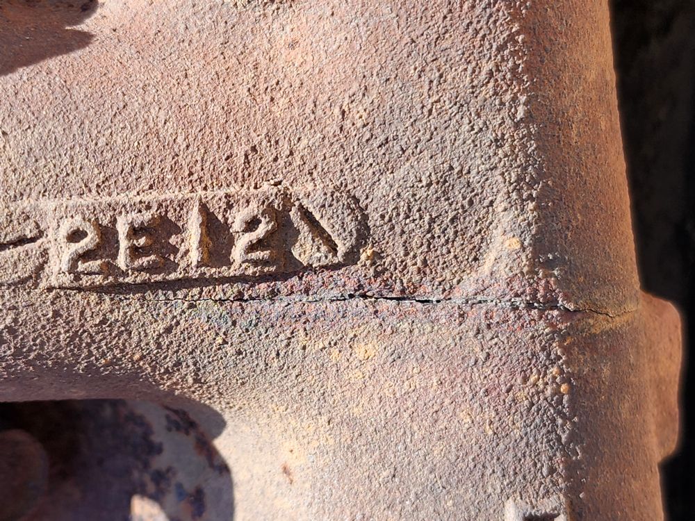

I'm thinking the block would need work because of this (also cylinder 3):

isn't your crank pretty much Stick A Fork In It Done, why hold off on a pretty good deal? they're not getting any easier to find by the day, even store bought. a little vertical scoring, doesn't look too bad. it might've been run a little on the hot side and the clearance tightened up, scored up a little. that alone isn't enough to pull it down but the crank kinda is. the scoring does get back to my berrybush hone minimum though, that'll clean up some / if not all. the best reason to do the water trickle trick IMO would be to make cleaning the pistons easier after you pull it down, if it can clean itself while it's together running all the better!

Got the crankshaft. It turns out an 80-year-old retired from his machine shop and the son is cataloging, organizing, and liquidating hundreds of cranks, heads, blocks, etc. He polished and mic'd the main and rod journals for me, and they're 30 under, which is fine because I can get bearings for that. $170 out the door.
Rock Auto actually has the Qualcast valves. The single-groove is stock for 1977-up 400s, or they have Qualcast multi-groove available as well. I'll just get the single-groove valves for a 1979 Bronco with 400.

can you post a pic or 5 of the thrust surface?
Posted By: Inkara1
Date Posted: 25-March-2024 at 12:28PM
On the new crank or the old one?
Posted By: 72FordGTS
Date Posted: 25-March-2024 at 11:55PM
Originally posted by Inkara1 Inkara1 wrote:
Are the threads in an aluminum intake strong enough that I can put a plate on the carb mount and lift the engine that way? Or do I need to find mounting points elsewhere to lift it? I don't have the lift points that I've seen on the exhaust manifold bolts on some other engines.
I used a plate on my aluminum intake to lift my engine to install the headers.  It worked fine.  When I pulled the engine and trans out, I used a leveler and use installed a bolt on the front an rear head to lift it out.  When I worked in a shop, we typically just used a couple of bolts in the heads to pull an engine.
Posted By: Rockatansky
Date Posted: 26-March-2024 at 12:30PM
the new one
Posted By: Inkara1
Date Posted: 27-March-2024 at 9:36AM
Thrust surface:
Date Posted: 30-March-2024 at 3:36AM
that's what i was afraid of, i might've passed on this crank, may be a core or an unfinished reman in progress?
IMO it needs to be seen by the nearest crank doctor for evaluation, that thrust surface looks like Joe chowdered on it with his sawzall.
i don't see how it's even measurable?

The teardown begins. I wonder if this crack in the passenger side exhaust manifold has something to do with my original noise complaint. There are a few other small cracks on both manifolds, but this is the one I can find that I can also see the back side of.
Would I be best trying to get new manifolds on eBay? Or could I get a pair of shorty headers and make them work with the current exhaust pipes?
Date Posted: 25-April-2024 at 3:18PM
The passenger side is the usual culprit for cracking and can cause exhaust noise like your original sound.  There won't be any shorty headers that will bolt on without some mods to the head pipes, at least not that I know of.  You could try to find used manifolds, but just hope you don't end up with another set with cracks.

I figured I'd need to cut the "trumpet horns" off the front ends of the exhaust pipes, and then clamp on the header collector flanges, but I'm hoping for a minimum beyond that at least for now. I was thinking headers since I need to swap anyway, so I might as well pick up a few horsepower. Shorty because I have a 351C-2V and a C6 transmission, and long-tube headers that fit that combo aren't readily available. I want to keep the current exhaust pipes because I got laid off from my job, which gives me more time to work on the car but limits cash for car stuff that's not really needed. Manifold is cracked, so that's a need, but pipes and mufflers are fine, so not a need.
I'd think about welding that one crack up, but then I'd worry that the other cracks would work their way through.
Checking eBay, there's not much. I do see a 1971 right-side manifold for $100, but not enough pictures to see if it's cracked, and shipping from Anchorage, Alaska, might be slow and expensive. There's a pair of 72-73 Mustang manifolds for $300 in Arizona, but shipping is $100 to my zip code, so at $400, I'm almost to a new pair of shorty headers at Summit for $480 plus tax with free shipping.
Posted By: Inkara1
Date Posted: 28-April-2024 at 6:59AM
Found a set of manifolds in great condition on eBay, so I bought them.
