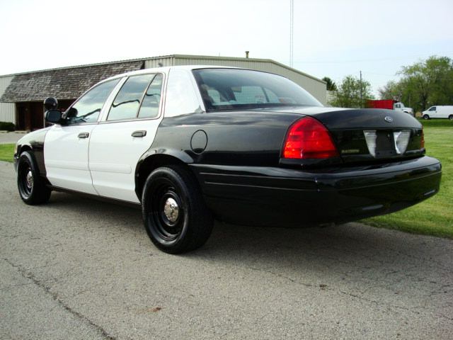

Posted By: Rockatansky
Date Posted: 16-July-2013 at 9:09AM
if you're willing to settle for 16's you can use the 2002 & earlier Ford cop wheels with the nut covers, they have the right offset. 2003 the offset changed to 'high positive' or whatever. here's my 2003 with 2002 wheels on it
