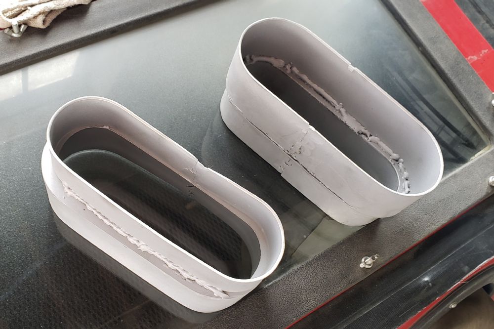

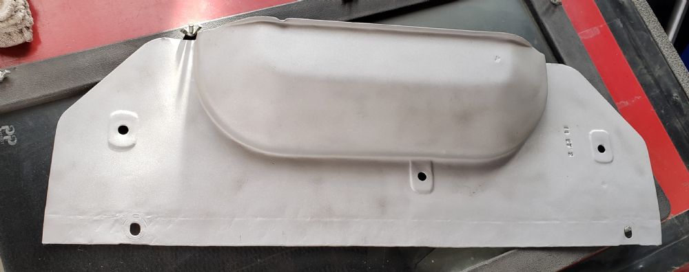

Another little project I worked on was to create a dash radio opening repair plate. While my dash in fully intact, I know there have been several guys who’s Torinos have had the dash hacked up to allow a modern DIN style radio to be installed. I drew it up on the computer then printed out and stapled it to a piece of cardboard (from a pizza box Wink) so I could cut it out and dry fit it to my dash to confirm it fit. I freehand trimmed it shape and dropped it onto my dash and it fit pretty well, so I’ll post the pattern for the repair plate onto the HOW-TO section for others to use as needed.
Sunday I went out to the garage to clean some stuff off the workbench and once I had most of the junk cleared away, I saw my Bernzomatic FirePoint torch kit on the shelf.

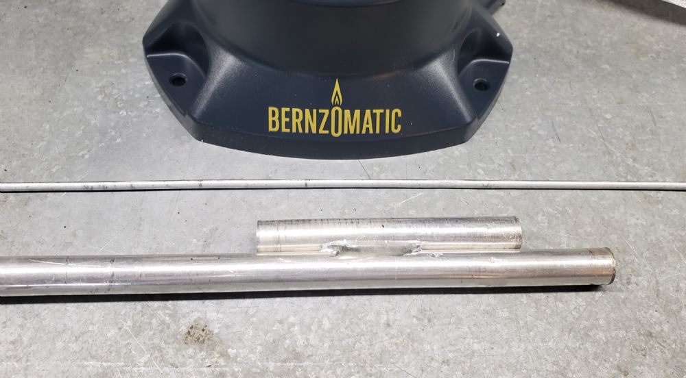

I bought this tourch and some alumiweld solder to play around with to see how I can attach my reshaped aluminum fuel tank burp tube to the OEM tube steel mounting bracket and then the burp tube assembly into my new fuel tank. Initial test was sticking a couple pieces of the aluminum tubing I used together and it did a fairly nice (and strong) job. Will also try attaching the tube to a thin piece of sheetmetal. Fingers crossed!
Well feels good to again be doing something project related and hope things begin to move forward again!!!

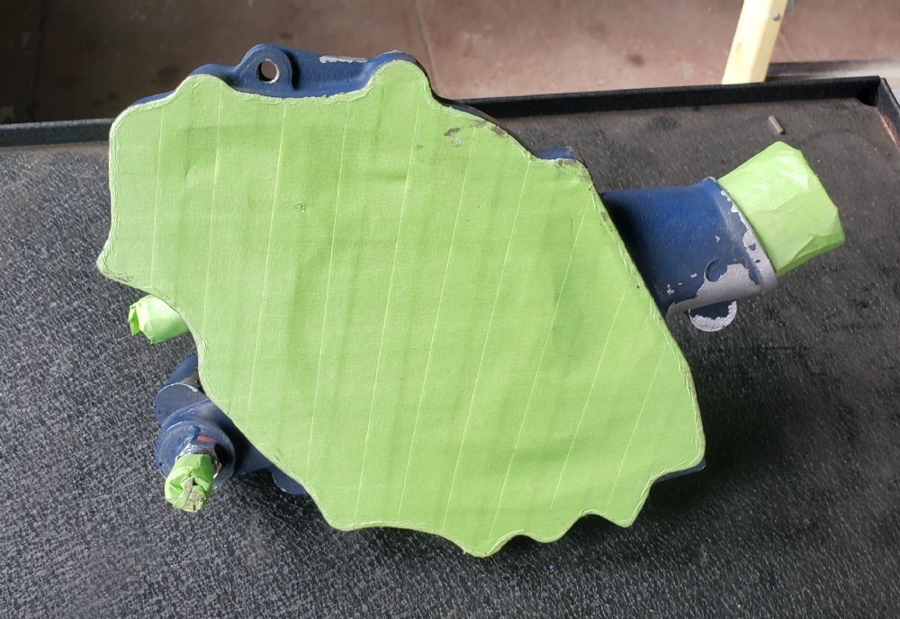

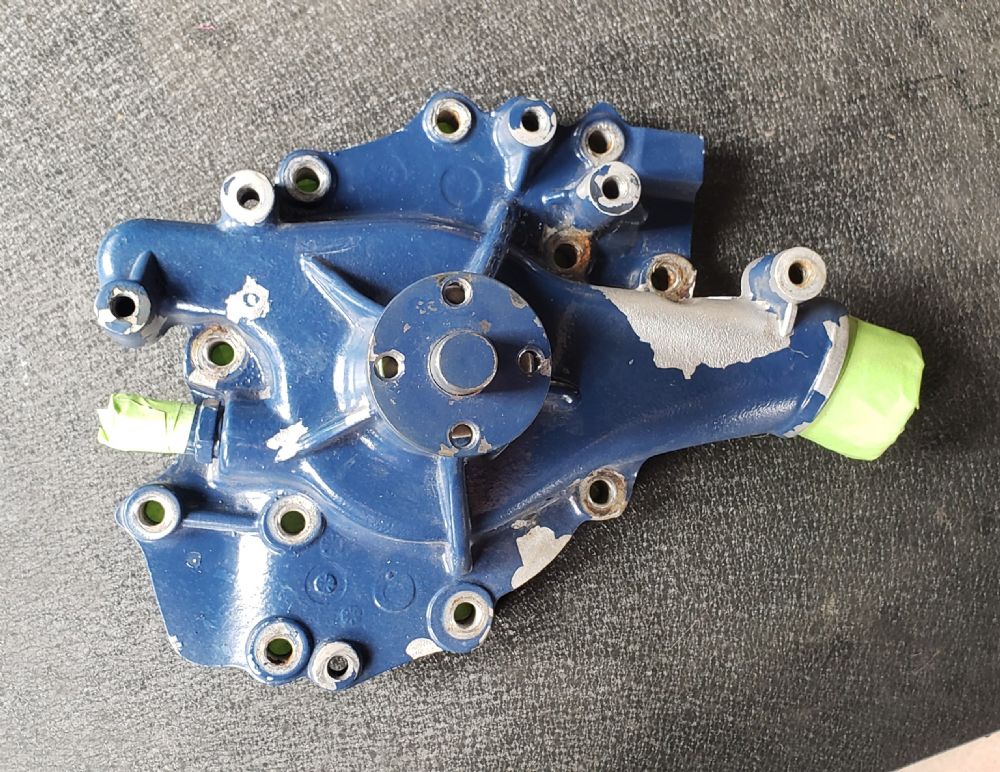

FINALLY, some progress to report on the Tomato... sort of! Thumbs Up
Removed the remaining hoses from the water pump and masked it off for blasting again. The Dupli-Color engine enamel didn't adhere correctly and is flaking off in spots, so I'll blast it and try again.
Originally I simply wiped it down with lacquer thinner, mounted it to the engine, shot the assembled engine with Dupli-Color engine primer before applying the Dupli-Color Ford Dark Blue. Did I miss a step someplace during the initial painting of the engine? Appreciate any tips on what I may have done wrong.... don't want to have to repaint the engine again down the road!!
I also started working on the door template for an LE style stripe. Looking at pictures of my original LE, it appears the upper edge of the stripe changes angle about the middle of the door.
A buddy of mine has two LEs he's working on that are still original paint and he's helping me to nail down the correct door shape on the factory stripes.
Next weekend I plan on blasting the water pump and any of the other engine and chassis brackets that need to be refreshed.

Post Options Post Options   Thanks (1) Thanks(1)   Quote Dan the ranchero man Quote  Post ReplyReply Direct Link To This Post Posted: 23-February-2025 at 9:25PM
Your water pump looks like an aluminum unit. While much lighter and easier to install I have learned first hand that certain paint products don't stick to it very well. Give this a try it worked for me on my 460 pump. Scuff the pump with a 120 grit scotch brite pad or sand paper then clean with brake cleaner. Then skip the primer and paint directly to the aluminum pump. Mine has lasted over 15 years and no peeling.

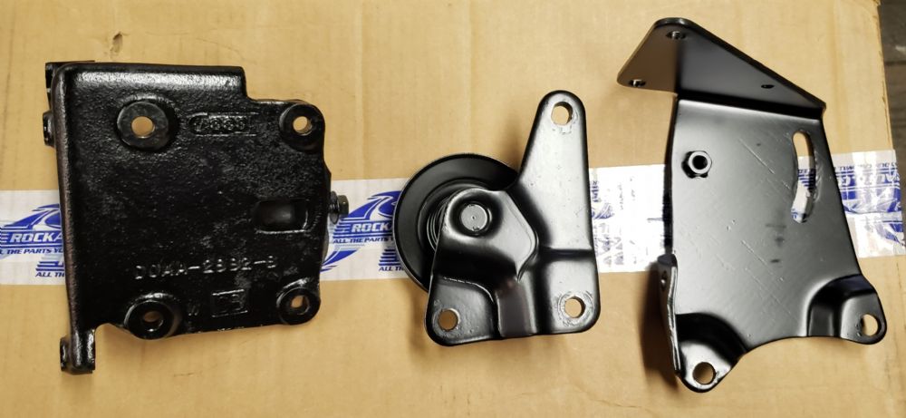

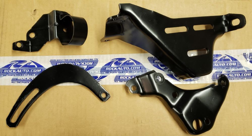

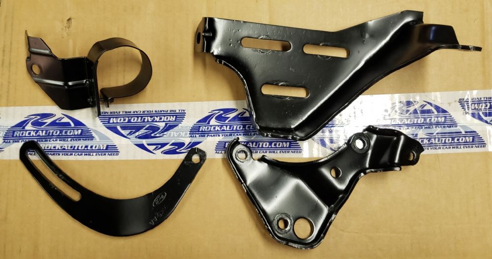

Well a bit more Torino progress this past weekend. First up was breaking down my recently acquired remote oil cooler adapter for blasting and detailing......
I then worked a bit more on the LE door stripe template using dimension provided by a member who owns 2 factory LE's with original paint...
Not a lot to show, but progress is progress and I will be doing a bunch of sandblasting this coming weekend!

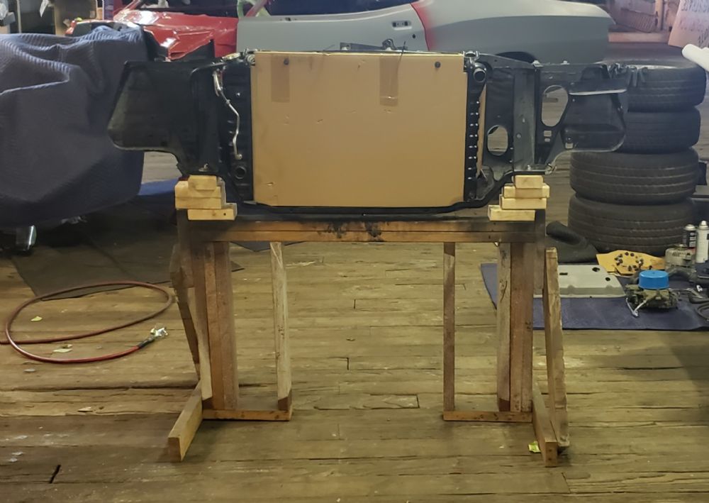

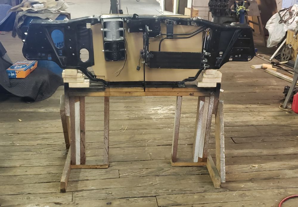

Post Options Post Options   Thanks (0) Thanks(0)   Quote TV 2M8O Quote  Post ReplyReply Direct Link To This Post Posted: 02-June-2025 at 10:14AM

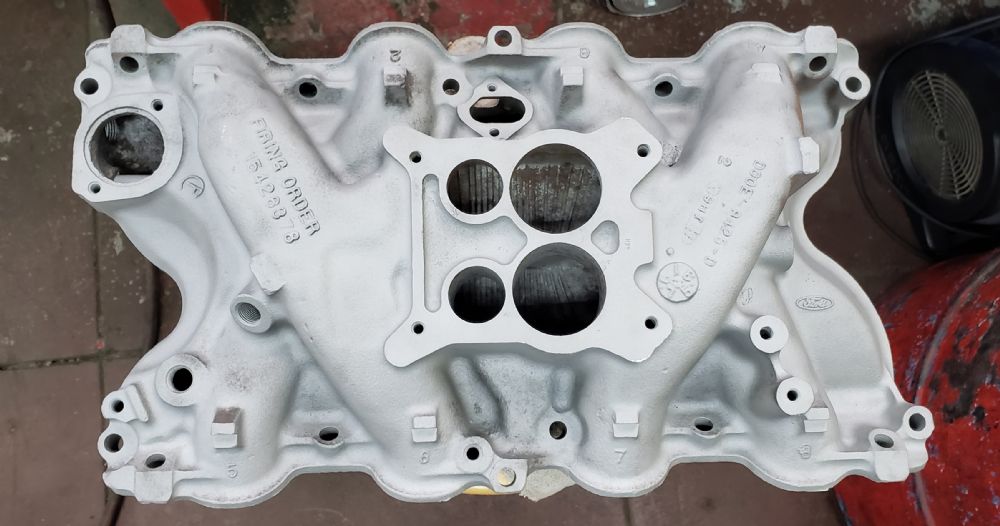

A wee bit of progress the past couple weekends... got the core support lagged down and the stand turned to allow easy access to either side (forgot to take a picture), got the Fairlane 460 "Medusa style" headers sorted and marked...
and got the Torino 460 valve covers sandblasted.

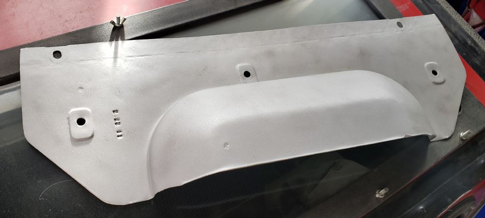

This weekend, (here's the core support mounted to my chassis stand that I forgot to take a picture of last weekend)...
and started breaking it down to install the AC condenser/dryer to confirm everything will fit together like it should.
Got the condenser assembly set out but then spent the rest of the afternoon looking for the friggen brackets! Angry Have run across them countless times over the last few weeks and now when I'm ready for them, they've become the needle in the haystack!!
Always something any more.... Ouch
Edited by TV 2M8O - 02-June-2025 at 10:19AM
Post Options Post Options   Thanks (0) Thanks(0)   Quote 72 RS 351 Quote  Post ReplyReply Direct Link To This Post Posted: 03-June-2025 at 2:44AM
Hi Joe, those aren't horns in the 2nd picture are they? Please mount them out of the path of airflow to the radiator.
