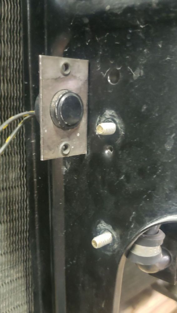

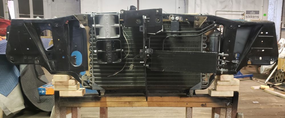

![]() I've not made very much progress on the Tomato this summer due to physical limitations, extreme temperatures at the dealership, other pressing commitments and trying to locate hardware that I once had to mount parts that have now gone missing from the car being in two unrelated shops.
![]() A fellow Torinoite sent me a set of AC condenser mounting brackets (I have since found mine!) to use in mocking up the core support assembly and that's when I discovered the missing hardware to mount the headlight bucket support parts. Guess I'll spend a few hours going thru the MPC to cull the hardware component numbers and then see what AMK offers that is close to what Ford used during her assembly. ![]() sh*t like this is what really infuriates me about turning my project over to others to do the work I'm unable to perform because they aren't as anal as I am about using the correct bits during reassembly! Anyway, with cooler temps at hand, hope I can get in there and kick ass on getting her cleaned up and ready for another bout of BODYSHOP ROULETTE! Edited by TV 2M8O - 07-September-2025 at 4:05AM |

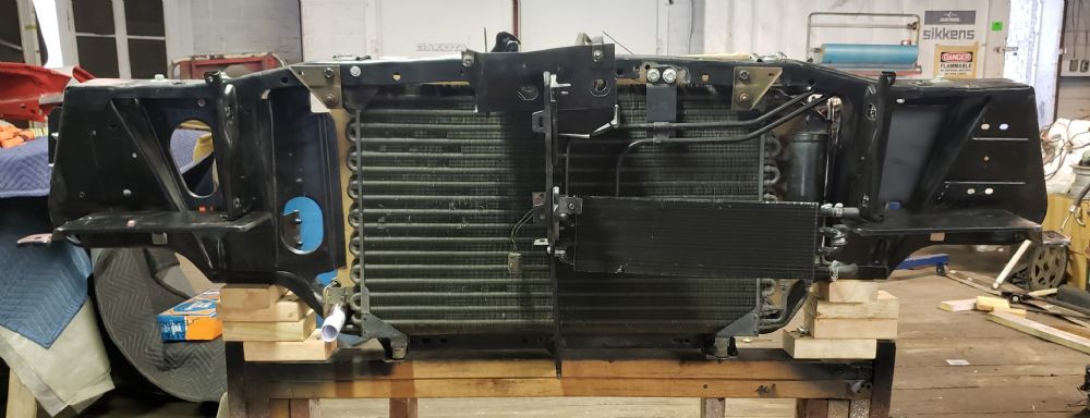

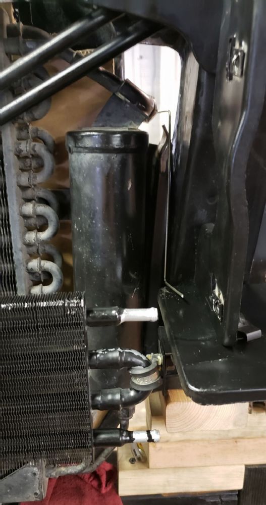

Posted: 21-September-2025 at 5:08AM |

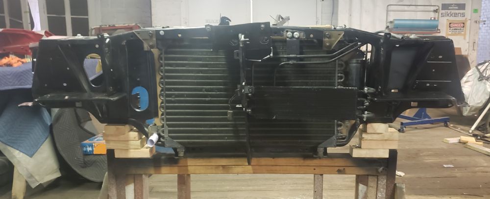

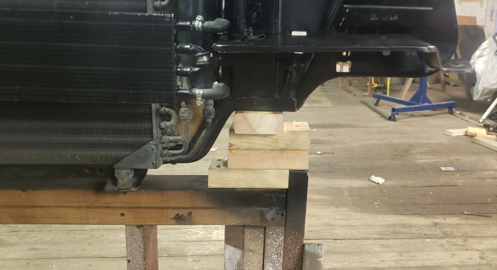

Another somewhat productive day on the Tomato front Saturday. Got all the core support brackets squared up and level and then started looking at areas the need attention.
![]() Noticed the transmission cooler is still not sitting level so I'll slot the mounting holes in the hood latch brace to allow me some adjustment to get it align properly. ![]() Also did some rough measurements and I think I might be able to mount the Dynamax sirens below the headlight bucket lower supports. Waiting on a couple buddies to send me dimensions between the frame rail and the underside of the headlight support to make sure they'll fit before starting down that rabbit hole!!! ![]() ![]() Next area needing attention is the transmission cooler hard line run up the side of the radiator. Now that I have the air condenser condenser mounted, I see I'll need to rebend them to fit tighter together and secure to the core support to clear the condenser. I'll also need to modify the core support opening for the hard line to go thru to insure nothing rubbing together that could cause an issue down the road. ![]() ![]() I also found that the upper line of the ac condenser was bent slightly causing it to rub against the radiator. Must have gotten bent in shipping so I'll straighten that out like it need to be. ![]() ![]() And before I left, I put the first coat of Ford Dark Corporate Blue on the water pump. I'll second coat it next weekend and maybe shoot some other engine part that need the blue reapplied. ![]() Slowly learning how to do things with my current disabilities but still a bit frustratingg trying to stand still to take a picture or spray paint a component, but I'm gonna finish this bitch before I die!!

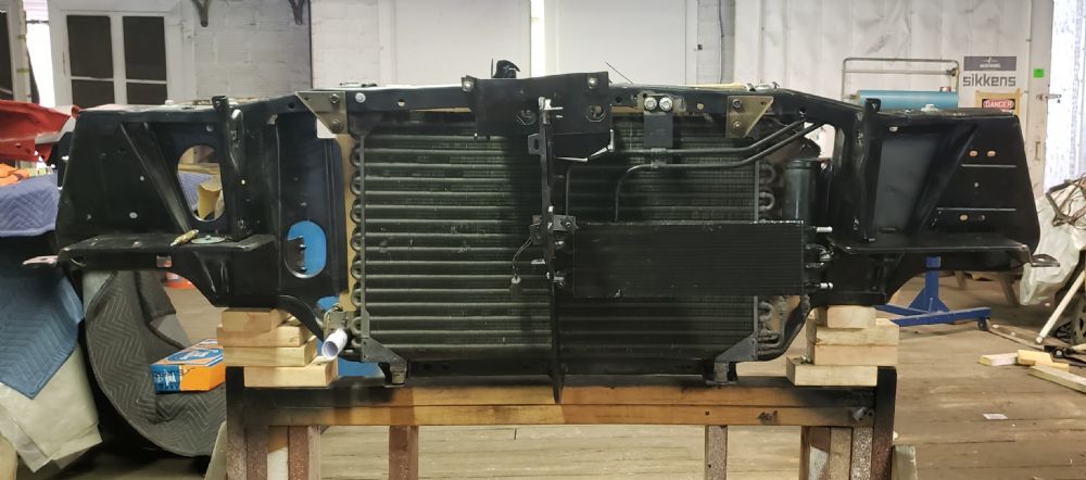

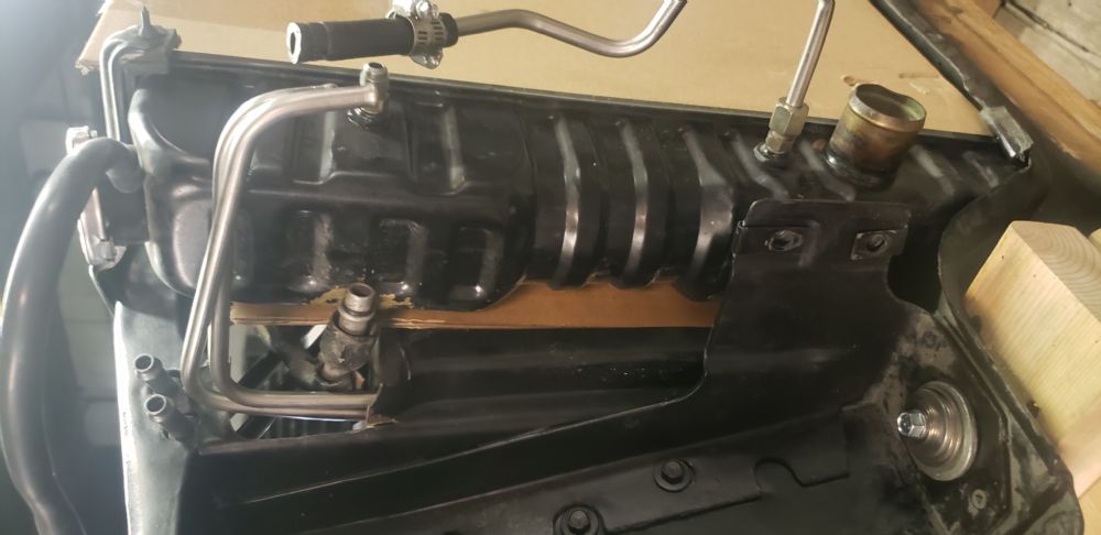

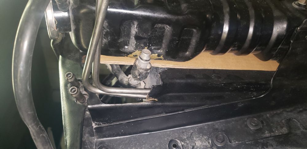

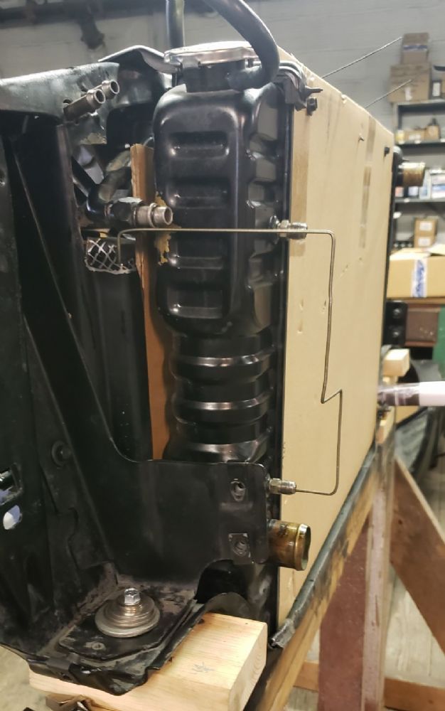

Posted: 16-October-2025 at 7:25AM |

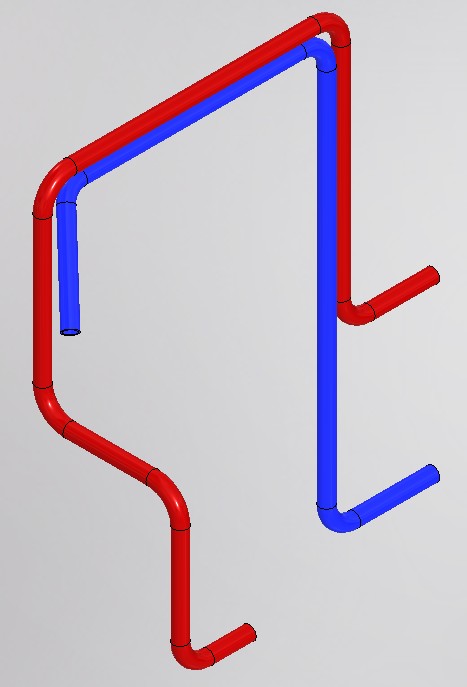

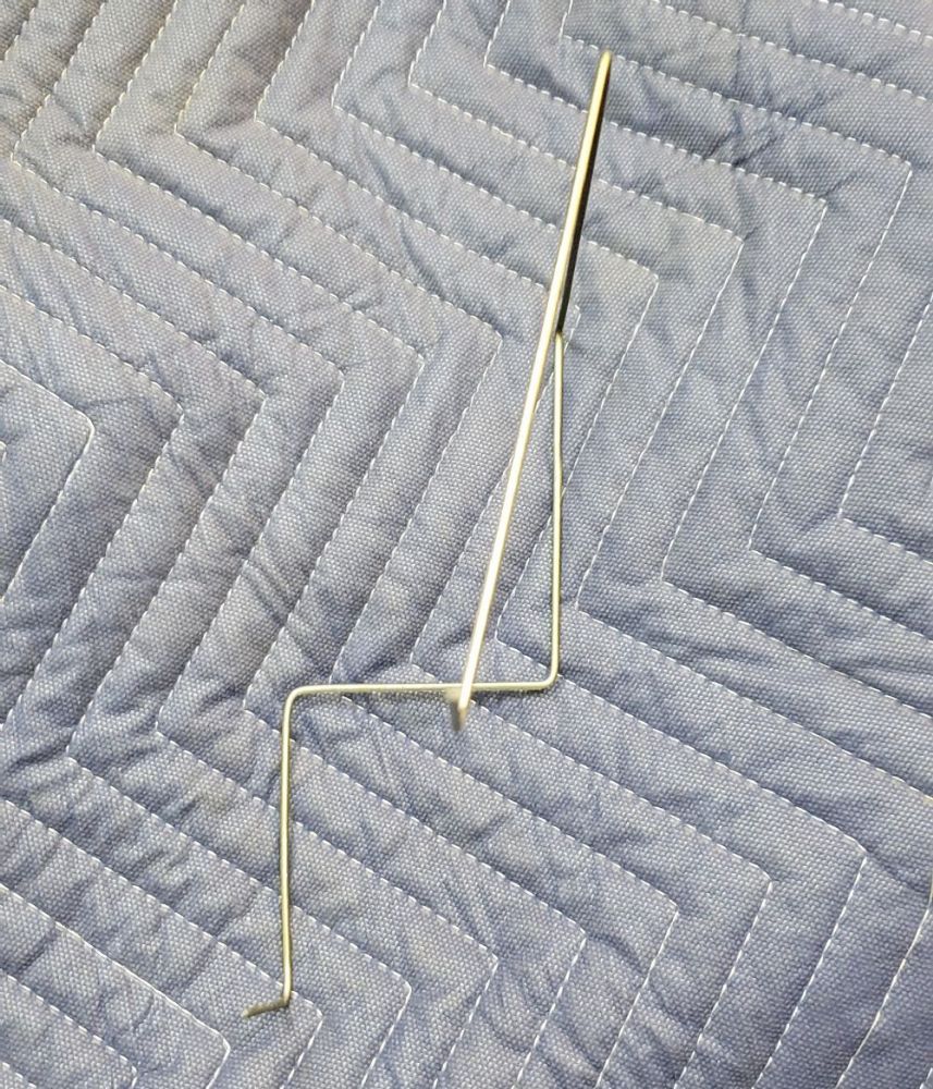

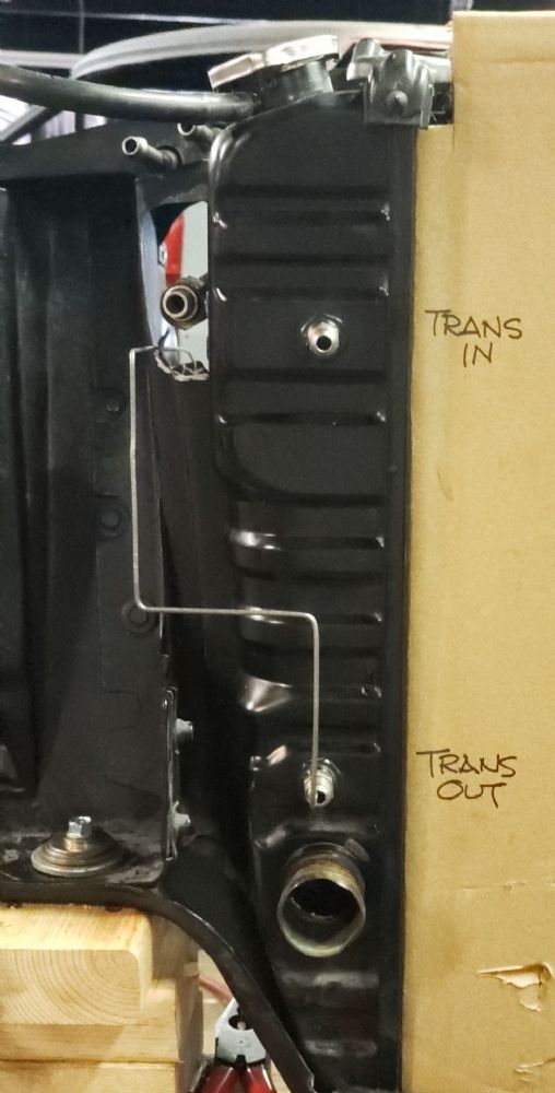

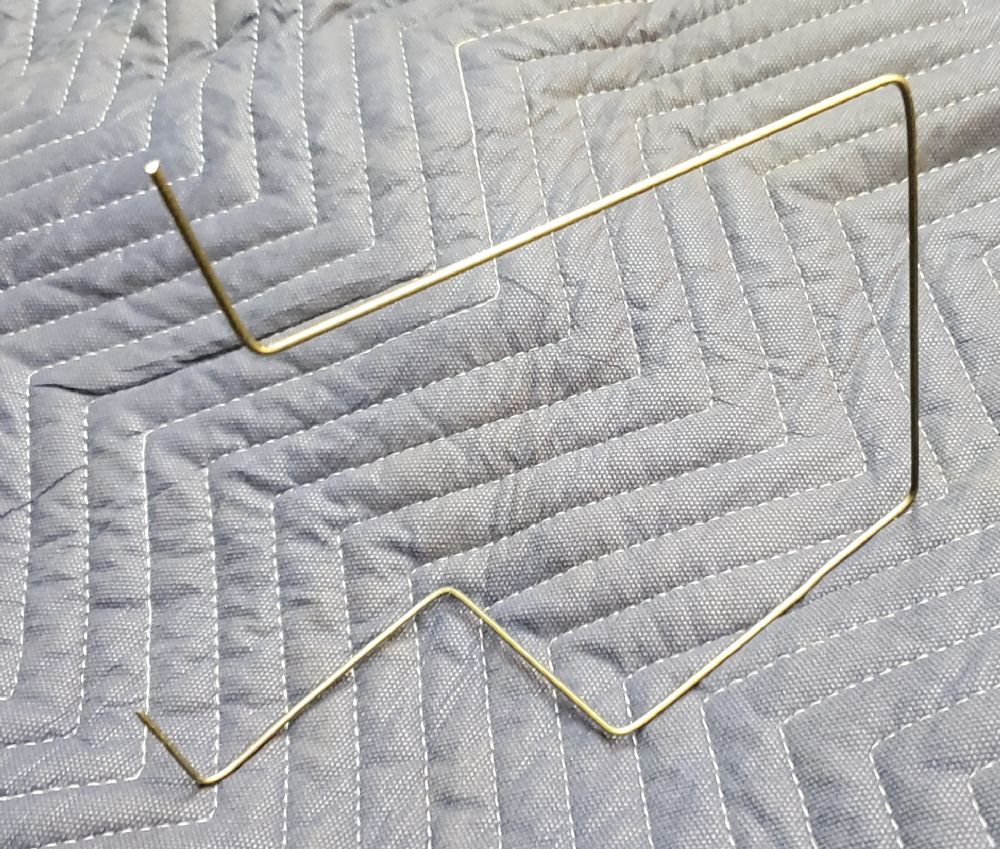

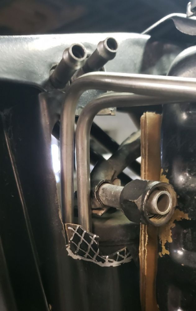

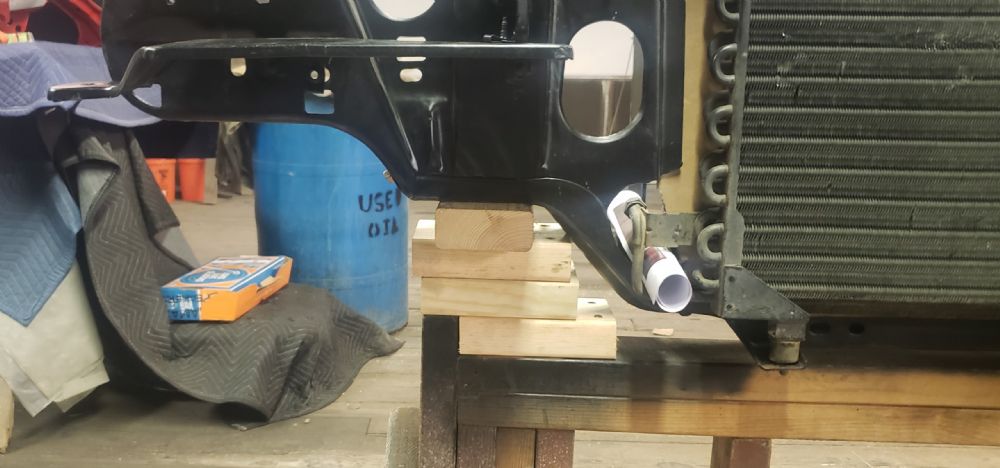

Well been a couple weeks since I last posted, but I did make
some progress the past few weekends. Got the AC condenser line straightened out…

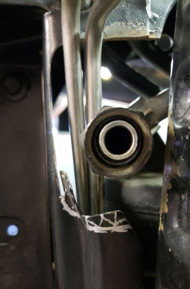

and marked the core support opening to trim a bit for the transmission auxiliary cooler hard lines to pass thru cleanly.

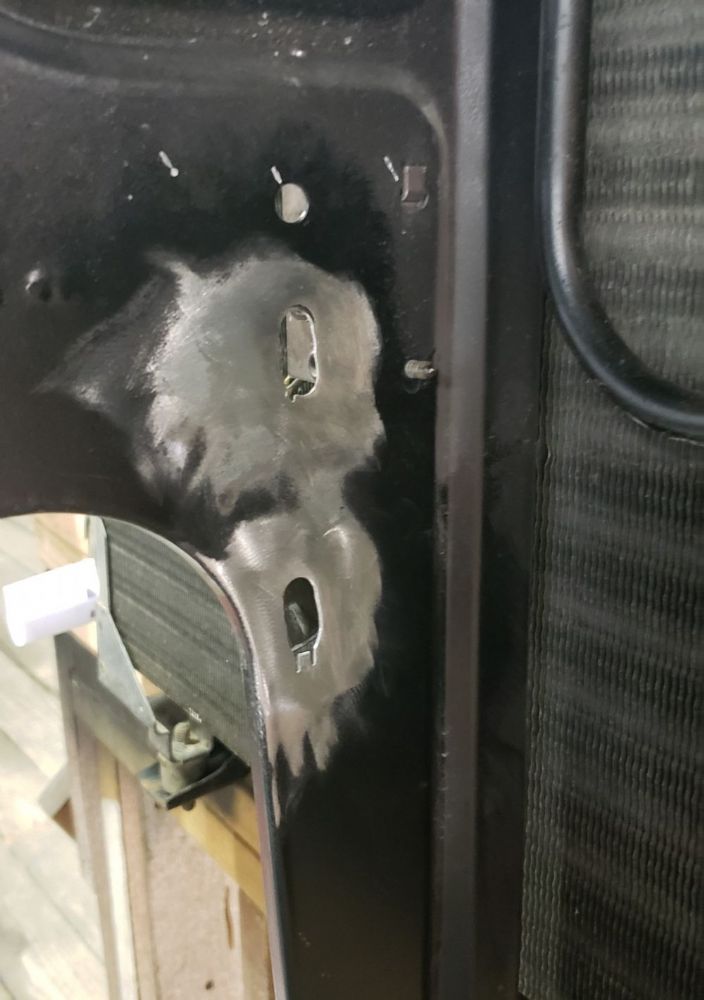

Next up was to slot the mounting holes on the latch brace to mount the transmission auxiliary cooler…
and then remounted the cooler level between the latch brace and headlight bucket brace.

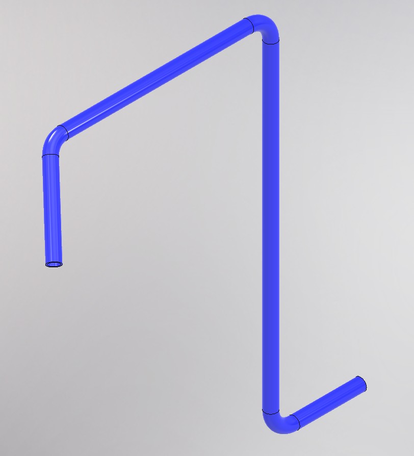

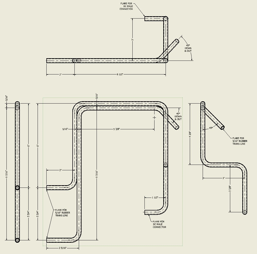

Now that the cooler was positioned correctly, I turned my attention to designing the transmission auxiliary cooler hard lines. I straightened a coat hanger to use as my bending pattern and started forming the hanger to mimic the centerline of the hard line runs.
I was able to use one template to layout the two lines.
The cooler supply line (red) will be hard mounted to the radiator cooler outlet port…
and the cooler return line (blue) will hard mount to the transmission return line.
I need to find a couple dual 5/16” R clips to keep the two
lines together as they run from the cooler up the core support to the opening
to the engine side of the support.
Once the 5/16 stainless tubes are formed, I’ll add the fittings and flares to the lines for attaching to the other components. Next on the agenda is to start breaking the core support
back down and doing another final cleaning/painting of the various pieces
involved with the core support assembly. |

Posted: 16-October-2025 at 8:43AM |

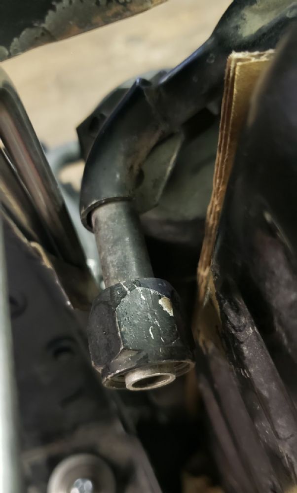

That's good progress, I do love the detail. But, don't make any transmission lines with 5/16" tubing. Ford upgraded all trans lines in the 80's to the 3/8" size, to improve fluid flow, for better cooling. Ford also upgraded the trans lines again almost 30 years later, the six and ten speeds all use 1/2" lines now. The least anyone can do is to use 3/8" lines, it's always better for ATF cooling than the old smaller 5/16" size. In 1993 I installed pre-made steel 3/8" lines from a local auto parts store into my 86 Crown Vic. The stock police oil cooler made a great trans cooler when I rebuilt the engine and trans. I used those easy to get lines with flared fittings, to connect everything without any rubber hose. I put an o-ring into each connection to prevent any leaks. That's standard procedure now with most OEM flared fittings/connections. I want to use the nice flexible braided lines from Jeg's etc, for my newer projects, that stuff is high but it's easier to route than steel lines.
73 Ranchero "Sport 72 front end", floor shift/console, planning EFI 7000 rpm 351 stroker 73 Ranchero GT 351C-4V &4R70W for sale later. 92 Lincoln Mark VII SE GTC, OBDII 347/4R70W |

Posted: 17-October-2025 at 1:18AM |
Don, Since I've already installed a new IN LINE TUBE 5/16" stainless line kit from the trans to the radiator (with the auxiliary cooler line) it's too late to increase the tube size, but should I ever replace these lines (or on my other Ford projects) in the future, I will definitely upgrade to the larger diameter tubes! Thanks for the info......
![]() TV 2M8O OUT JOE 1976 Gran Torino S&H season 2-4 Clone Project Blog: http://tv2m8o.blogspot.com/ |

Posted: 17-October-2025 at 7:16AM |
Good good, I learned that when I rebuilt my CV, the fitting on the transmission came in two sizes back then(1993). I asked my Ford parts guy and he told me the story, which was before I ordered the parts. So all that's needed is to change the flare fitting adapter on the trans, and the bigger lines will then work.

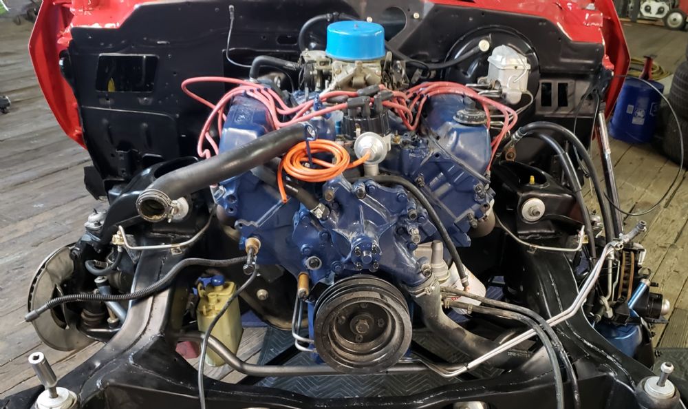

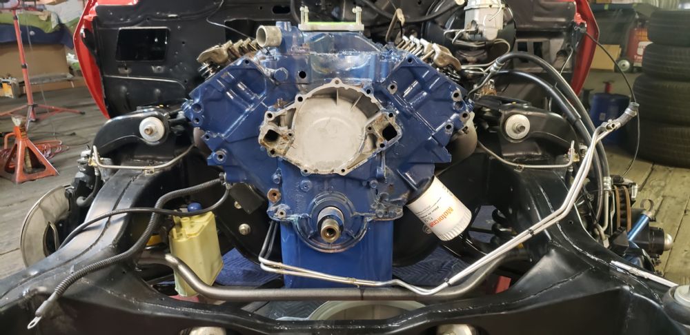

Posted: 11-November-2025 at 3:38AM |
Well Saturday was a disheartening day on the Torino front as
I partially broke down the 460 to once again clean it up and repaint it from
sitting in the un-climate controlled garage of the half-assed
"bodyman" for 2 years covered in sanding dust and looking like a 20 year old barn find once I got her
back.
I guess one bright side to pulling everything off the engine and removing the front sheetmetal is once again being able to access the firewall, suspension, chassis and transmission lines to address a few things I noticed weren't quite up to snuff. FUN FUN FUN |

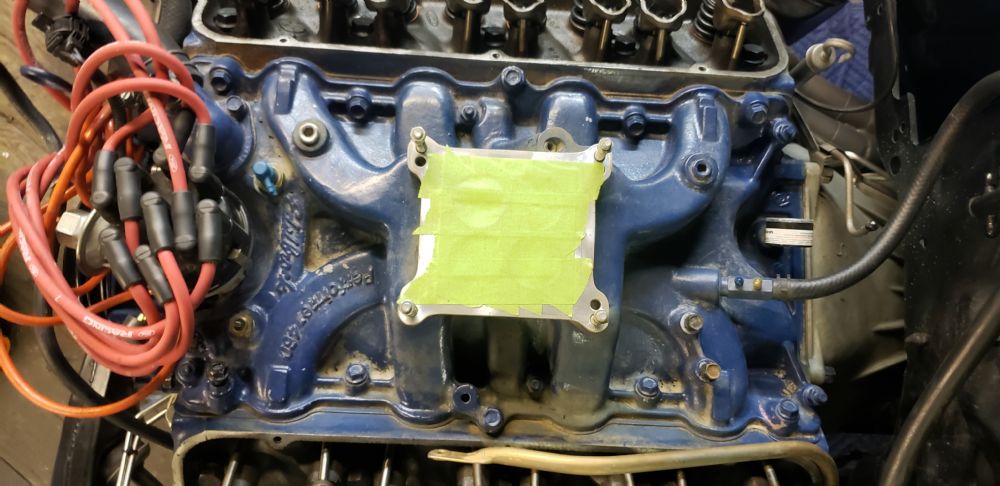

Posted: 15-February-2026 at 1:29AM |

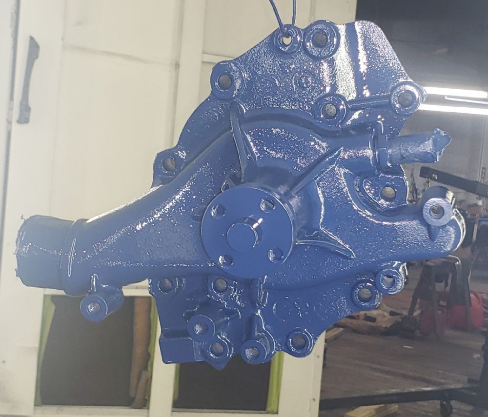

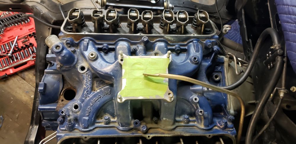

Well I'm still alive and slowly plugging away on the ole girl... survived the recent winter storms and finally got over to the dealership to do a little something on the Tomato.
Finished removing a snapped off drive screw that secures the baffle to the underside of the Cobra Jet intake manifold (oops, didn't take an after pic!) .... ![]() With the drive screw drilled out, I flipped the manifold over and set the QuadraJet into place to see how things lined up and what bits and pieces I still need to source to mate the carb to my engine. The QJ I scored was for an automatic, non-ac car but mine will have air so I need to find the correct bracket and throttle position solenoid to install on the carb. ![]() ![]() ![]() The QJ also uses a divorced choke assembly on the 429CJ's.... ![]() so I'll also need to find the choke stove tube assembly, the pull down divorced choke assembly and the stove cover gasket. I looked on line prior to going over to play and found no one offers the correct profile gasket at a reasonable price ($18-$32 for this little piece )....![]() so I just made a template and will make my own. ![]() My google search also turned up NO NOS choke tube nor divorced choke assemblies so I guess I'll also be making/adapting something to fill these voids. I'll be posting a second thread under PARTS WANTED with a couple sketches the parts in question. Appreciate any and all leads to the needed ball fulcrum rocket arm parts as well as the Ford Rochester QuadraJet bits!! Also a recommendation and an informative QuadraJet manual?? ![]() Thanks guys
![]() Edited by TV 2M8O - 15-February-2026 at 1:39AM |

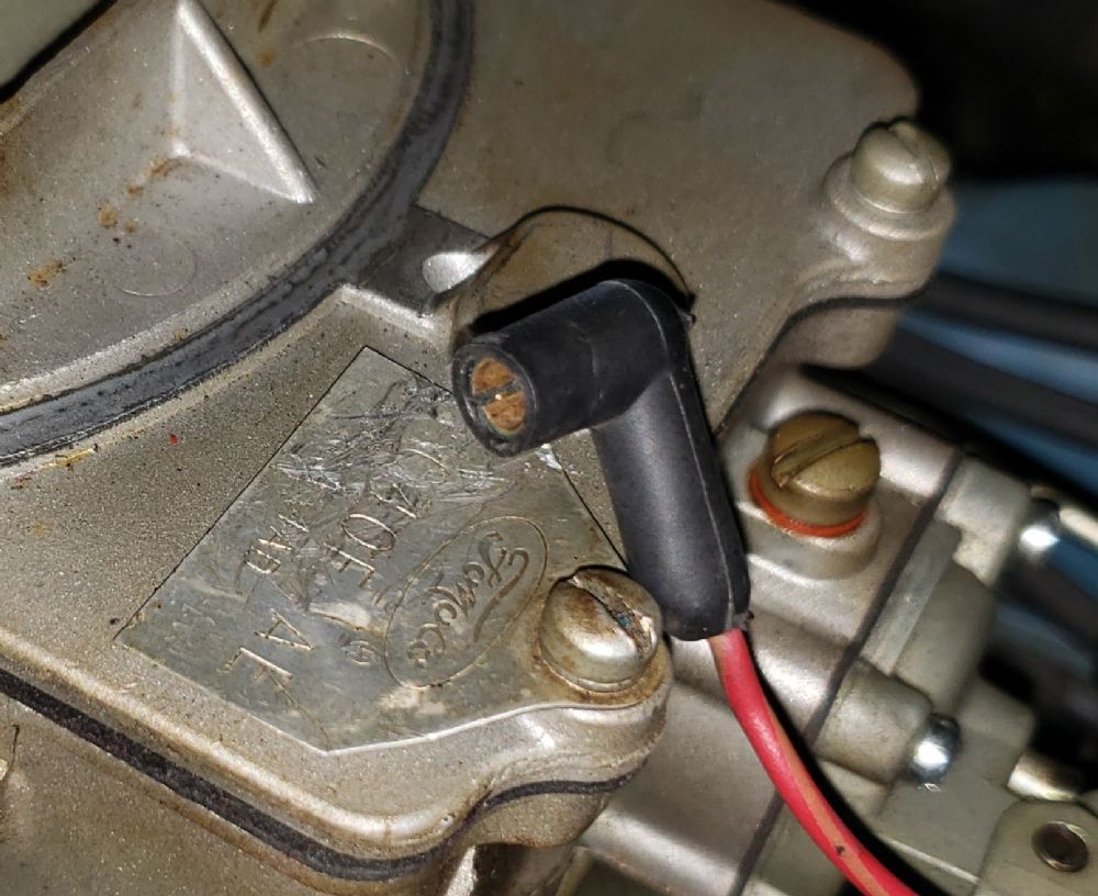

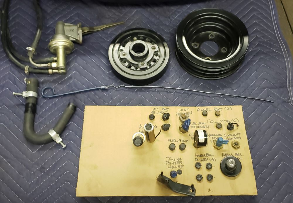

No pictures taken this weekend but did start putting the engine back together. Since I'm going to have my original engine to build into a "460CJ" I can clean up and detail the engine that's in her now once I pull it out and install the new one.
I've also decided to go with an electric choke (can still buy them new) since I'll have a 12V source close for the throttle stop solenoid and no pieces for the divorced choke mechanism can be found. Once I have the engine reassembled, I'll tackle fabricating the auxiliary transmission cooler hard lines then blow the core support apart to reclean and detail everything again before putting it all back together.Should be pretty good at all this once I (ever???) get her done.
