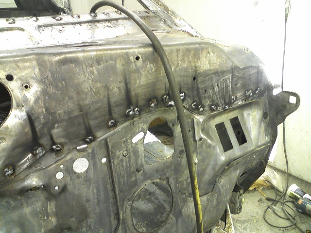

Post Options Post Options   Thanks (0) Thanks(0)   Quote Rockatansky Quote  Post ReplyReply Direct Link To This Post Posted: 21-November-2021 at 11:51AM
my 1972 firewall with the manual master adapter in place
Compton's 1973
but mind you the 1972 and an early 1973 build may be the same!
who's got a pic of a 1974+ ?

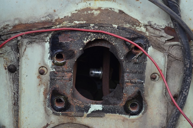

Post Options Post Options   Thanks (0) Thanks(0)   Quote californiajohnny Quote  Post ReplyReply Direct Link To This Post Posted: 21-November-2021 at 3:26PM
74...
Post Options Post Options   Thanks (0) Thanks(0)   Quote Rockatansky Quote  Post ReplyReply Direct Link To This Post Posted: 21-November-2021 at 3:34PM
looks different than both my pics, swapping the later booster should be no problem though
Post Options Post Options   Thanks (0) Thanks(0)   Quote californiajohnny Quote  Post ReplyReply Direct Link To This Post Posted: 21-November-2021 at 3:44PM
i think it the same may look different due to the pic angles ...
 i had to do some diggin for the pic from my build way back... surprised it wasnt a polaroid picLOL

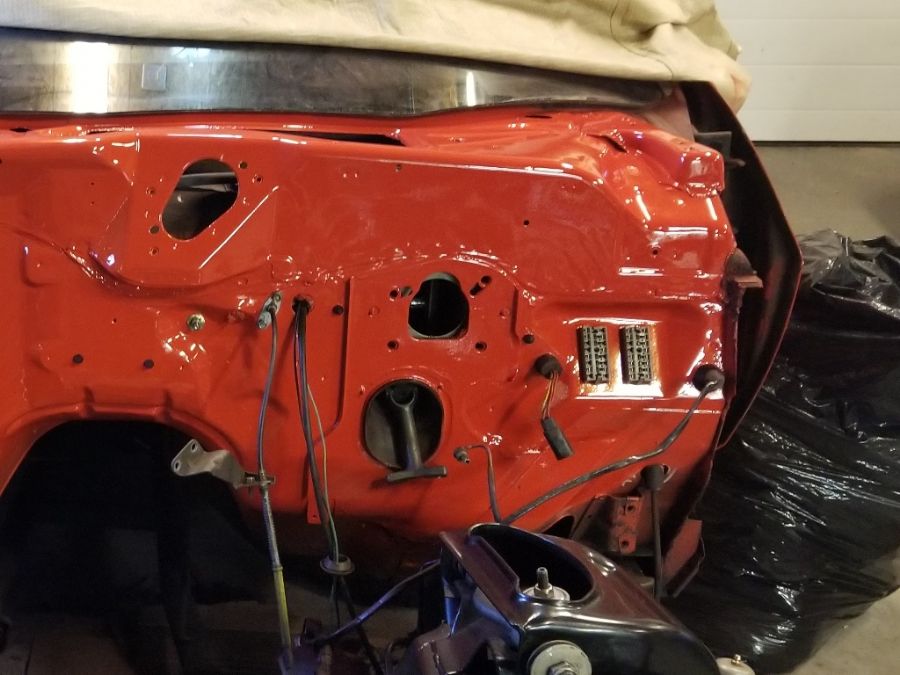

I agree that there should be no issue swapping a later booster, but it might require some minor mods if the one stud is in a different spot.  Why would Ford change the stud positions?
Here is my '72:

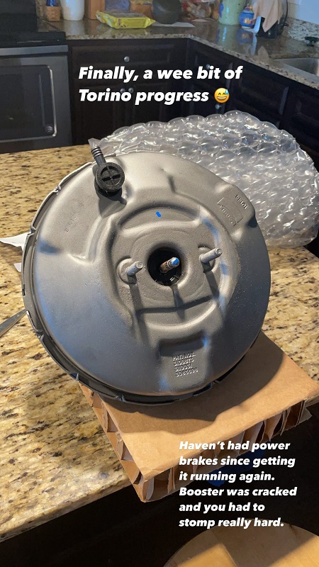

Post Options Post Options   Thanks (0) Thanks(0)   Quote Inkara1 Quote  Post ReplyReply Direct Link To This Post Posted: 10-March-2026 at 2:28PM
WTF?
I just got an email from Matthew Sweeting via stamps dot com informing me that my package is shipped. I was confused for a second -- I recently ordered a sticker for my water bottle, and thought the name might be a coincidence, but no. The reply-to address is powerbrakematt at yahoo dot com.
This would be a lead time of MORE THAN FOUR YEARS. I had given up, decided the cost of litigation and value of my time was more than the $849, bitched about it to whoever I could, and then moved on with my life. I've driven the car all over the state with the rebuilt vacuum booster.
So assuming a complete system actually shows up... what do I do? I can't imagine sending it back for a refund is realistic. It'd probably be another four years. Do I sell it? (I actually ship things I sell!) Do I install it?

Post Options Post Options   Thanks (0) Thanks(0)   Quote Inkara1 Quote  Post ReplyReply Direct Link To This Post Posted: 13-March-2026 at 11:08AM
Package came today!
It's just the hoses and fittings. LOL. Included sales receipt (that shows the order date of 12/13/2021) has a checkmark next to the "4 Line Rubber Hose Set" for $265. Still awaiting the booster itself that's $475. In fact, I bet I could find the hoses other places, while the booster is what I'd really needed them specifically for. Maybe the booster will come in 2030?
