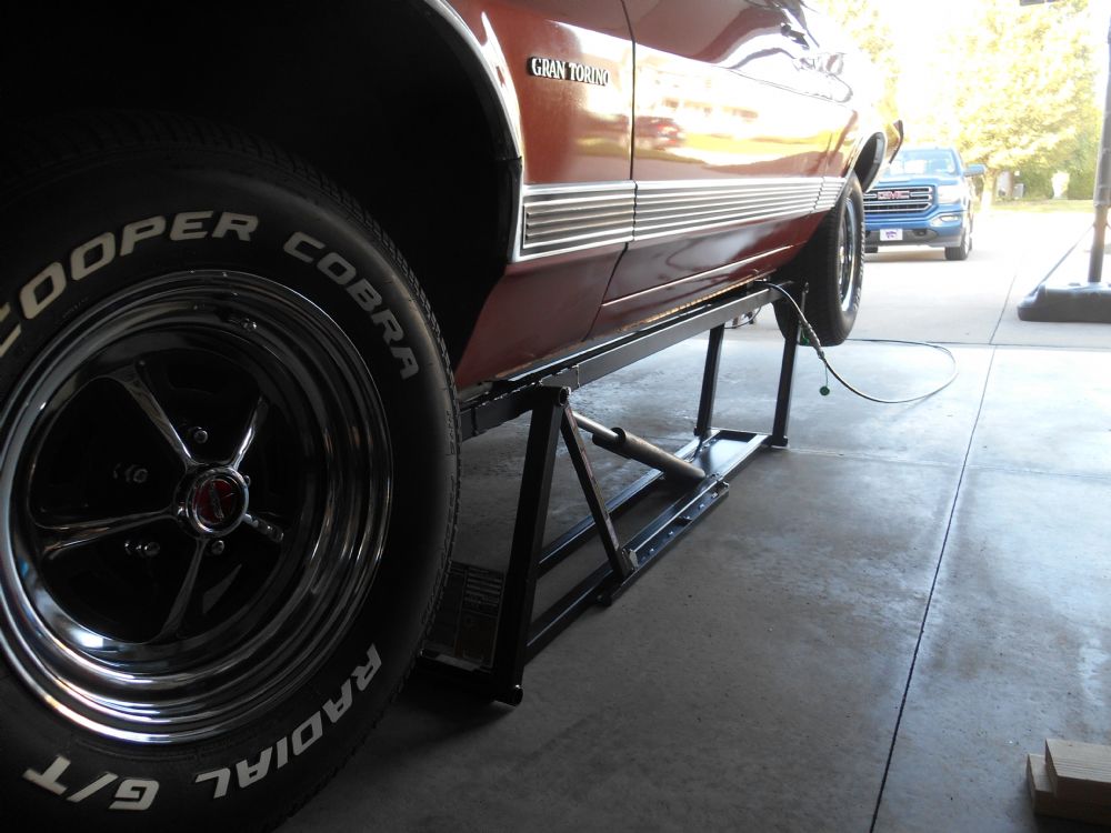

I recently purchased a Quick Jack car lift and wanted to share my experience.
Supplier:  Quick Jack (part of Bendpak, known for industrial lifts)
Website:  https://www.quickjack.com
Overall, I have been really pleased with the purchase and it has worked great for me.
I purchased the unit to get under the vehicle easier so I can do routine maintenance and do restoration items.  I was also looking for something I could store in my garage easily yet provide the high level of safety when working under the vehicle.
  • Ease of use is really good - simple 1 button operation.
  • Quick - lifts our vehicles in seconds.
  • High quality metal (Steel) for the lifts as well as the motor.
  • Leverages hydraulics to lift the vehicle.
  • The unit comes with lifting blocks that you put in the slots so there is no metal-on-metal contact.
  • Quick Jack offers adapters for trucks - so I will be able to leverage with my GMC Sierra.
  • Units have several safety features and locking mechanisms.
The units do cost a bit and took a little bit of time to setup, but for the quality and the safety aspect I think they are worth the investment.  They do offer sales several times during the year.
a.  Lifts are made of steel.  Very durable.
b.  Motor.  The motor that lifts the jacks is sturdy and leverages hydraulics to lift the vehicle.
c.  1 button control - up & down.  Simple but effective design to lift the vehicle.
d.  Quick connect - no leak fittings.  The fittings provide quick connect / disconnect, makes it easy to store the actual lifts/jacks separately from the motor.
e.  Lifting our Torinos.  I have a '73 Ford Gran Torino and found that the Quick Jack lifted the vehicle with no issue.  It also has safety latches for the extra level of security.
f.  1973 Ford Service Manual Lift points for reference.

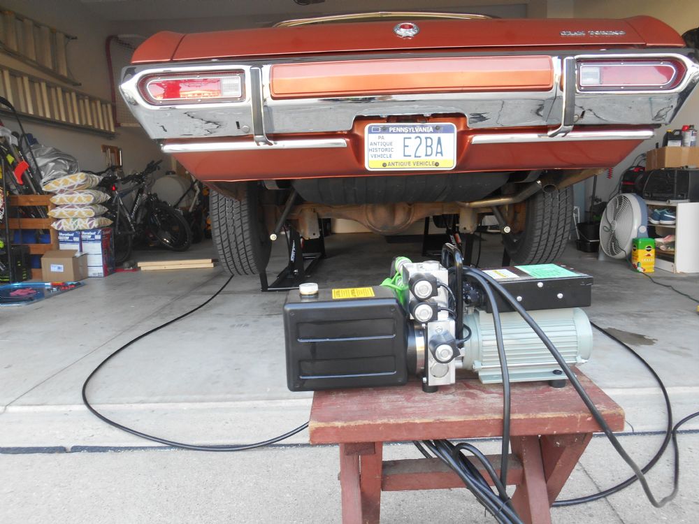

Can you post some pictures of the front and rear clearances once the car is all the way up?
I'm curious how much space to get under a Torino.

I wanted to answer your questions, so I lifted the Torino when I got home from work this evening.
Time-wise, from moving the lift, positioning it under the vehicle, and "lift-off" was 3 minutes 5 seconds.

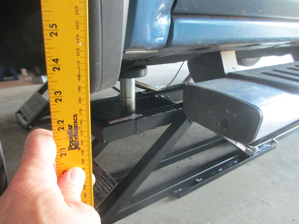

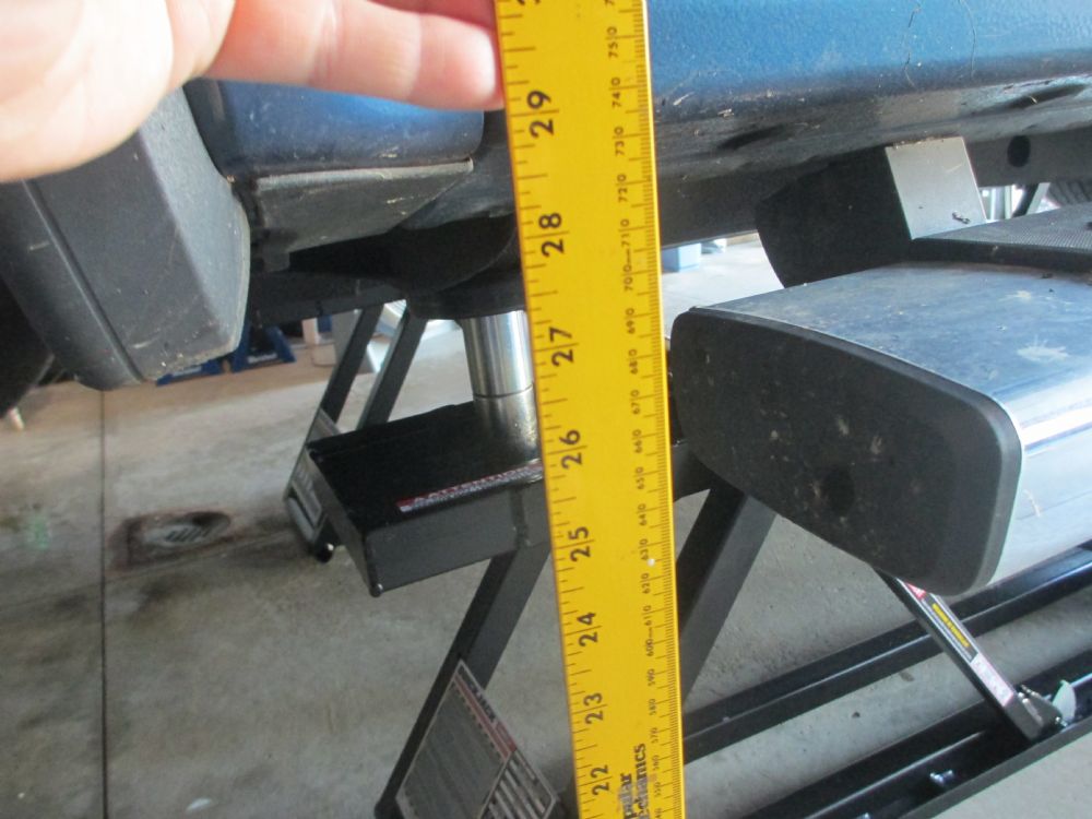

Q:  Height
A:  The photo above was in lifting position #1, there is a higher lifting point, here are some photos at the higher lifting point (my wife said it was really high in our garage).  Both the lower and higher lifting points have safety locks:

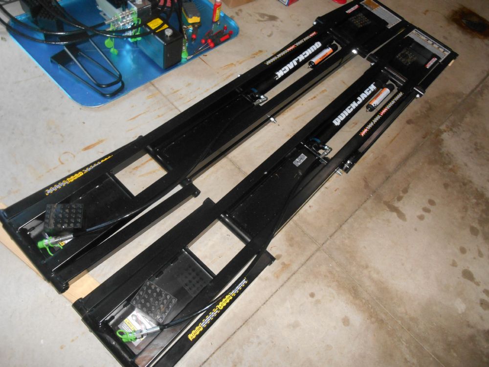

Q:  Setup
A:  I am better with computers than autos, so I really took my time and followed the directions line-by-line.  The only issue I encountered was bleeding the lines, the system uses hydraulic fluid and you need to remove the air.  You have to loosen the lock nut very carefully to only release the air inside the lines.
Q:  Shipping
A:  I opted to have them ship to a freight forwarder as it was a little cheaper, but if I bought it again I would have just shipped it to my home.  It comes in 3 boxes (1 for each lift, and 1 for the motor/hydraulic lines, lifting blocks etc).  The jacks are very heavy (110+ pounds), I lifted them myself but should have waiting for my boys to come home.
Q:  Lifting height (upper position)
A: Lifting height - it varies by the blocks you use, but the manual states below:
- With 2" block: 21.5" (546 mm)
- With 3" block: 22.5" (572 mm)
- Max. height: 24.5" (622 mm)

Q:  Shipping / Packaging
A:  Boxes #1 and #2.  The lifts are about 112 pounds each, they come packaged in a cardboard box but inside they are wrapped with plywood above / below to make the box sturdy and also padding inside.  The lifts were shipped on top of a wooden crate, also.  I picked up from a freight forwarder and they used a fork lift to place inside my truck bed.
Box #3 is the motor, it is also packaged really good for each component.
