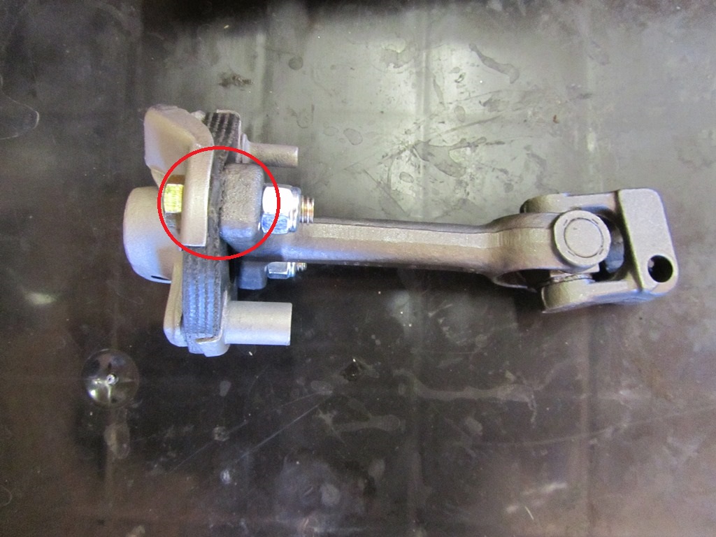

Post Options Post Options   Thanks (0) Thanks(0)   Quote 72FordGTS Quote  Post ReplyReply Direct Link To This Post Posted: 27-April-2016 at 3:16PM
I got the bushings in today, but I have another issue.  The steering shaft seems to short to couple with the steering box.  I am not sure if the new smaller spline input shaft is a different length from the previous input shaft, but I can't get the two to work together where the pinch bolts on each end reach their slots.
I was thinking of trying to use some washer to space it out similar to this picture below.  Does anyone see an issue with doing this?  I am using grade 8 bolts and probably would need three washer.
Any other ideas?

Post Options Post Options   Thanks (0) Thanks(0)   Quote aquartlow Quote  Post ReplyReply Direct Link To This Post Posted: 27-April-2016 at 11:48PM
Vince,
 How far "off" is it? I think the extra washers won't be an issue, but you can lengthen the steering column shaft a bit. The external shaft(the one that attaches the intermediate shaft) is collapsible so in an accident it does not become a spear or something thereof so not only is there movement upward there is also a bit of movement downward. I found this out many years ago working on my first car, a '75 Mercury Cougar. I was also replacing the jag joint and during the procedure(I must have been thrashing on it Embarrassed) the shaft receded into the upper part of the column. I just took a pair of vice grips and attached them to the lower shaft about an inch or so above where the intermediate shaft couple would attach/sit, I used a hammer on the vice grips to slide the steering shaft lower(closer to steering box) until the intermediate shaft couplers would go onto bothe the steering shaft and the steering box. I drove the Cougar everywhere for 5-6 years without any issues until I sold it. Hope this helps. Good luck.

Post Options Post Options   Thanks (0) Thanks(0)   Quote 72FordGTS Quote  Post ReplyReply Direct Link To This Post Posted: 28-April-2016 at 2:44PM
Vince,
Thanks for the advice Todd.  I tried to lengthen the shaft like you described but it didn't work.  I think part of my problem is when I looked over my old photos of the install of my Saginaw steering box install, it looks like I may not have properly seated the intermediate shaft thus making it artificially longer.  I ended up using washers as a spacer, but I ended up using more than I though.  It seems just as strong as the setup without washers.  I also abandoned the bronze bushings.  They were too soft and deformed when I tighten the bolts.  I was able to find some nylon spacers that worked like I had used previously.  In any case the car steering is back together and seems to be working okay so far.  Should have the car on the road in the next day or two if time allows.
