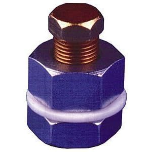

Grande Verde View Drop Down
Joined: 06-June-2010
Location: CA
Points: 342
Post Options Post Options   Thanks (0) Thanks(0)   Quote Grande Verde Quote  Post ReplyReply Direct Link To This Post Posted: 28-October-2011 at 4:06AM
http://www.jegs.com/i/JEGS+Performance+Products/555/60136/10002/-1Here is what I am using for a filler
