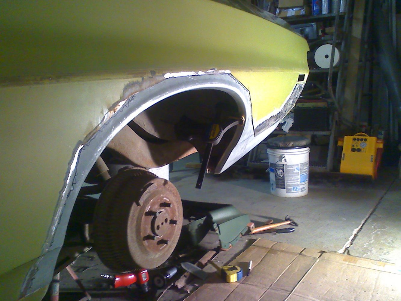

Here are some pictures of the drivers side with the Tabco panel.
1973 base model Torino
73Torino View Drop Down
Joined: 30-October-2011
Location: Waterloo IA
Points: 140
Post Options Post Options   Thanks (0) Thanks(0)   Quote 73Torino Quote  Post ReplyReply Direct Link To This Post Posted: 02-January-2012 at 7:08PM
The reason they let me order the lower section was because sometimes the upper part tears while being made so you really just have to call them and see what they have and ask not demand.

What is your time worth? Rather then spending $300 + for a panel, do what I did when I was in college. Hacky, but no Elite repop panels existed, and this was pre internet.
If you cover it with wheel opening trim, no one will know. It lasted the time I owned the car (3 years+)

Ilyes, just because it's only showing on the lip, doesn't mean it's going up higher.
A primary example, I thought this panel was going to be usable.
I ended up sectioning the panel to use for repair on the GTS.
If you look, on the back side...
Post Options Post Options   Thanks (0) Thanks(0)   Quote Psquare75 Quote  Post ReplyReply Direct Link To This Post Posted: 06-February-2012 at 6:05AM
That panel is better than the Elite panels you gave me. Dead
Post Options Post Options   Thanks (0) Thanks(0)   Quote unlovedford Quote  Post ReplyReply Direct Link To This Post Posted: 06-February-2012 at 7:40AM
He's right Ilyes. One of the most important things is to thoroughly assess the exact extent of the rust/damage before cutting and/or purchasing sheetmetal.
Example: Years ago, I had a '68 Ram Air Firebird Convertible that had some "minor rust" around the lower 1/4's and wheelwell - a very common spot on the first gen F bodies - so I proceeded to start replacing the lower 1/4 section with one from a donor car I had. The rest of the panel looked great both outside and inside where I could see. Got everything cut out, marked and welded in. Looked great. About a month later, I had a leaky cylinder on the power top, and the top needed attention, so I removed everything. Guess what? Underneath all that top-related hardware, in an absurdly stupid spot that no one would look, was a bad area covered in trunk splatter paint. Up by the top bodyline crease. On the panel I had just repaired a month ago. I ended up cutting the entire 1/4 off for a complete replacement including all the hard work on the lower. Back then, a used coupe panel was all there was, and I had cut my only one for the previous repair. 1 additional used 1/4 to buy. That was the last time I ever made that mistake, and I kept that sheetmetal as a reminder to look in EVERY nook and cranny from then on.
