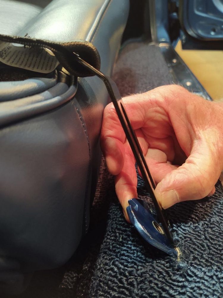

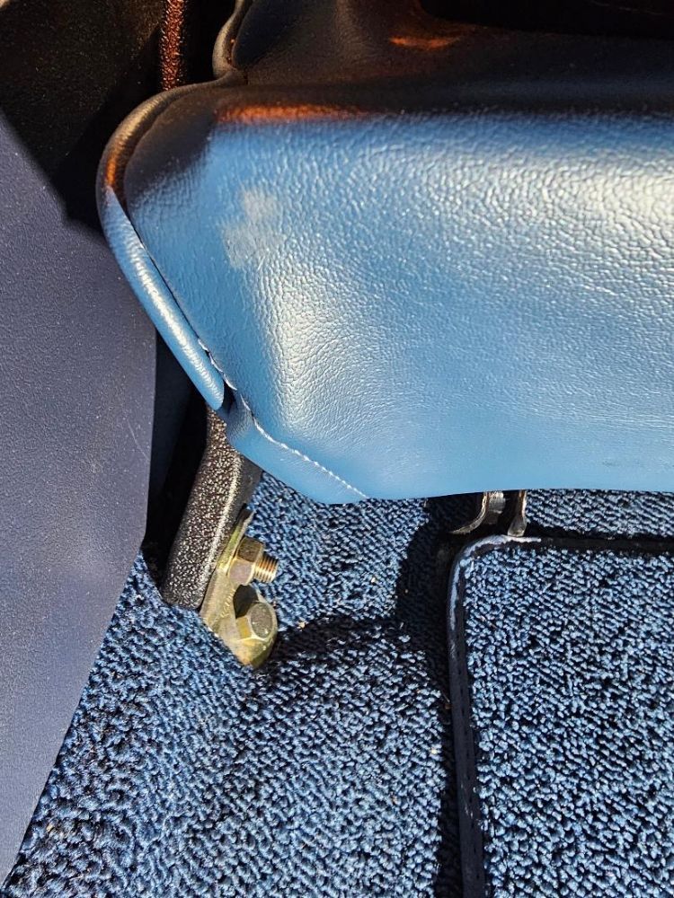

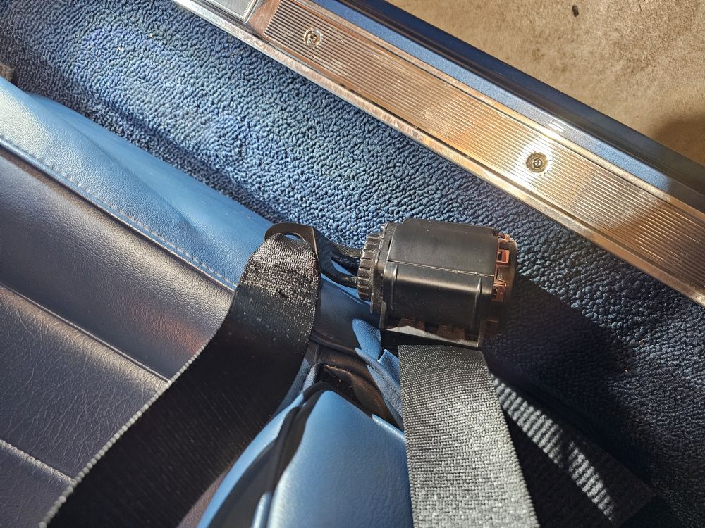

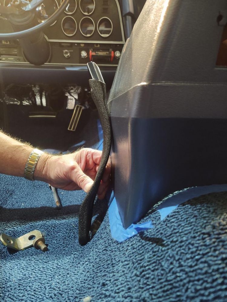

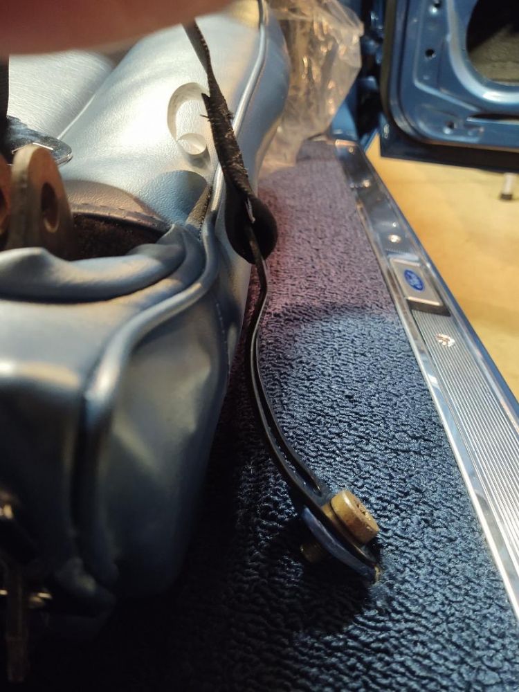

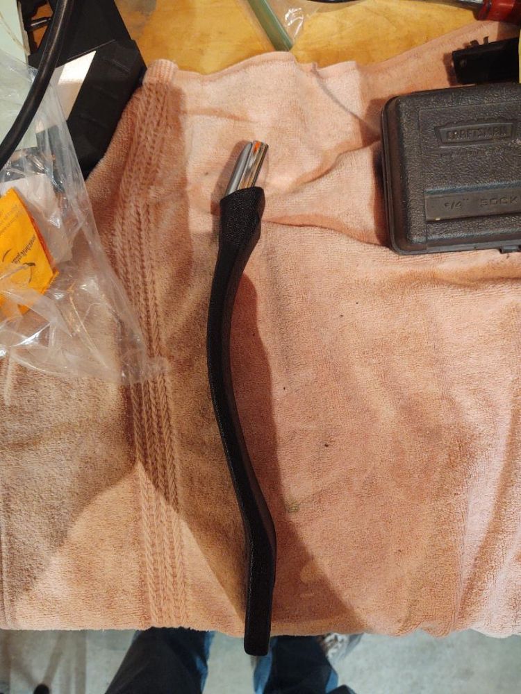

Here's some photos.
Female side 12 inch.
Female side next to drivers side console.
Passenger side female belt next to console.  The bracket was bent open to about the recommended 130 degrees.
Retractor side passenger seat.  The bracket is straight at this point.
Retractor side bracket after being curved up to fit seat contour.
Retractor and bracket mounted together.  Hope these help.
Edited by 1973gts - 23-May-2025 at 12:52PM

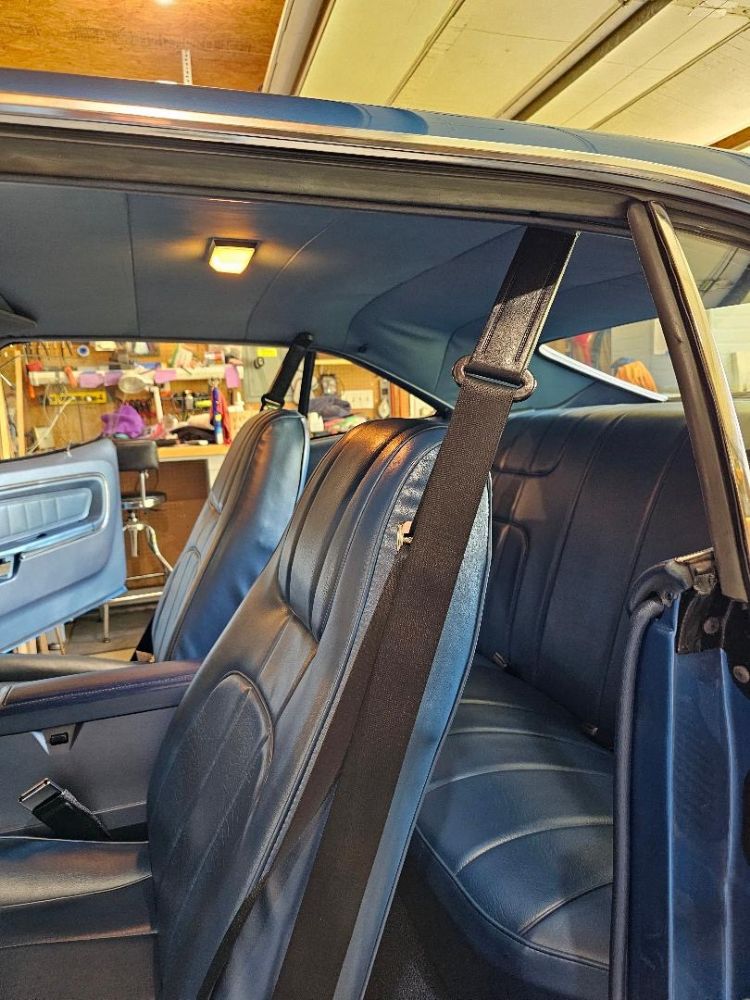

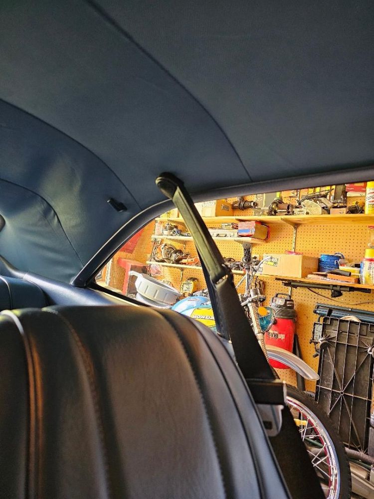

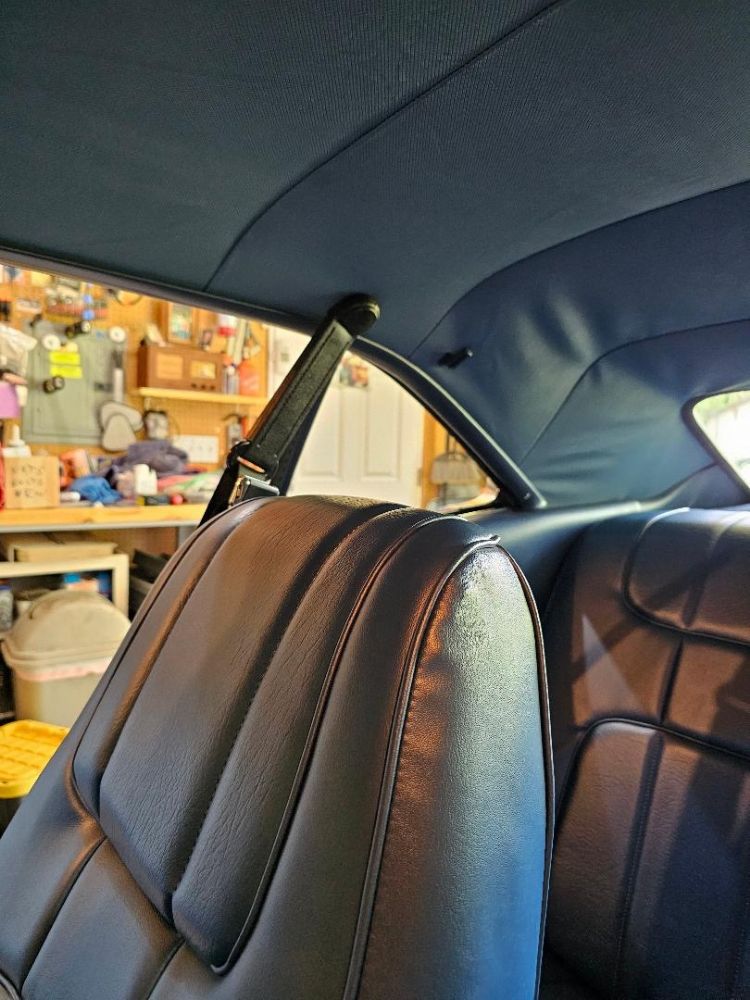

Here's a few more photos.  I used the existing roof anchor point for the upper seat belt bracket and the angle seems to work fine.  The rest of the pictures show the seat belt placement on me and it feels comfortable in this position.  I am 5'11" and mid 190 lbs.  The seat is in the furthest back position.  I have not done anything with the rear seat yet and just have the original lap belts there.  Access to the back seat is easiest by pulling the belt all the way out of the retractor and holding the belt forward when stepping in which is fairly easy to do.

Thank you very much Dave!  Those pics are exactly what I was looking for.  Those belts seem to work really well for our cars, so I think I will add it to the list of upgrades for my car.  One more question.  Does the belt set come with that extension piece that bolts to the ceiling of the car?

Post Options Post Options   Thanks (0) Thanks(0)   Quote 1973gts Quote  Post ReplyReply Direct Link To This Post Posted: 25-May-2025 at 1:34AM
Vince, it does come with the extension piece and if you do get the belts make sure you order the bracket set 950001, that's the combo that was recommended by Steve at Seatbelt Planet.  Also it would be best to talk to Steve when ordering to decide whether you want the 12 inch female end and with or without the sleeve, the sleeve works really well with the buckets and the 12 inch length is just right in my opinion.
