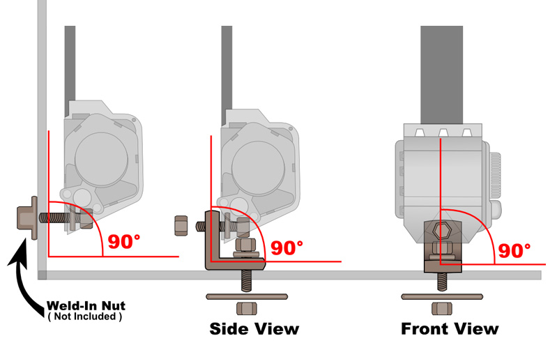

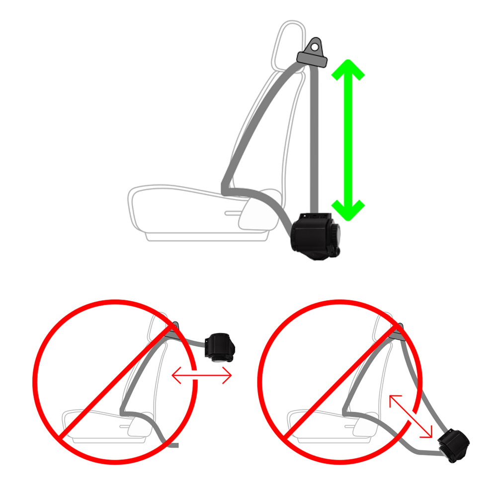

Has anyone on here upgraded their seat belts on there 72-73 Torino?  I would like to add in rear three point belts for my kids and I figured I could upgrade my front belts too.
For the rear belts I'd kind of like to have the retractors mounted in the trunk somewhere.  I figure that the trunk floor or wheelhouse is more solid than the package tray.  Plus, it'd look much cleaner.  Here is a pic I found on a Chevelle.
My concerns would be where to mount the actual retractor.  I am also not sure how to fee the belt through the package tray.  The picture about has some sort of belt sleeve, but not sure where to find that.
If I was doing the rear belts, I'd also like to do the fronts.  There are a lot of universal setups out there, but I am not sure how well they will work with our Torinos.  I'd like to use the stock mounting points for the front belts.  I figure modern three points would probably be more comfortable, while also probably safer overall (due to the better retractors).
I have seen some setups too with these drop mounts on the ceiling. I was thinking they might work well since the shoulder belt mount points are pretty far back on the '72-73 cars.
Any advice is appreciated.
Post Options Post Options   Thanks (0) Thanks(0)   Quote californiajohnny Quote  Post ReplyReply Direct Link To This Post Posted: 15-October-2017 at 6:35AM
vince, does your car have the roof mounting point like in the pic ^^^above? if so it would be easy to convert the front belts!
 74+ have a lower double mounting bracket i have some brackets you would just need to get 74 -79 2 dr belt retractors
the rear IDK can be done but not sure what to use?

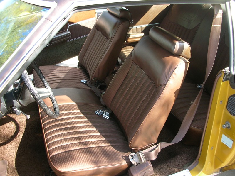

Post Options Post Options   Thanks (0) Thanks(0)   Quote 72FordGTS Quote  Post ReplyReply Direct Link To This Post Posted: 16-October-2017 at 12:56PM
The stock 1972-73 seat belts mounts are like in the picture I posted above (which is a Chevelle).  They are further back than the 1974-76 Torino shoulder belt mounts.  This is discussed in this thread here:
It doesn't seem to me that there is any definitive conclusion on if the later belts will work or not in the older cars.  I am also not sure if they floor mounts for the retractors are the same for the 72-73's and the newer cars.
The fraying of the belt is a big concern if I mount them below the package tray.  From a quick look at the tray on my car, I'd probably have to cut slots in the tray for this to work, then figure out how to prevent the belts from rubbing on the sharp metal.  I do like the clean look, but it's a lot of work.  The photos that I posted from that Chevelle, the guy used parts for a 2009 Camry to may it work (the belts are aftermarket though).

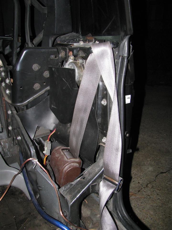

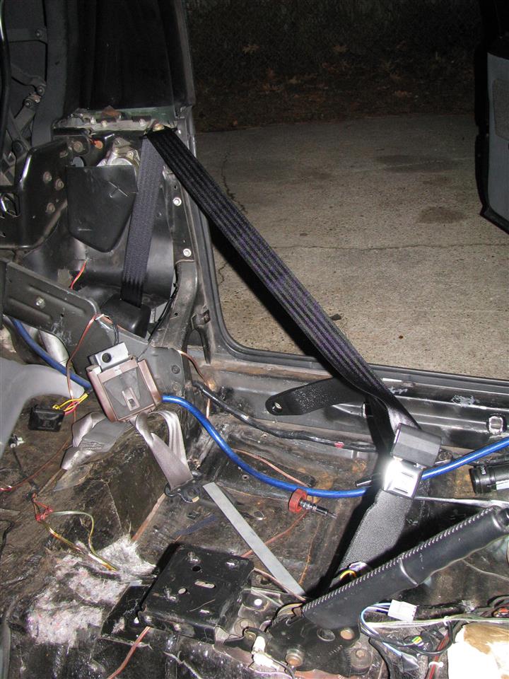

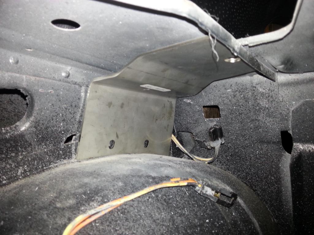

I also was doing some more searching through the archives and I found that member Sininenlll did do this conversion.  He did it a little differently than most of the other conversions I have seen.  Typically the retractor is mounted up high like on modern cars, with the two factory belt mounts being just solid belt mounts.  He mounted the retractor down low, mount a seatbelt loop up high on the package tray area.  It works, but it's just not as clean as other installs.  I means that you have two belts running up the seats instead up one (because it's looped over).
Edit:  after looking at his pictures more closely, I think he actually used 3-point non retractable belts.
Here is his install:

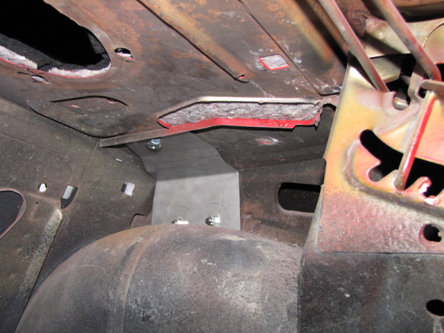

 These are custom reinforcement "L" brackets he fabbed:
Here is that thread:
It seems most of the aftermarket kits have the belt retractors mounted on the package tray. Of course there are no kits for Torinos.  I did see one company called Morris offers reinforcement prackets for the package tray mounts.  This might be a viable option, but I have to fab up my own package tray reinforcement.  Below is pics of a Morris kit installed in a Chevelle.
Here is the Morris reinforcement bracket.  I think something like this would work for a Torino.

So I had a little time to do some searching and it looks like the 1972-73 front seatbelt mounts are quite a bit different than the 1974 and newer mounts.  Here are some pictures I found for comparison:
Here is the 1972-73 style floor mounts:
Here are the 1974 and newer style:
So I think retrofitting the newer style retractors to the 1972-73 cars would be difficult without changing the mounting tabs.  I also found a couple of good pictures to show the difference in the shoulder strap locations.  The 1972-73 cars were much further back compared to the 1974 and newer cars.
Here is a 1972-73, note how far back the shoulder belt is mounted to the roof:
Here is a 1974 and newer style:
Since the 1972-73 style tabs are on an angle, this might also make mounting an aftermarket retractor difficult.  It seems most of the aftermarket retractors mount directly to a b-pillar or at 90 degrees from the floor with a "L" bracket.  This is shown here:
So I think retrofitting the front belts with a modern setup might be difficult if I want to use the factory seat belt mounts (which I do).  I am wondering if I send my stock setup to a seat belt company if that can alter it and install a new retractor assembly in the existing setup.  That might be big dollars though.
Anyone have any thoughts on the front belts?

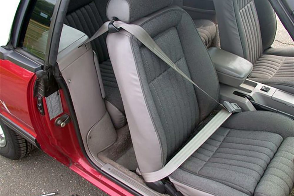

Vince, I am going to chime in here. Dragging up this older post.
When I was selling off Dave, my 1993 Mustang fox body, I kept a spare set of front belts.
I've wondered how hard it would be to adapt mustang belts, and place the retractor down in the front of the 1/4 panel and weld in a plate into the rocker panel structure. The rockers on our cars in places are 4 layers of steel sandwiched together.
This is a convertible fox body front seat belt mounting:
Only pause for concern would be the B pillar is for all purposes the same as a mustang convertible, with no post going all the way to the roof in the example of a GTS / Sportsroof body.
Formal roof cars are a bit better of structurally as they lack the larger quarter window area.
With that said...I'll be frank.
Our era of cars while they may be proverbial tanks on the 73+ battle ram bumper cars...the safety restraint belts in our cars are a horrible design in my mind.
72-73 Sportsroof upper seat belts are utterly worthless.
 Short of installing an impractical "tiger cage" type safety roll bar (modular system with better adjustability for most 2 door RWD American coupes like Torino, Chenille, Cutlass, etc...that messes up the rear seat access.
Primary reason my car never got a seat belt cage/bar is because I didn't want to mess up rear seat access. I've considered a Shelby style 3-point seat setup but never bothered. Ricaro makes a copy of the Shelby seatbelt trip-point system with a retractor, but again, never sure I wanted to mess with something like that as I am by no means an expert when it comes to safety placement of seat belts.
This design has a top retractor, but you have to have a roll bar hoop to mount this to behind the front seats.
Seems the least invasive to me and belt retractors allow movement.
Lower lap belt is a single mount point like 72-73 Torinos.
Again, I'm no expert but a constant thing hitting back:
I'd like to see belts that are shoulder level or higher to avoid crushing of the spine.
One of the issues I see with the fox body convertible seatbelts re is the upper point sits too low.
