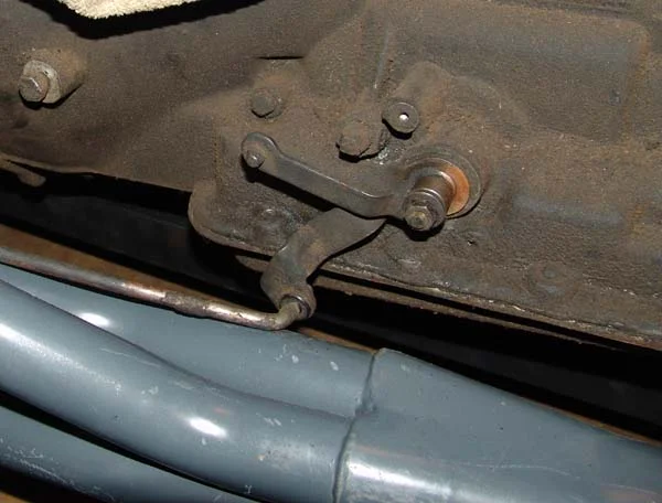

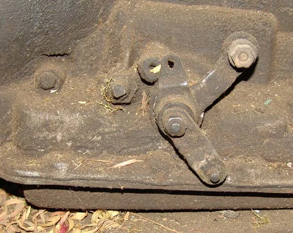

Did you change the shift arm on the trans? I think I recall reading some where that on the C6 you need to swap the arm on the trans.
I found these images, they are earlier but note the difference. This first one appears to be a Floor shift lever... ![]() Where this one appears to be a column shift. ![]() Note the length and orientation. The basic part number is 7A256-xx where XX is the application indicator, but I am haven't had time to go find the correct number. Good luck!

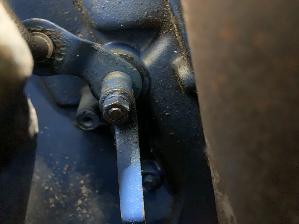

Thanks for the pictures and part numbers. I’ve got a little time before I leave this morning to snap a few pictures before I leave for the dirt Jersey. So I’ll show you what we got for a temp setup so he can atleast move the car. Don’t judge though it ugly since we were trying to fabricate it to work. The lever in the first picture is similar to what we have on our trans. It points up like that. I’ll post when I get the pictures.

Note those great pics by Pete, those should be the two basic possibilities for the trans shift linkage. Over the years Ford most of the time used two possibilities to operate the floor shift versus column, plus cars and trucks. There is often a different mounting bracket for the cable where it connects to the trans. Those and the different shift levers inside the trans, together usually decided what works with a given shifter type. The trans shift lever is held on by an internal nut, and it's no too hard to swap(there will be a drift pin pushed into a vertical hole that locks the lever from moving in/out). So most likely you can get it working with OEM parts. But you need to figure out which direction the cable moves, plus the effect of the given trans shift lever. One way it will pull or push, and the distance is also affected. I had an AOD mocked up in my 73 Ranchero before I moved and stored it away. I had to swap the original shift lever to one from a 90s F150, plus the matching bracket.

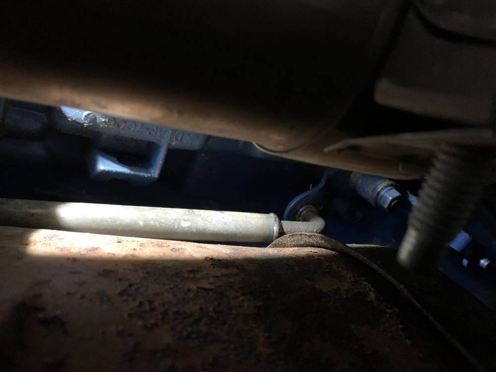

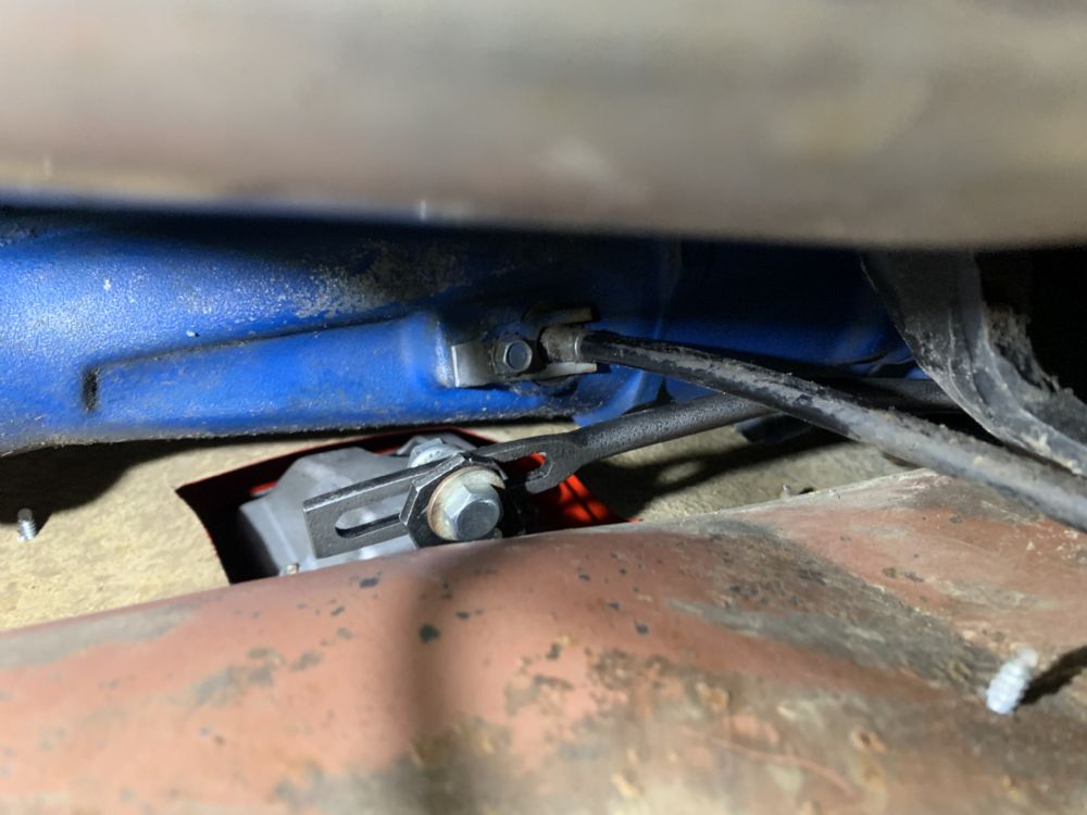

Well it looks like we are going to have to use one of those universal jobs to get it working right unless we wanna drop the pan and valve body once we find the right lever. We welded a pipe in between the ends of the rod to try to get the right length. And the bolt on the very end is not right. That’s temporary because I messed up the new bushing trying to press it back in.

Any updates? I looked at the parts catalog, and it lists a different lever on the transmission for the floor shift vs the column shift as I suspected. So the universal one might get you working properly at least, as I am not sure how hard it would be to source the correct lever.
