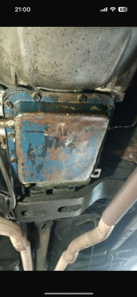

I’ll look under at the trans sump and see if I can get a pic

Here’s the pic of the pan
Post Options Post Options   Thanks (0) Thanks(0)   Quote 72FordGTS Quote  Post ReplyReply Direct Link To This Post Posted: 17-July-2024 at 10:20AM
It looks like a C4 to me from that picture. Does second work if you manually shift into second? Based on your symptoms it could be that the second gear band is out of adjustment. You could have the shop adjust the band to stock specs.  It also could be the band is completely worn or broken, which will involve a more serious repair and /or rebuild.
