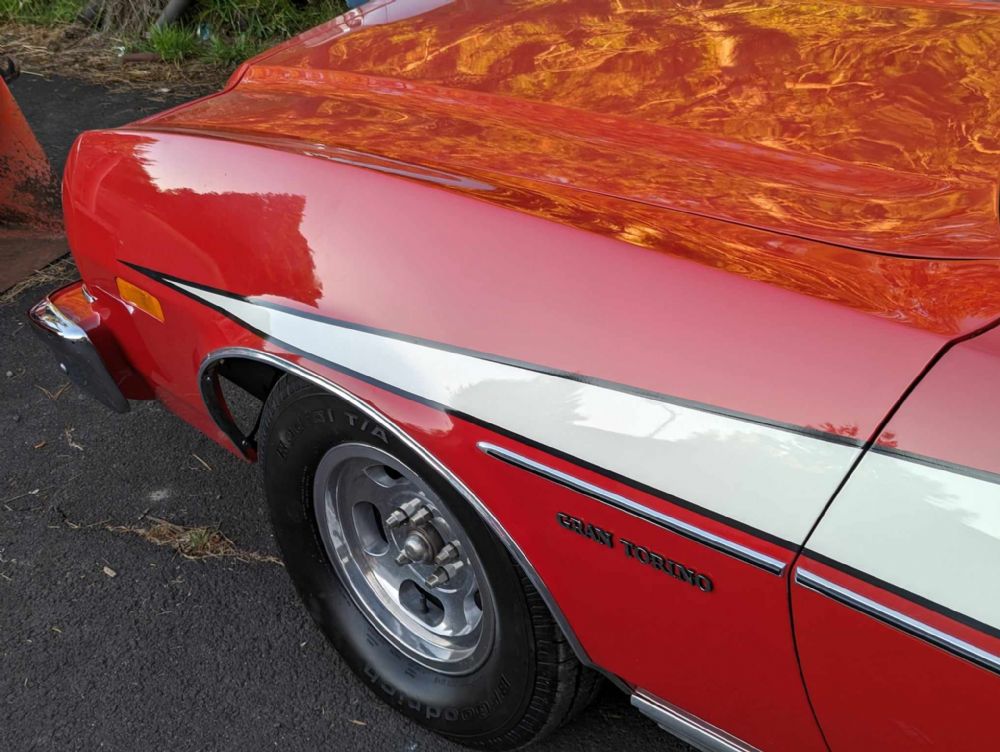

Hi George, there are three different TV Show Torino's that you can replicate the stripe and mirror/trim combinations:
Pilot Episode (side impact trim and standard or deluxe chrome mirrors)
Season 1 (red sport mirrors, side impact trim deleted)
Seasons 2-4 (deluxe chrome mirrors and side impact trim)
The Pilot episode had a smaller stripe and a thicker 3/8" black pinstripe. You can see the first pic where the stripe rides about 1" above the side impact trim.
Season 1 had a larger white stripe and a smaller (1/4") black pinstripe. And the bigger size pushed the stripe down to that body line where the side impact trim would sit. The bigger stripe would also push the front of the stripe forward past the front side marker light.
Season 2 they slightly changed the design of the front of the stripe (you can see it sitting 1" above the front side marker light) and they switched to deluxe chrome mirrors and added the side impact trim back on.
Ford also produced just over 1,000 limited edition S&H Gran Torino's that had the red sport mirrors, no black pinstripe and no side impact trim.
So depending on which S&H Torino you are looking to replicate, we can definitely put you in contact with the right person.

Does anyone know how far off my stripe is?
Post Options Post Options   Thanks (0) Thanks(0)   Quote californiajohnny Quote  Post ReplyReply Direct Link To This Post Posted: 24-April-2024 at 6:48AM
 looks like the rear of the curve is about 3" too far back...?
