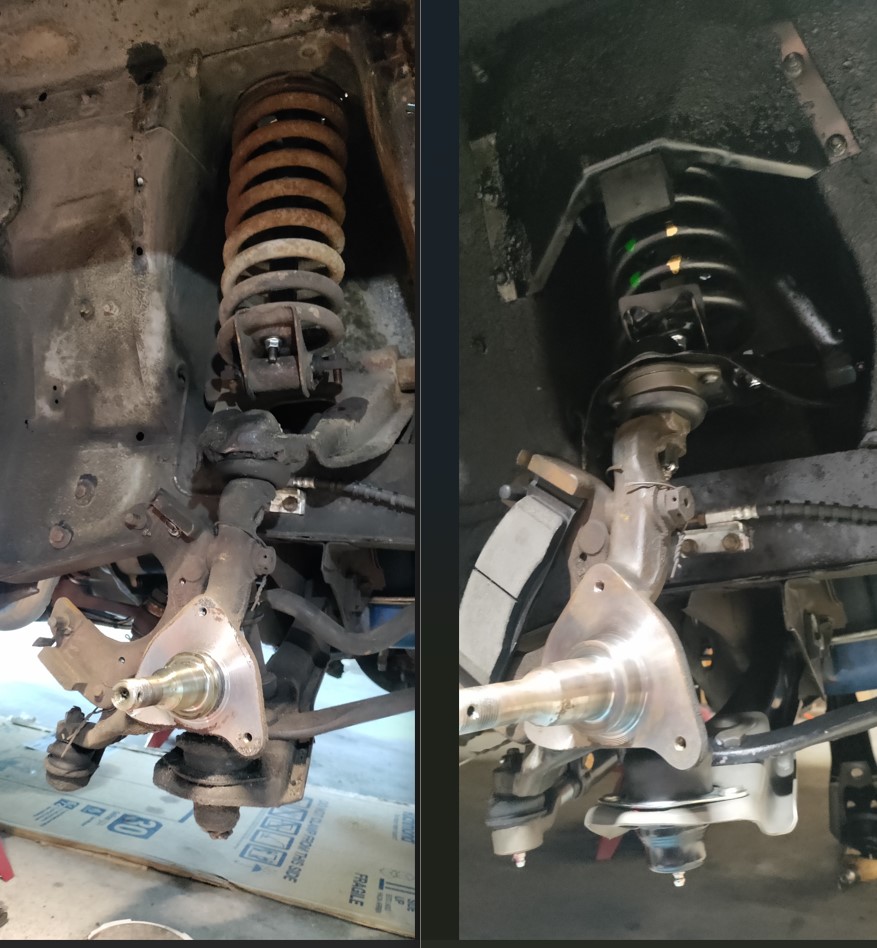

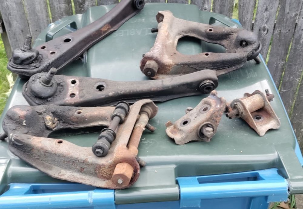

I used Moog & Scott Drake for parts when I redid my stock front suspension (control arms w/ball joints, tie rod ends).  I used some roller spring perches from e-bay.

Wow! That looks fantastic. What is that lower spindle? Mind ballparking what you spent on the parts alone?
Post Options Post Options   Thanks (0) Thanks(0)   Quote schufitz Quote  Post ReplyReply Direct Link To This Post Posted: 04-June-2025 at 3:08AM

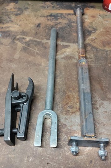

Thanks.  The spindles are factory, just cleaned up with brass brushes and degreaser.  I bought the items 'piecemeal' over a period of time and finally tackled the job last summer.  I probably spent close to a grand all added up.  That includes the roller perches, the SD lower arms (they have the 'tabs' and silver paint), an internal spring compressor tool, joint breaker tool & pickle fork for the ball joints.   I got Detroit Eaton springs but used the originals as the DE ones seemed too 'beefy' and would have most likely worsened the reverse rake the 68/69's seem to have.  Full kits are available a bit cheaper as noted in a reply above, but piecemeal is just the route I went.  Good Luck in whatever you decide.   I did get PS hoses from Choko-stang and the ram & valve, but have yet to tackle that project.

Did you build your internal spring compressor or purchase it?
Post Options Post Options   Thanks (0) Thanks(0)   Quote schufitz Quote  Post ReplyReply Direct Link To This Post Posted: 24-June-2025 at 7:34AM
E-BAY purchase

I also bought that one from eBay. So worth it.
