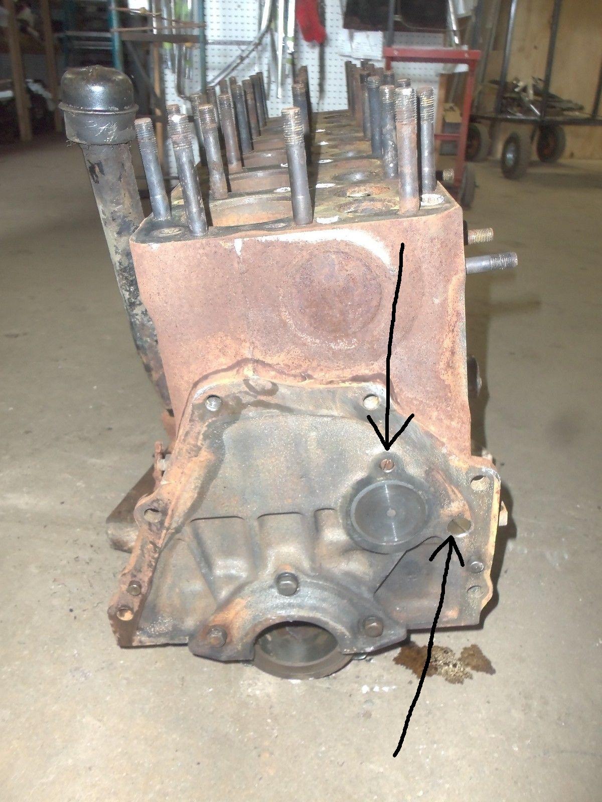

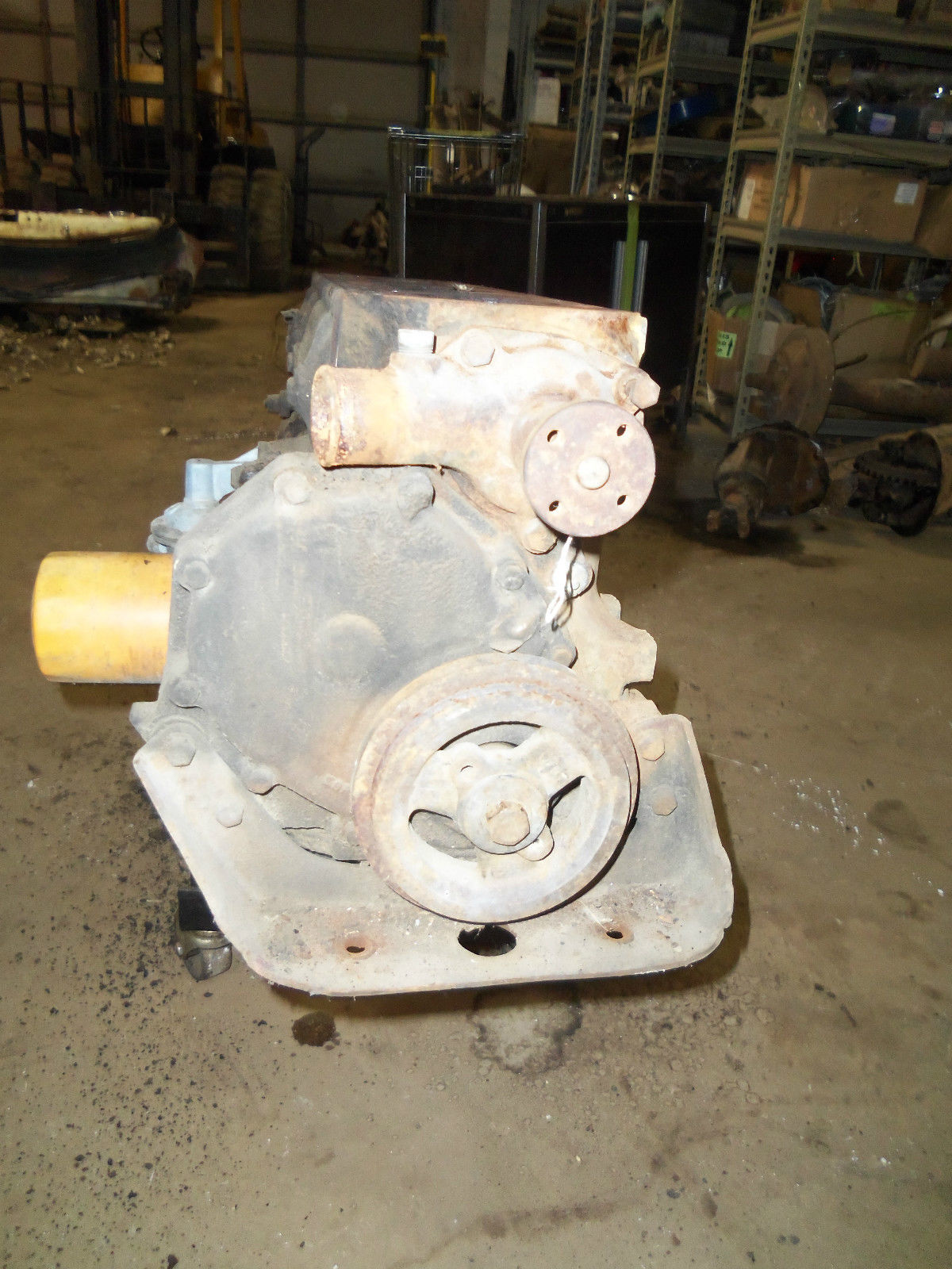

dave302 ![]() Senior Member ![]() Joined: 08-October-2009 Location: usa Status: Offline Points: 3170 |
This is a picture of the front of the same 1954 through 1964 ford inline six cylinder engine block that i had posted five pictures above. I am posting this picture to show that the other picture of this engine (in the first/top picture above) is the rear/back of this same engine (not the front). Hopefully your rear oil gallery NPT Type of plug is not missing.
In the worst case possibility, if your rear/back oil galley plug is missing, you can still install a new plug with the engine still in the vehicle. But the transmission will have to be seperated from the engine to install the rear plug.
Rockatansky ![]() Senior Member ![]() Joined: 30-July-2010 Location: On The Road Status: Offline Points: 5577 |
if the rear external plug were missing there'd be quite a mess of oil on the floor & very quickly
if an internal plug is missing the pump may still flow the oil you saw in the dizzy hole but not be able to fill the lifters & flow to the top end personally I don't fire the coil until I get oil to every rocker arm, by turning the oil pump shaft with a speed handle & rotating the crank in 90* increments... the lifters may not fill & flow unless the plungers get exercised over the cam lobes it's pretty amazing there's not more experience with the Ford 6-pop out there to answer a few basic questions about the oiling system
