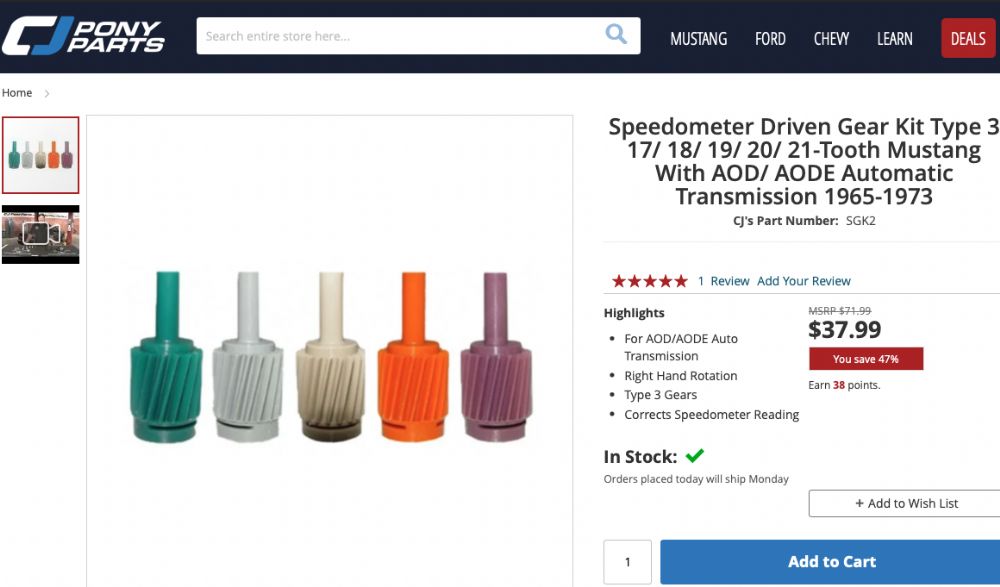

As far as the physical stock style speedometer cable, you need to look for references under 1973 Ford Gran Torino sometimes. Parts listings online seem to have more issues as time passes causing confusion and problems locating the correct parts.
This cable is for use with vehicles without cruise control.
If the speedometer is not reading, you will need to verify if the gear on the speedometer cable that goes into the transmission is good condition and not stripped or worn out.
It may be worth buying a complete set of gears so you can adjust as needed. Time is minimal for changing out the gears on the end of the mechanical speedometer Cable.
These gears can also be used for the electronic speedometer sending unit.
