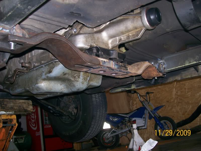

the E4OD will bolt but you'll be dragging the pan on the ground and you can mount a cup holder to it
this was in a 70-71 IIRC. for less issues and near the same $ by the time you're done look at the Gearvendors OD unit
