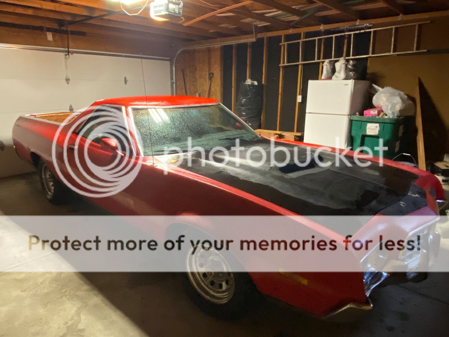

The Victim.

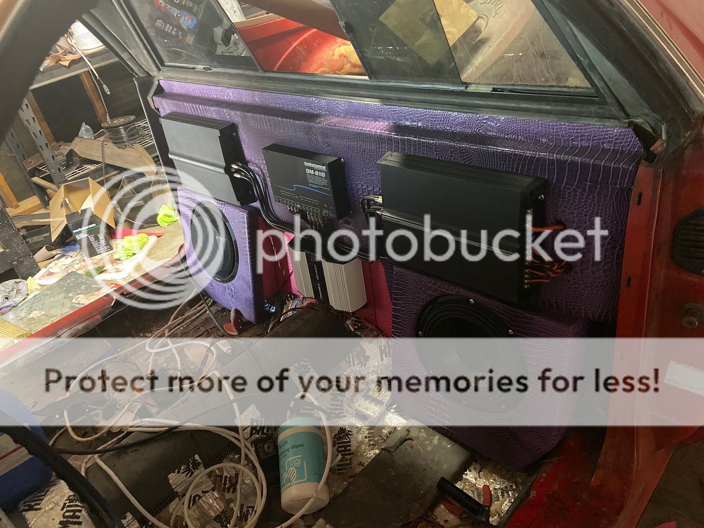

What the space was begging for, 2 alpine X. Extra battery. DSP. Two Focal 4 channel component amps. 1 5k watt. Fuses, battery isolation. Who needs a spare? Ill call AAA. �£

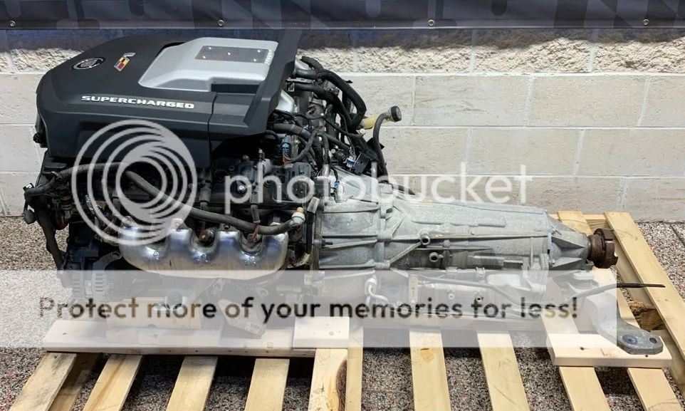

556Hp supercharged with 6 speed auto
Cold compression test came back 175-180. Gonna ship out monday so im jamming to get my other details finished up so i can focus on this one. CTS-V LSA and 6L90E
 Im sure ill need to cut my tunnel, i was gonna keep the prefectly good runnin 351c all the way to the point of i bought many parts for it. High amp alt, A/C system, water pump, motor mounts, headers, fully rebuilt the FMX with new torque converter.. but couldnt help myself. 🤭 im gonna put that up for sale.

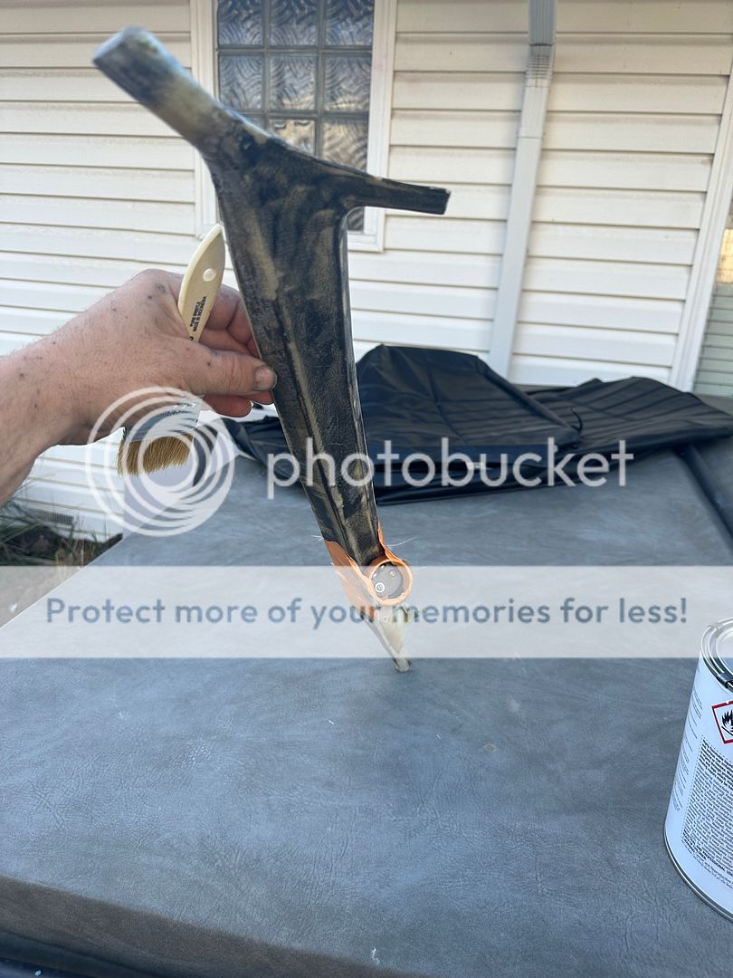

Headliner today, just cut it out. Im gonna sound deaden the roof. Then ill put in some laminated plywood braces instead of the metal rods typically in a headliner
Anyone wanna buy a new headliner and the rods? I used it as a template? LOL

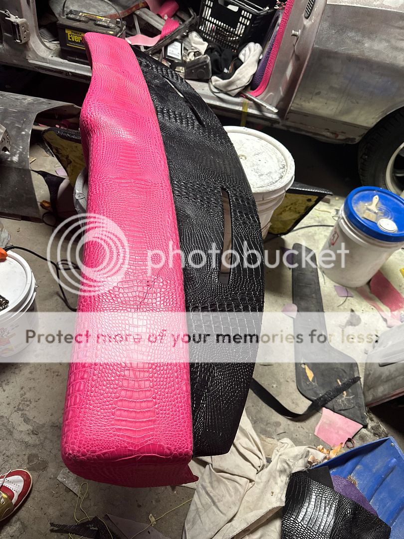

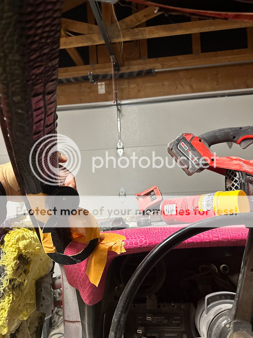

Ill then make an overhead console for the rearview cam, gps, and a dash cam. Wrapped in bubblegum pink. Ill mock it now, but final installs after paint of course.

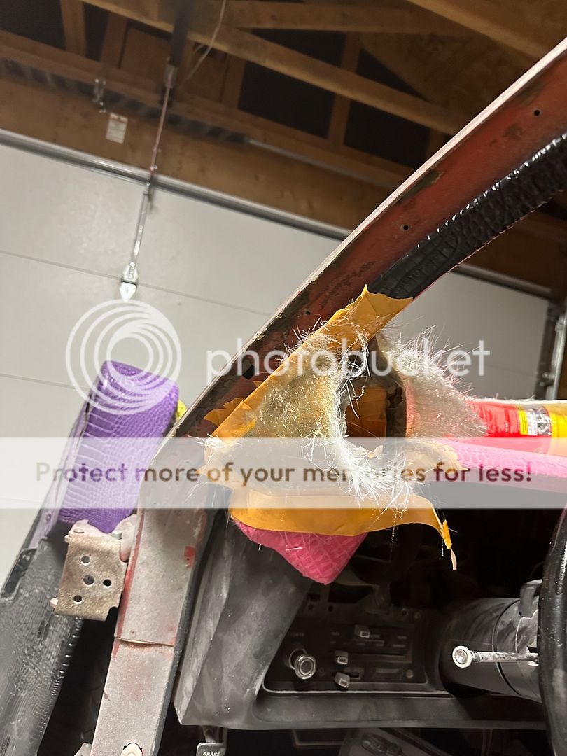

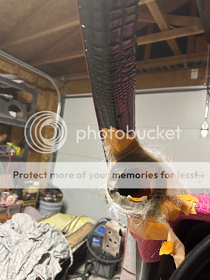

Custom A-pillars, mine were busted in several places. Fiberglassed them, custom ground them to fit, adding Tweeter pods.

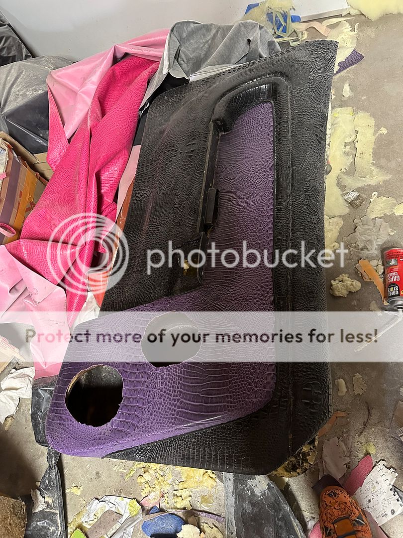

Custom door panels, used the stock gt’s and kept with the general layout adding a speaker box for two 6.5 focals in each door. One will be K2 midrange, and a K2 midbass.
Entire doors been sound deadened with spray foam. Gotta somehow get my power window kit into that door too…

Im running Focal which is a top SQ audio company that makes this stuff in France, 6.5 midbass and 6.5 midrange plus tweeter in each door, Then theres the tweaters on the A-pillars. powered by two 4-channel Focal Component Amps.
 The Alpine X’s are 10” being fed clean power from an amp by taramp that has more overhead still. The DSP is a 10-channel by Audio Control. Every speaker on its own dsp channel, with its own amplified channel. Spare gel cell stereo battery, isolator, charger, fuse panels, massive alternator, zero gauge main wire, custom made and bent rca cables for everything.
Theres close to 10G’s of stereo stuff in there no labor. Big smileLOL I love listening to music its my happy place, and cars are where i feel safest. Ill just sit in my driveway listening on bad days. We call it Sweden.
On the engine I Figured out by the time i bump the cleveland to 500+ hp and go modern fuel injection that i get a more exspensive motor with less fuel mileage and reliability. Speaking to some motor builders yielded same answer. An improvement of 8mpg pays for itself in short order, i drive tons and will also use the car as advertisement for my company WinkBig smile plus with headers, intake, tune and pulley ill have 600+ Hp in a reliable package.
Thankfully theres a boatload of space in that Ranchero nose for supercharger heat exchangers and reservoir tank, a/c evaporators, 4 row aluminum radiator with tranny cooler, and the probably 4 electric fans. Im gonna make this thing not “heat soak” either which is tough to do.

Sounds like a great audio setup with REALLY good equipment. Be careful with the spray foam insulation, it absorbs water and holds on to it for long periods, which can and usually will cause major rust issues down the road especially in the doors which do get a reasonable amount of moisture from rain and washing the vehicle. Keep the the pics coming!

Oh dang! Didnt know that.
Ill seal off the spray foam, its directly attached to the door panel itself.
 I noticed my Jaguar used a similar foam from factory but also had a piece of plastic between it and the door. Ill do something similar. Thanks for pointing that out. I need to dissasmble my door and sandblast the inside of it or something, and gonna sound deaden with killzmat.
If i wanna hear exhaust/engine ill roll a window down Tongue

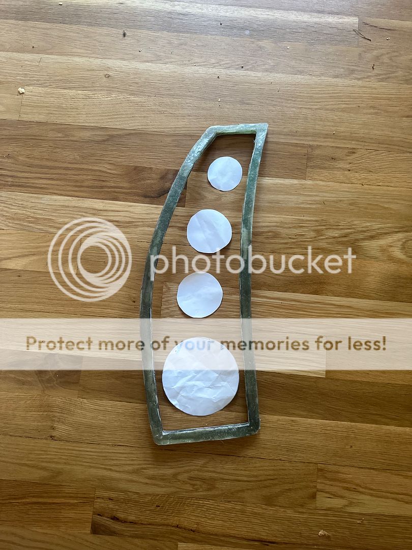

Heres the custom tailight trim. Made fiberglass oversized trim, the white paper circles are infinity led lights. Ill make rest with lexan and black acrylic. They are oversized filling the whole available space where the old ones sat. Will be cutting a good bit of metal out but this will make the car so much better.

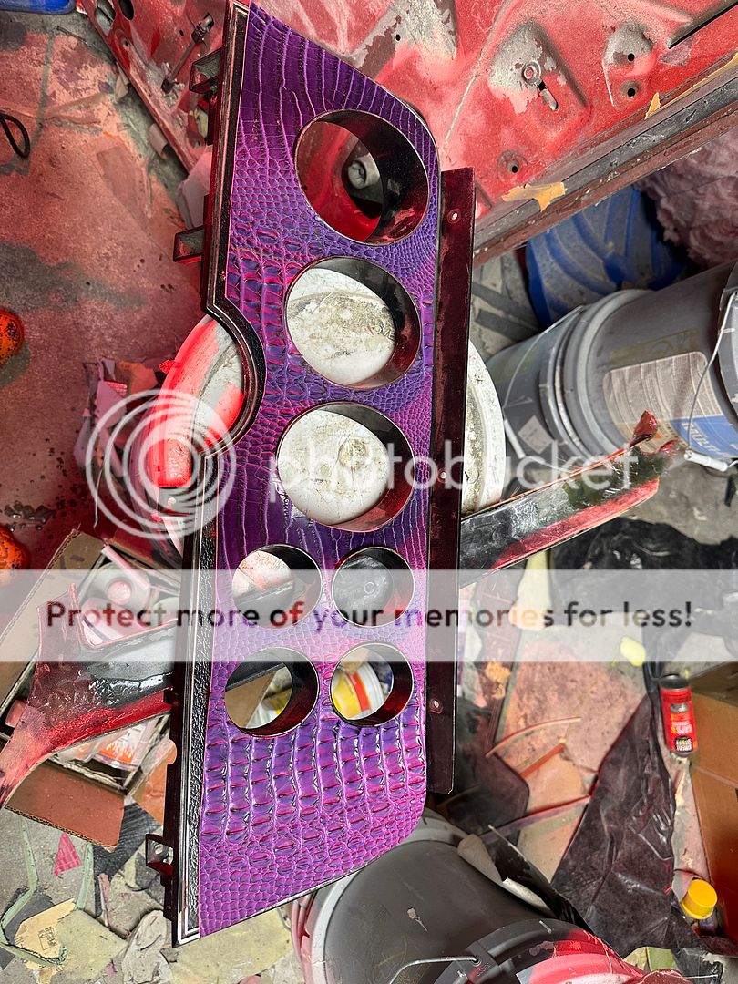

Im getting a bit overwhelmed.
I want to use the stock gauge bezel, ill retrofit gauges to it, i have no worries getting that to fit.
How do i wire them and keep obdii working?
Seems they come with own sensors.. and my harness will come with connectors for stock sensors..
Please hep

New gauges too, not gonna mess with the stock ones going all digital.  ill just mount them behind this guy (bezel) in the dash gutting the rest of the junk behind it.
Ill pop onto some GM forum to find some more info on the way it gets wired. I have zero experience doing any of this, so just winging it.

I nearly went that route, getting all the cts-v stuff and retrofitting, but i didnt though i am still on lookout for a stock harness which might give me some advantages if i want to keep extra things.
I can retrofit in regular gauges like this style to the dash i have,
or im still game to run a digital screen and pass along this one to someone else… maybe thats way easier.
Do i just snag signal wires from the back of the OBDII port?

Im stuffing glowshift in my bezel, new sensors, they make a proper adapter, and idk if obd2 works after that but probably, its got seperate sensors for gauges vs computer on the engine.
Blah blah blah.
Ill have purple glowing gauges. Ill add an intake air temp gauge and whatever later to a different spot ill come up with.
Im gonna redo dashpad in purple, i did a rough job on the pink and messed it up a bit while making other bits i hadnt planned on before hand.

cool build.
What engine / trans was originally in the Ranchero?
NT
1972 Ranchero gt View Drop Down
Joined: 05-March-2021
Location: Denver
Points: 21
Post Options Post Options   Thanks (0) Thanks(0)   Quote 1972 Ranchero gt Quote  Post ReplyReply Direct Link To This Post Posted: 01-February-2024 at 3:10PM
351 cleveland with fmx
runs great, i even rebuilt the fmx fully LOL

spent allot of time with my GF in new mexico, worked on a few things. changed how im doing gauges...
taking body off frame next week, figured out how motor is going in and its gonna fit ok, but idk about the hood....
