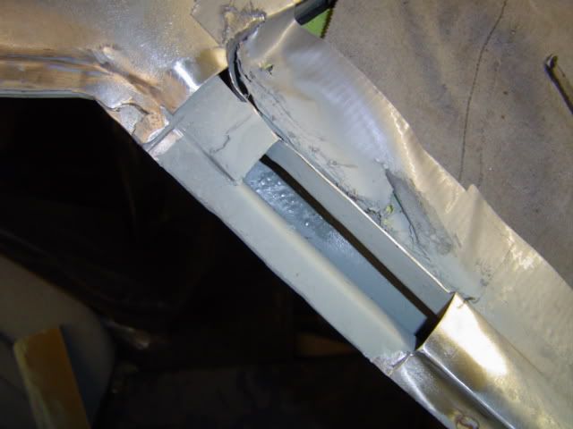

I will say as Jeff pointed out, the overlap, you coat with weld through primer. I still scratch off where I am going to weld, say like a rosette weld {punched hole in top panel, and welding to panel below}.
Only concern, be careful about not breathing in too much of the fumes, ESPECIALLY if galvanized metal.
In my GTS, I think I went through a half dozen cans because I was spraying anything bare.
Example: Fender repair, replacing the supports on my NOS fenders:
A small patch I had to do on the trunk floor:
In the case of a butt weld, I did this on the center of my door. I sprayed the inside of the door as much as possible:
Repair of the A pillar, I had to fix both sides due to rot:
Fixing the wheel house lip:
On the welding of the quarter panel...before we had to hack off the top and fix my over-exhuberant welding job...
Another place that was sprayed, in the quarter panel/jamb area.
