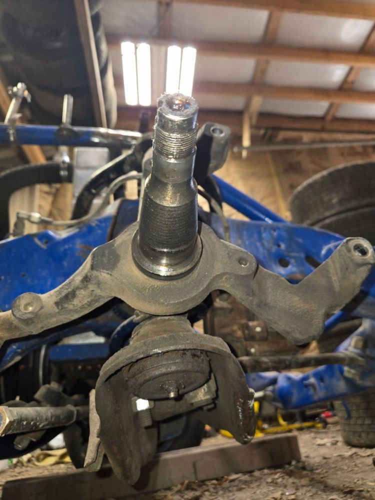

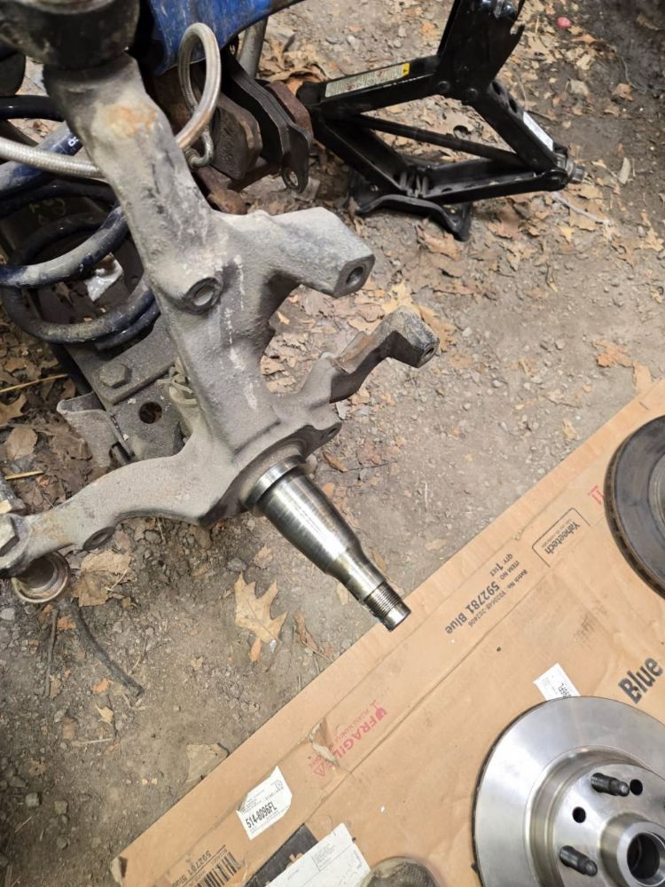

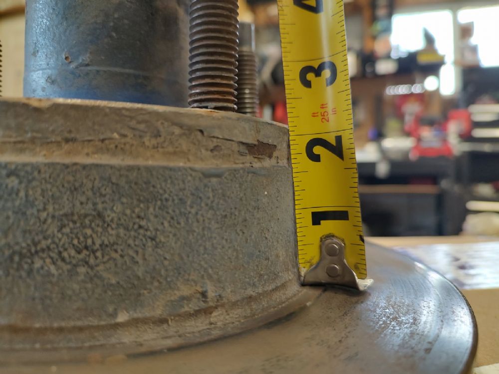

Here are the pics.
Gary

I see a tube chassis. It's hard to say what race car guys did, as a lot used and cobbled together whatever they had at hand, followed by whatever was available cheap.
What's your rotor diameter?
Ford thunderbird had 5x5 wheel pattern. And they used the bearings you listed from 74-76. So it might work for you, so long as the rotor diameter works.

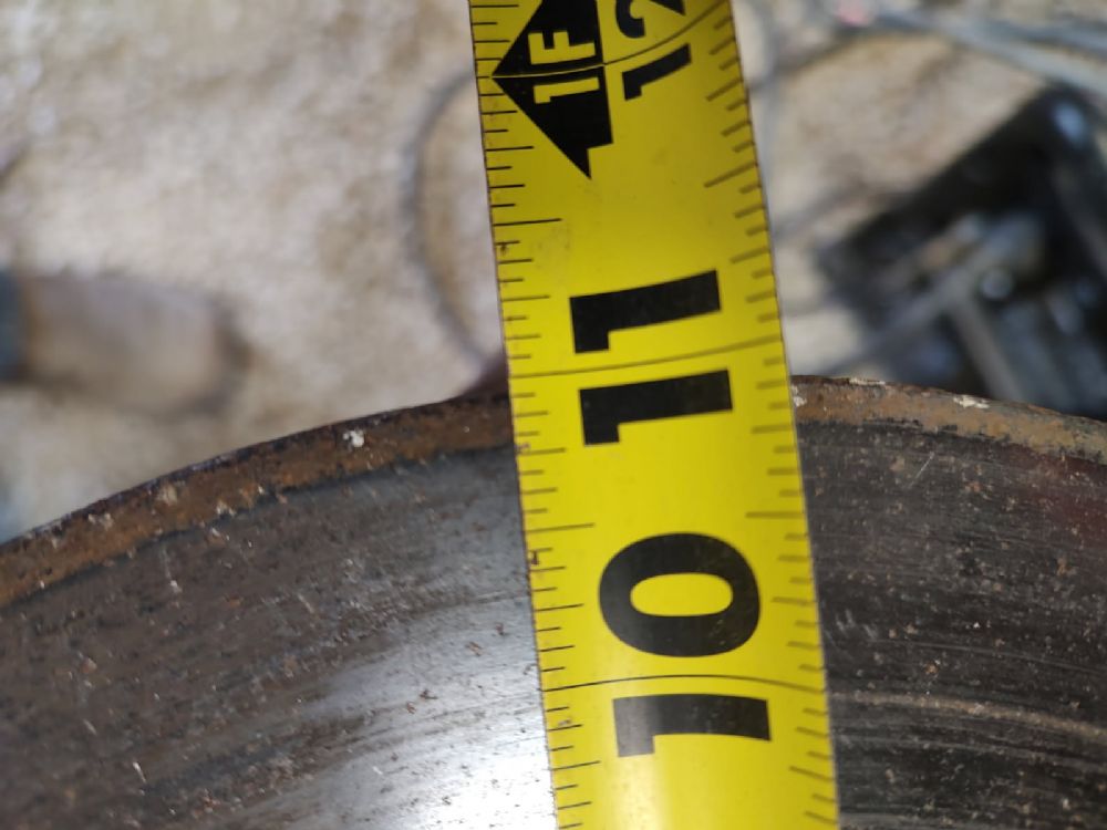

It seems to be right at 11" dia and 7/8" thick.
Gary
Post Options Post Options   Thanks (0) Thanks(0)   Quote 72 RS 351 Quote  Post ReplyReply Direct Link To This Post Posted: 18-March-2025 at 3:03AM
The stock rotors were more than an inch thick, and the sizes were generally under 11". Some OEM rotors were just under 12", most of those were 5 x 5" bolt patterned.

I thought it was a Granada rotor at first. but it's not. The dia, rotor thickness are the same but the distance from outer rotor surface to wheel mounting surface is to short. the rotors that are on it now I believe were re drilled to 5 on 5. and I think that is why they cracked. trying to get away from that. If they made a reasonable $ kit I would replace spindles, rotor, calipers.

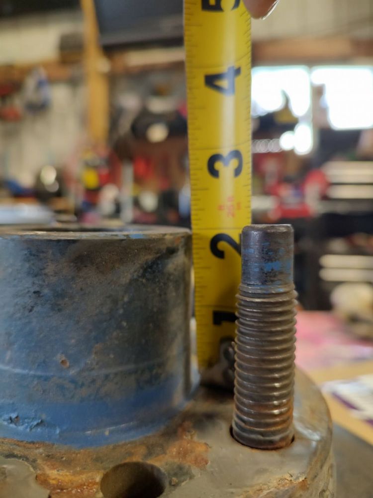

What's your rotor height? Granada doesn't use that inner bearing #

I will have to get that when I get home this evening along with other measurments.

1st thing i saw was the double bolt circle, redrilled from 5-4.5. some 1970's police applications used a near 12" rotor and a 5-5 bolt circle, caliper brackets may be different? if you can find a match aside from diameter maybe turn them down?

I'm trying to send these for my phone so hopefully they go through.
Gary
gburn View Drop Down
Joined: 17-March-2025
Location: 51532
Points: 22
Post Options Post Options   Thanks (0) Thanks(0)   Quote gburn Quote  Post ReplyReply Direct Link To This Post Posted: 18-March-2025 at 11:11PM
Let's try again.
Gary
Location: 51532
Points: 22
Post Options Post Options   Thanks (0) Thanks(0)   Quote gburn Quote  Post ReplyReply Direct Link To This Post Posted: 18-March-2025 at 11:14PM
Gary
Location: 51532
Points: 22
Post Options Post Options   Thanks (0) Thanks(0)   Quote gburn Quote  Post ReplyReply Direct Link To This Post Posted: 18-March-2025 at 11:15PM
#2
Gary
Location: 51532
Points: 22
#3
Gary
Location: 51532
Points: 22
Post Options Post Options   Thanks (0) Thanks(0)   Quote gburn Quote  Post ReplyReply Direct Link To This Post Posted: 18-March-2025 at 11:18PM
#4
Gary

Could cut the rotors down. I imagine anyone with a large enough lathe or brake lathe could do that easily. Or find and use the larger caliper bracket from a t-bird/police package, depending if the spindles where sourced from something that adapts and can use them.

Looks like a mid 70's Lincoln Mark series rotor to me, possibly even a 75-76 Tbird or Full size like a Lincoln Town Car/Mercury Grand Marquis since they all use 5 on 5 BC. Definitely modified to fit 5 on 4.5 BC. The calipers are the same, just use a different caliper bracket for the larger diameter rotor. IIRC, even the bearings are the same, fit intermediates as well, but it's been a while since I went all through this....like 12-13 years ago.
Post Options Post Options   Thanks (0) Thanks(0)   Quote Eliteman76 Quote  Post ReplyReply Direct Link To This Post Posted: 20-March-2025 at 1:28PM
Full sized mercury, ford and I want to say Lincolns 74+ used a 5x5 rotor. Spindle wise, I have swapped 72 Lincoln and early '73 Lincoln mark 4 rotors on the 72 Torino spindle.
Those rotors look like they were predrilled 11" rotors.
The mid-70's stuff with 5x5 were usually 12" rotors.
I have swapped 2000 Crownvic rotors onto my 1972 spindles, but I had help milling a set of '72 rotors into bearing hubs to use the 2000 crown vic rotors, and fabricated adapter brackets.
Not sure what class you are running in, but I'd tell you, look at a 77-79 Lincoln Mark 5. Rayobestos rotors are pretty reasonable, just have shipping on a pair of rotors.

I have finally gotten an exact identification on the spindles caliber rotors. They're off in 85 crown Vic. The upper ball joints are screwing style. Now I need to check specs to see if I can find a 5.5 bolt pattern hub and rotor that can be turned down to 11 in that will align with the caliper.
