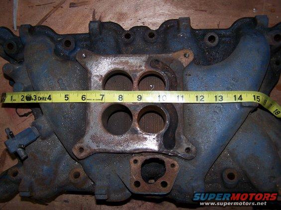

To this point, a previous owner put a stock Ford cast iron 4V intake on my 2V engine. Would it be worthwhile to put on an Edelbrock Performer 351-2V instead? Would I notice any difference in peak power or low-end torque or fuel economy or anything else? I'd want to stick with my Holley 600CFM vacuum secondary carb.

in the early days of the 351C before Edelbrock released the F351 #2750, sourcing a take-off factory cast iron 4V manifold and fitting it to the 2V engine was fairly popular. an old magazine article claimed the swap was good for 30-35 hp. whether or not you'd notice any difference i can't say, but in Cali i'd go with the Airgap manifold rather than the std performer. a lot of are disappointed by the smaller than port sized runners in the std performer, some guys make the alloy swap just for the weight savings alone. if keeping it stock appearing is important an Aus 302C manifold is an option (they have the 2V port size internally) but they're not extremely available and the choke stove piece (different from the US counterpart) is harder to find than the manifold itself. FYI there are at least 3 different 302C intakes, 2 spreadbores and a square flange that would suit your carb.
