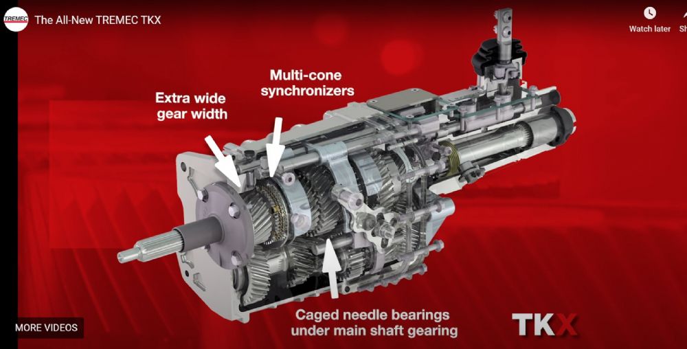

What is the TKX 5 speed from Tremec? The long of the short, it's the current aftermarket offering for folks wanting to step into the modern era, and give your ride more breathing room to run down the road without the joys of getting passed by a Prius at 80MPH spinning 4,000+ RPM in 4th gear.
So...you like doing fun smokey burnouts, but want to get better than single digit MPG?
Then you need to strongly consider stepping out of the last century and step into the modern world of 5 speeds. I'd bring up 6 speeds, but let's be honest. Most applications a double overdrive T-56 magnum is overkill unless you are turning 130+ speeds regularly.
Tremec's YouTube all-new TKX video https://youtu.be/EOqkR3K-Oz8?si=5Jp0xmCbtLBrRGCF

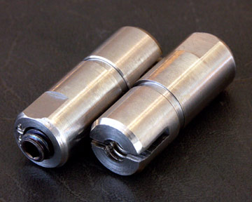

In case of runout issues, replacement adjustable 1/2" diameter dowel pins can be purchased from places like RobbMC:
RobbMC:
NOTE:
(From their site:
Bellhousing alignment is critical to ensure smooth shifting and maximum clutch life. The hole in the rear face of the bellhousing should be concentric with the crankshaft within .005" (.010 TIR).
Unfortunately, many aftermarket (and even some stock) bellhousings are not as concentric as they should be. This may be due to a problem with the bellhousing and/or the engine block.
Once the amount and direction of the misalignment are determined, offset dowels can be used to correct the problem. Unfortunately, a bit of trial and error is usually required to get the offset dowels pointed in the right direction.
At least two other companies currently make offset bellhousing dowels. Both brands make their dowels with a screwdriver slot which is to be used to rotate the dowels.
"Brand L" dowels are designed to be pressed into the block. Unfortunately they either fit so tight they have to be removed in order to rotate them, or they fit so loose they won't stay at the proper angle. (The instructions that come with the "Brand L" pins even state that the alignment must be rechecked every time the bellhousing is removed). "Brand L" dowels come in two sizes; one for GM and one for Ford/Mopar. The Ford/Mopar size is a compromise. This means they fit so tight in a Mopar engine block that they usually have to be pounded in with a big hammer and are nearly impossible to remove let alone rotate.
"Brand M" dowels slip easily into the engine but the block must be drilled and tapped in two places so that set screws can be installed to prevent the dowels from rotating once they are pointed in the correct direction. This is difficult at best and nearly impossible if the engine is still in the vehicle. "Brand M" dowels are available only for GM engines.
RobbMc bellhousing dowels are unique. They slip easily into the engine block and are designed to be turned with an open end wrench rather than a screwdriver. Once they are pointed in the correct direction, a screw (which runs down the center) is tightened which prevents the dowel from rotating. No need to pound the pins in and out. No drilling and tapping required. No need to recheck the alignment if the bellhousing is removed. Three sizes are available so they fit each engine correctly. Dowels are longer than stock so engine plates can be used.
Ford 1/2" Dowel Part numbers:
PN 1014 - .007 offset
PN 1015 - .014 offset
PN 1016 - .021 offset

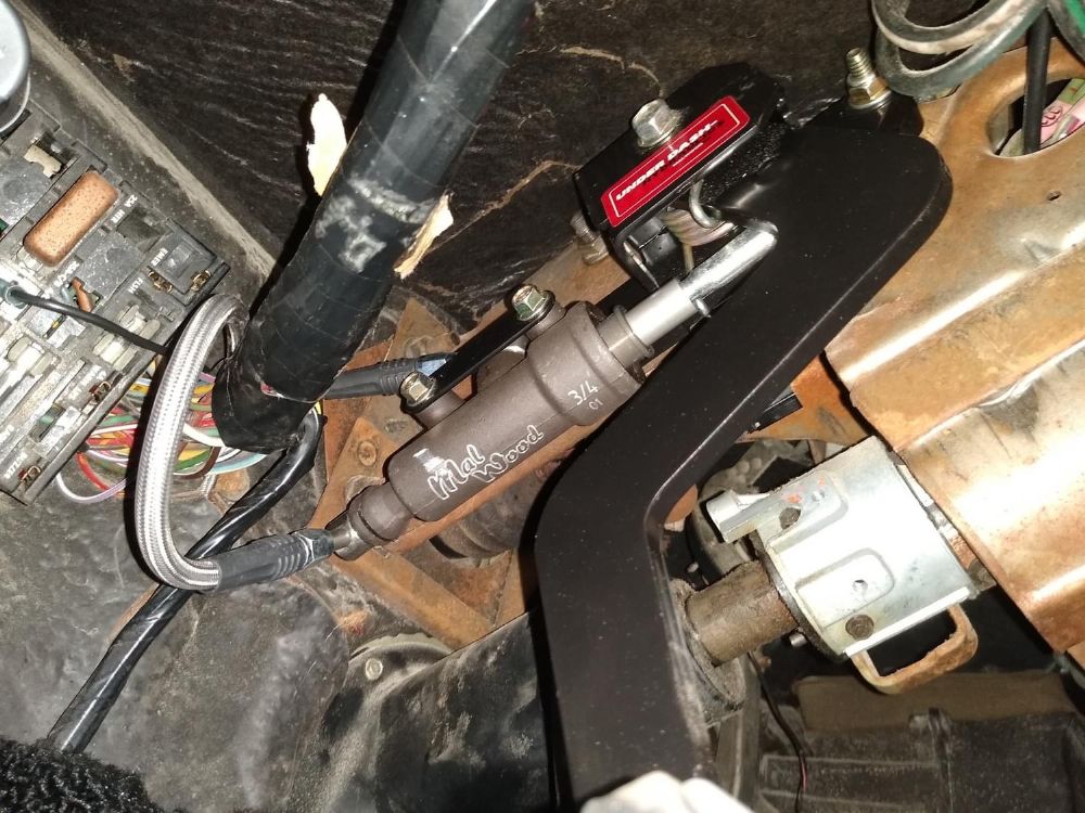

While it's possible to retain a stock mechanical linkage, upgrading to a hydraulic setup can be done! There are others that have done cable conversions as well.

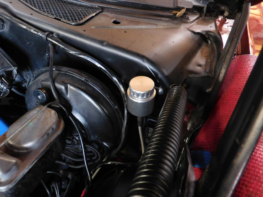

Malwood Clutch pedal was a clean bolt on, and the reservoir doesn't crowd the brake booster.
I will post more pics in my project thread, plus a rundown of the job here.

You were able to install the new clutch pedal assembly with the entire dash in place then ?!  That’s a huge win !!!!

Yeah, pretty straightforward, just remove the driver's seat.

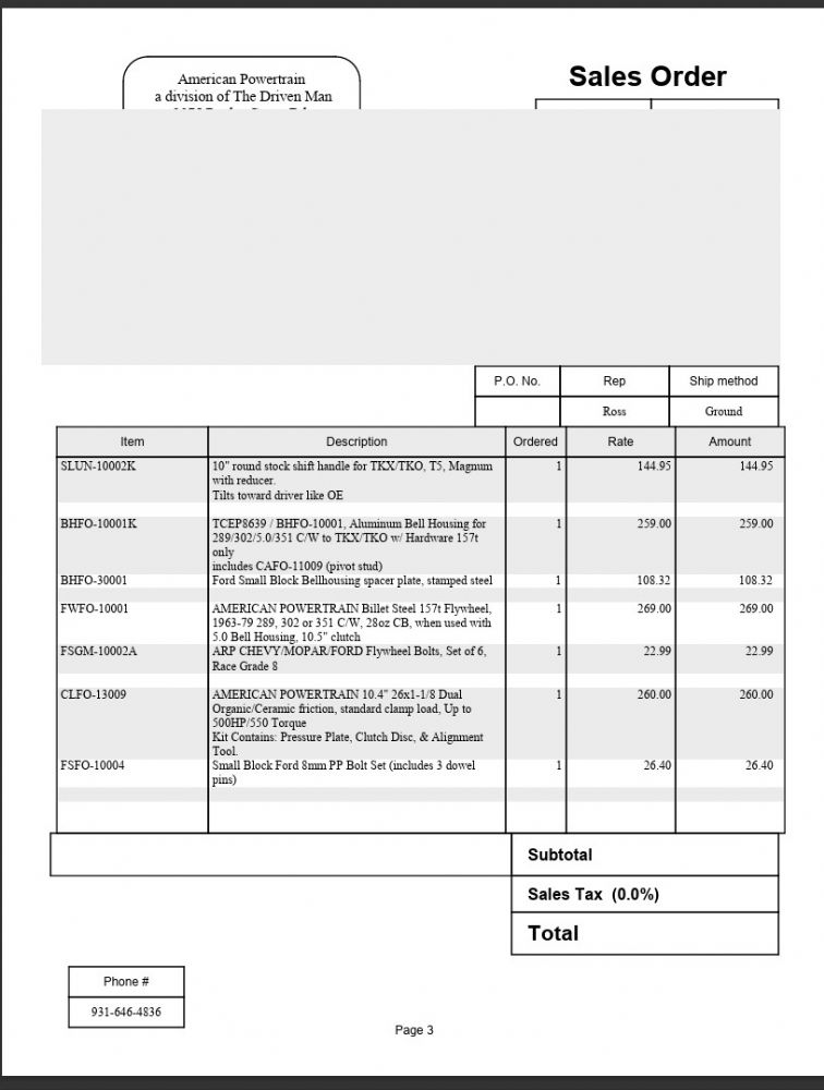

Shifter, what came with the Tremec. Edit: check the invoice below,
Just a rubber boot for now.

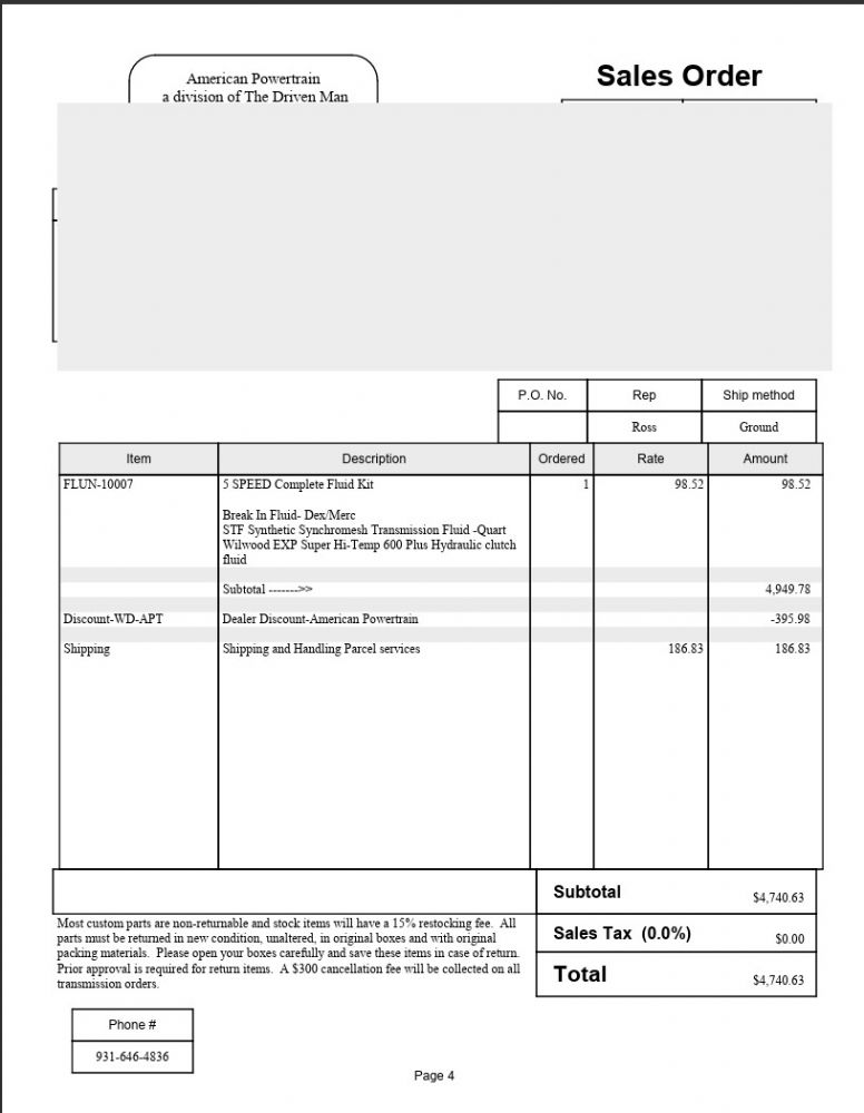

I think the setup I am using would work for a bench seat as well. I'll definitely know more when we finish.
I've added the sales invoices from American Powertrain and Malwood.
