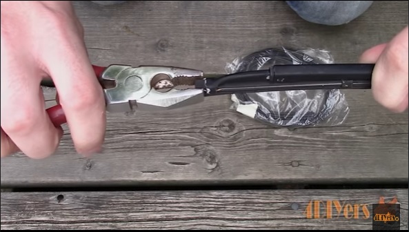

I just want to detach the blade. Apparently, you have to push in a spring on the side of the blade center portion and the blade will come off the pin.
My car has this type👇

push down on the coiled spring and they should slide off the arm stud... sometimes it takes a few attempts...
