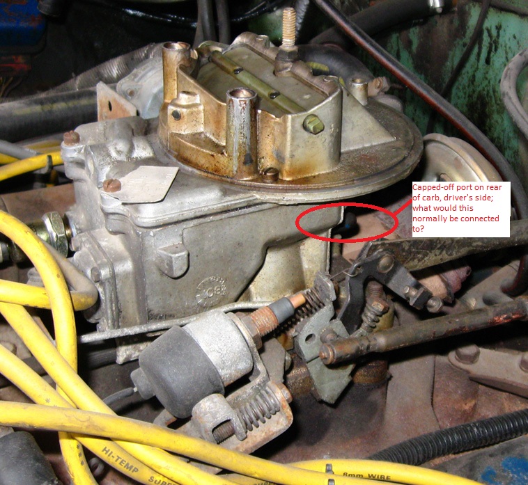

Oh, and it appears that my choke cold air inlet fitting on my RH exhaust manifold has been plugged by something. I can't tell if it's a solid plug or perhaps has a tiny orifice in it, but it's definitely not a fitting for a cold air tube! I'm betting that tube got taken off at the same time as the stovepipe.
Paul, do you know what the circled vacuum port is on the back of the carb in the above photo?

Post Options Post Options   Thanks (0) Thanks(0)   Quote Psquare75 Quote  Post ReplyReply Direct Link To This Post Posted: 29-March-2011 at 6:54AM
Originally posted by Turbo301 Turbo301 wrote:
Originally posted by Psquare75 Psquare75 wrote:
The missing stovepipe and heat shield are one issue.
That should only affect warm-up, though, not right when the car starts (exhaust isn't even hot yet) or after the car's warmed up (when the thermac would be open anyway), no?
It will affect cold weather drivability.
Quote Clockwise increases speed, Counterclockwise decreases. On a Holley 4bbl you have to go WOT (WITH THE ENGINE NOT RUNNING) to be able to really access the screw. Even then, it's guess work, 1/2 a turn at a time.
From what you've said, I'd probably try increases the fast 1/2 a turn and the cold 1/2 a turn, and note what it does. (this is kinda hard to do w/o a tach, FYI, You can always get a cheap one and wire it temporarily).
Yeah, I had my girlfriend hold the throttle open for me and that made the fast idle screw accessible, but I still couldn't see the cam to see where the heck it was relative to the screw. I'll try your 1/2 turn-at-a-time idea.
A local auto parts place has a timing light with built-in tach, I might get that and kill two birds with one stone. How should the timing be checked (warm, at idle, I'm assuming?), and what should the value be for a stock 302 (assuming correct idle speed)?
[/QUOTE]
Check the little sticker on your valve cover, it has all this info.

Post Options Post Options   Thanks (0) Thanks(0)   Quote GranTorinoSport Quote  Post ReplyReply Direct Link To This Post Posted: 30-March-2011 at 5:16AM
http://grantorinosport.org/BubbaF250/carb/carb01.html
This is the re-hosted 2150 carb information. I don't see that particular port identified on the webpage section, however you might want to look over the few pages that are there, it's pretty good stuff.
