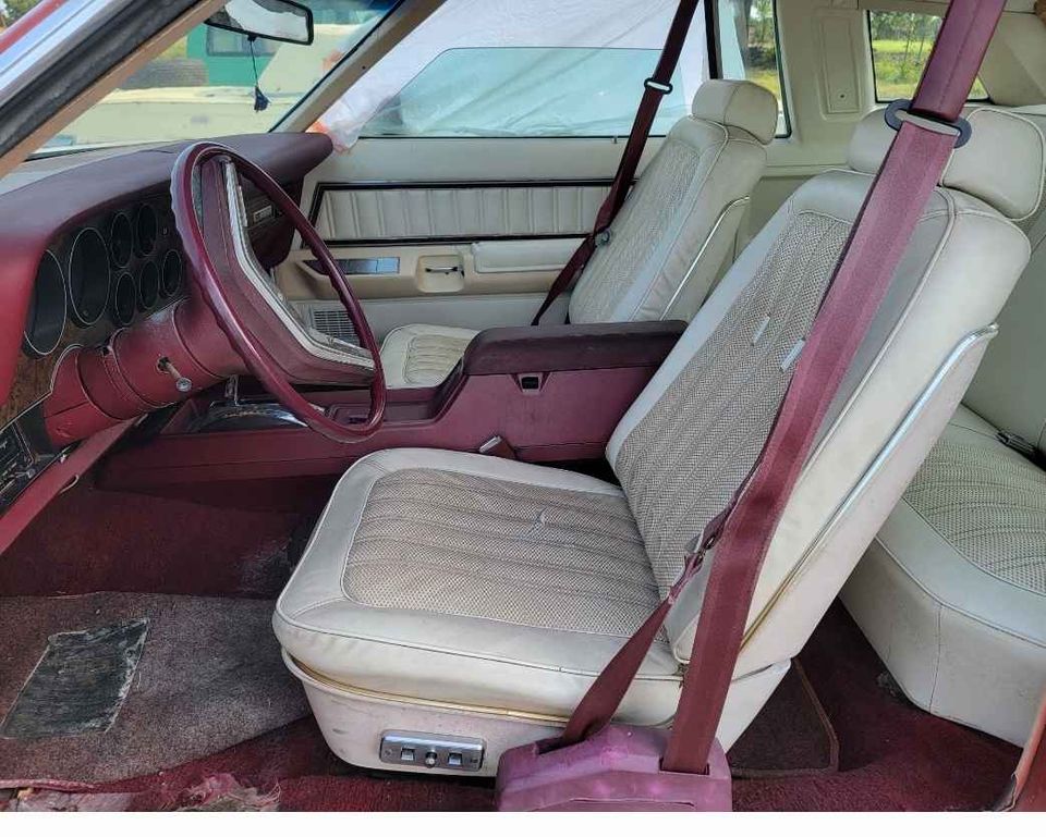

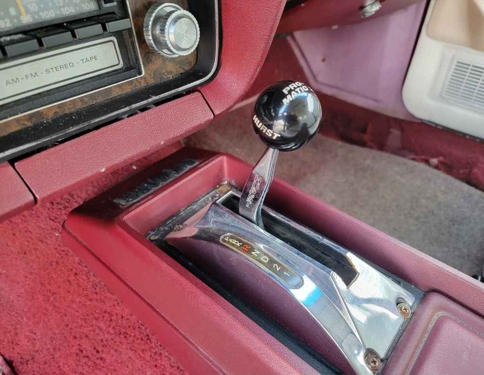

I recently purchased a [rusty] 79 Cougar XR7 351W (4bbl) to grab some parts for my 72 Gran Torino; mostly grabbing misc. bits. So far here is what I plan on grabbing, question is: "Are there any bits that I  should pull before sending this to become a beer can?" [I should also state that effort required to remove a part directly correlates to my desire to remove it]
  • Front seats and console.
  • Hurst ProMatic automatic shifter (will be sold).
  • Radiator, fan shroud.
  • AC system (all except the heater/ac box)
  • Wiper linkages.
  • Cluster, facia, harness
  • Alternator with harness
  • Misc kick panels and compatible trim pieces, speaker grills.
  • Radio, Switches, and misc electrical.
I will probably sell off the engine and trans as it seems healthy, but in dire need of seals and gaskets.
Specs: 351W aftermarket 4 barrel intake with elderbrock carb. FMX, data plate indicates FMX and 2.75 Open.
The baby moons are crazy wide, I'm not sure if they will stay on the car or go. (I don't need or want them)

Get the steering column and anything related to the floor shifter, brackets etc. Most interior parts are usable in almost all 1972-79 compatible chassis.
Post Options Post Options   Thanks (0) Thanks(0)   Quote peter.jenerette Quote  Post ReplyReply Direct Link To This Post Posted: 14-February-2024 at 6:03AM
Its a column shift converted to a floor, so, I've (to this point) opted to leave it behind, unless for some reason i want to pursue the cruise control, which seems to be intact.

CC would be nice on my Gran Torino. Does it have Automatic Temperature Control? I could use those parts to convert my manual A/C. Seats seem nice
