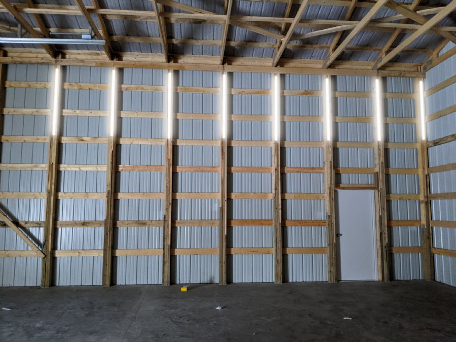

I've got a new shop to outfit as well and was thinking LEDs strips would be good over florescent tubes.
I do have a bit of an issue with the garage door though, it's an 18' wide and 12' high, so when it's open it covers more than half the ceiling real estate.
Anyone tried mounting LED lights vertically on the walls?  I'd think it might work better for working under the hood instead of overhead lights.

I did mount 4 ft.. strip lights along both sides of the garage. That was at the place I just moved from. I found that two strips on each side lit up the garage nicely.. They were converted to LED. I'm getting ready to do the same thing at the house I just bought.
  Newer strip lights have electronic ballasts. That makes them completely LED compatible.

I mocked up what I was thinking, but will have to buy a few lights and see how directional the LED strips are.  I might have to instead run them on the wall but horizontally and angled towards the floor.
Has anyone got just the LED housings, or just done the florescent housing with a LED bulb?

you have to be sure to check if the are ballast vs. non-ballast, etc....some are interchangeable and other are not.

I found some APL Akron LED shop lights at princess auto on sale for $30 so bought a few to test with.
They are bright as heck, but they do for sure cause radio interference.  When the radio is plugged in close to the lights (also on the same breaker circuit) I get fuzz with one light on, and lose all signal with two.
