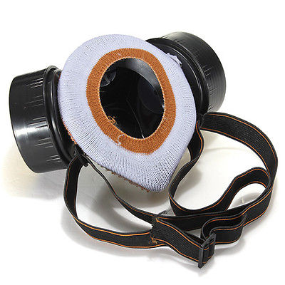

We have done many long searches on this subject, but we could not find any answers. There are two pictures below, of a respirator that my friend has found for sale. He is only going to paint one vehicle. do you think that this respirator is good enough?
The advertisement for this respirator says:
This is a quality industrial chemical respirator for automotive and industrial painting and organic vapors of low toxicity. Great for filtering small dusts, mists, metallic fumes, spray paint, chemicals.
Features:
Brand new and high quality double cartridges respirator mask
Designed to protect you from breathing in dust and fine powders
Dual gas cartridges for spray painting and organic vapours of low toxicity
Dual cartridge system can be replaced with different cartridges for acidic gases or other chemical vapors
The soft nose and mouth cover will fit all users
Dual strap system adjusts easily for comfort
Glasses size (L X W): Approx.7.4 x 3.14inch / 19 x 8cm
Mask size (L X W): Approx.7.0 x 4.7inch / 18x 12cm
Material PVC + Active Carbon + PC
Package Includes:
1 x Respirator Mask
1 x Glasses
Thank you for any answers that you can give to us.

At a minimum, you want a HEPA/Organic vapor cartridge on the respirator. A pre-filter over the cartridge is a good idea, to keep droplets of paint out of the filters. That cloth around the edges on the one in the picture is a problem. You need to get a good seal.
If you are using an isocyanate based hardener, a supplied air full-face respirator would be ideal, but you need a compressor or a cascade system to supply air. The full-faces are awkward if you aren't used to them and restrict your vision, but they are positive pressure and also keep crap out of your eyes.
That being said, in a well-ventilated area, I have used half-face respirators with hepa/organic filters for isocyanate based hardeners, and when I was young (and indestructible) I sprayed a lot of lacquers without any respirator (VERY BAD IDEA).
