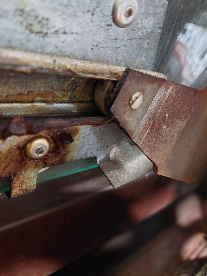

1.  In the first picture, the little white plastic roller is missing from the passenger side window regulator.  Does anyone know a part number for the roller?  I can only seem to find a square one.

the square roller piece works just fine i have them in my car! dorman/help product easy replacement ... just grind the end of the original rivet off flush and remove the original the replacement bolts in Wink no need to remove the regulator or the window! just crank it down to access it through an opening use a 2x4 or something to hold the glass up out of the way, slide the new roller in the channel and lower the glass by hand and pull the arm back enough to get the bolt into the hole put the nut on and tighten...Wink
Thanks for the info!  I'll order one of those then
