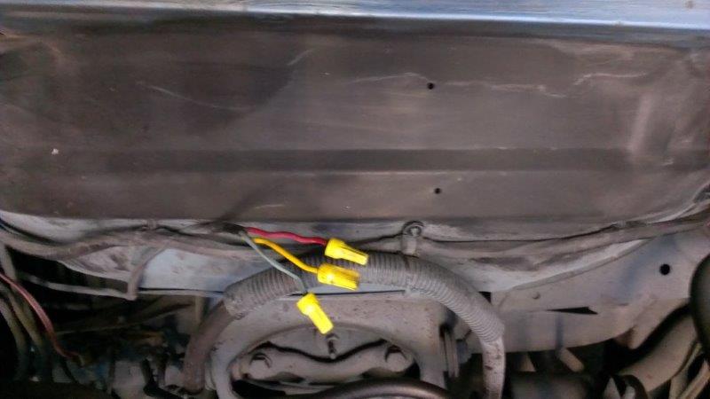

It seems l don't have a washer pump for my windshield, BUT l do have three very thick wires ( Yellow, Red and Blue),nicely capped and sitting on the inside drivers fender.
Would these three big wires, be the washer pump wires, I haven't yet tested if they are 12 volts when the washer pump is turned on.

Post Options Post Options   Thanks (0) Thanks(0)   Quote aquartlow Quote  Post ReplyReply Direct Link To This Post Posted: 16-April-2015 at 12:30PM
The wire colors are BLACK and BLACK/WHITE STRIPE for the washer pump(at least for a '79). I do not have a '72 Ford shop manual. Seeing how there are wire nuts installed on the wires, are the wires solid or stranded?

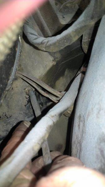

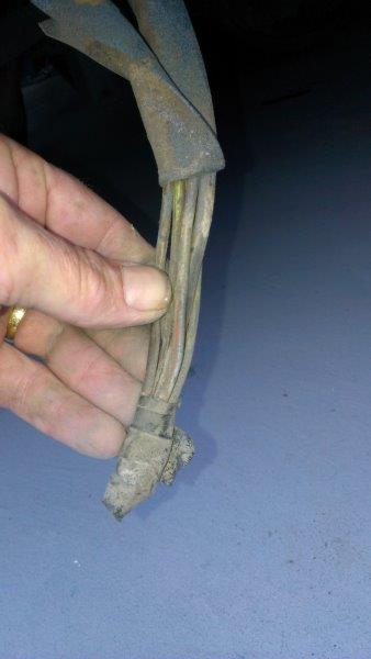

I think l have found the real washer pump loom, stashed up under the side marker light.
Black and a black and white stripe.
The other three heavier wires are strand type, l tracked them back to the firewall. see pics.

Post Options Post Options   Thanks (0) Thanks(0)   Quote 72FordGTS Quote  Post ReplyReply Direct Link To This Post Posted: 16-April-2015 at 2:52PM
Your bottom picture is the connector for the washer pump.

Post Options Post Options   Thanks (0) Thanks(0)   Quote aussie_dave Quote  Post ReplyReply Direct Link To This Post Posted: 16-April-2015 at 3:08PM
The heavy yellow wire is hot all of the time, cant figure out what the red and blue with stripe are, they have no power at acc or ign?
I have found yet another problem with the washer system!!!
I have no squirter's/jets or lines running up to it.
Any routing directions, l cant find a hole where the water line into the air plenum should go.
My ideas below..see pic... yellow circles are the possible locations, the blue arrow is the centre line.
Can you advise if l'm close?

Post Options Post Options   Thanks (0) Thanks(0)   Quote aquartlow Quote  Post ReplyReply Direct Link To This Post Posted: 16-April-2015 at 3:15PM
BINGO,
 In the last pic, you found the windshield washer pump wiring plug!

Post Options Post Options   Thanks (0) Thanks(0)   Quote 72FordGTS Quote  Post ReplyReply Direct Link To This Post Posted: 16-April-2015 at 3:32PM
I'll have to check on the red and yellow wires.  The wiring diagram will help you out on that though.
As for the squirters, they are on the bottom of the hood.  They are little metal nozzles and you route the hose along the fender to the firewall to the hood where it splits into two lines, one for each nozzle.

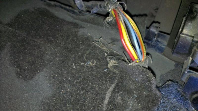

Post Options Post Options   Thanks (0) Thanks(0)   Quote aussie_dave Quote  Post ReplyReply Direct Link To This Post Posted: 16-April-2015 at 6:31PM
The three heavy wires ( Red, Blue with stripe and Yellow-with power constant),travel from the inside fender, thru the firewall, under the pressed steel plate under the drivers feet, out thru the corner behind the drivers seat, past the 3 ford alumin relays and towards the back of the car along the drivers side???
At this point,it appears to be factory,all the yellow three pin plugs match the other plugs under the dash !!!

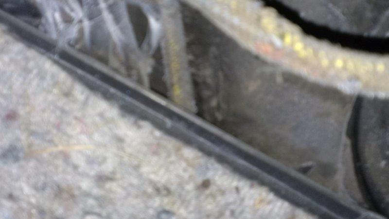

Post Options Post Options   Thanks (0) Thanks(0)   Quote aussie_dave Quote  Post ReplyReply Direct Link To This Post Posted: 16-April-2015 at 9:57PM
This loom comes out and disappears inside the taillight cavity and disappears under the back of the car where the tow bar is.
Hmmmm! so what does it do?, yellow is constant power, Red, does nothing that l have been able to tell as does the blue wire???

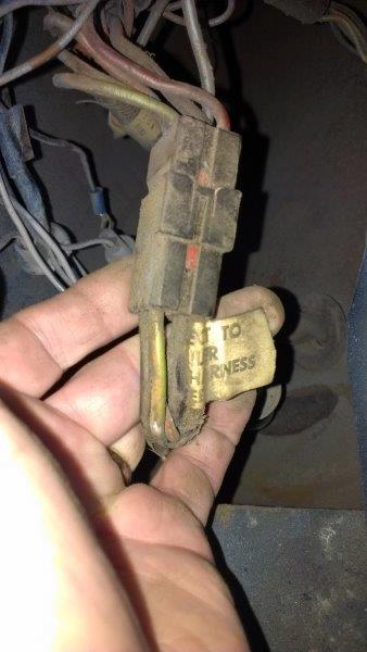

Post Options Post Options   Thanks (0) Thanks(0)   Quote aussie_dave Quote  Post ReplyReply Direct Link To This Post Posted: 18-April-2015 at 11:32AM
The wires appear to be factory installed, behind the drivers seat, the wires are in a loom with tail light wires and housed in a mesh nylon type material that l easily pulled apart ( age) to take the pic above.
Seat motor wiring, l'm guessing not, there is no exit point at the seats, yes the loom travels to a grommet in the taillight cavity.. see pic from inside taillight cavity and under back.
Q/ -if trailer wiring,why only three heavy wires and only one powered?.. and powered for what?
My guess is the factory label on the loom ( in the tail light cavity )gives the answer, ???????? TO TRAILER HARNESS.
