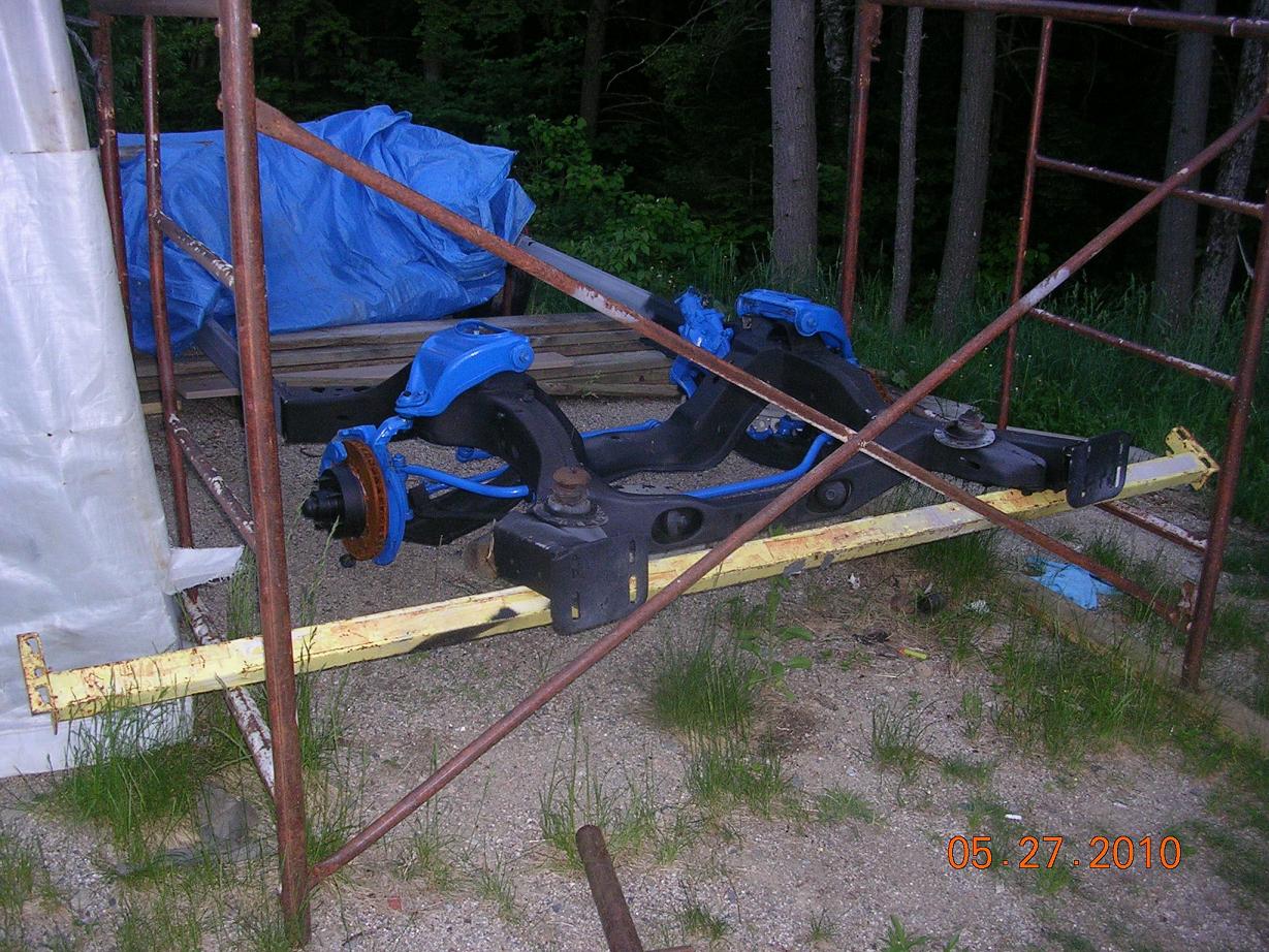

  Good thing that when I did my frame I left the rotted out rad mounts on it. Went thru sandblasting / POR / primmer / and undercoating. Everything from front to rear was removed except them. Left them because I was unsure ! Now I am putting new stuff and theyre still sitting there waiting ???
