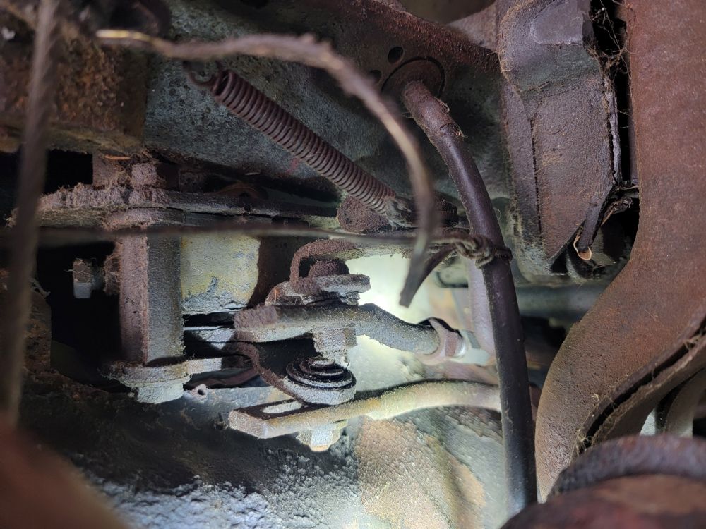

somewhere along the line my 72 Sportsroof acquired an extra genuine Hurst shifter arm, these are the Ford style linkage rods, the Hurst rods are threaded for adjustments

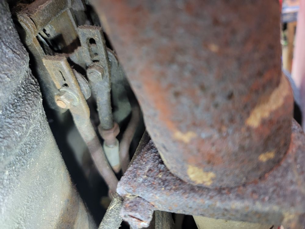

here's my tail housing, forward shifter mount bolt pattern is used, you can see the unused rearward casting boss behind the bracket. the David Kee page has great pics of all the tail housings
and a pic by the Late Great Dan Wessman of his complete assy

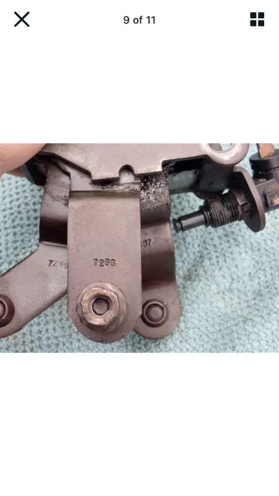

Post Options Post Options   Thanks (0) Thanks(0)   Quote Yellosn Quote  Post ReplyReply Direct Link To This Post Posted: 14-May-2023 at 5:51AM
The reverse light switch bracket is part of the shifter assembly. Hope this pic helps.

Post Options Post Options   Thanks (0) Thanks(0)   Quote Yellosn Quote  Post ReplyReply Direct Link To This Post Posted: 14-May-2023 at 8:58AM
I believe that is the ford/hurst shifter.

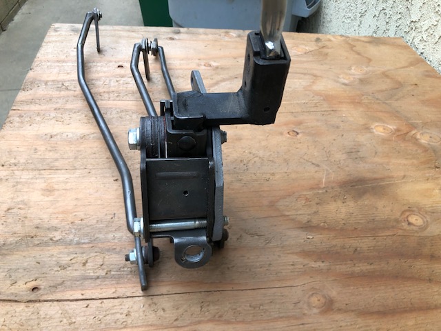

Pminkus3 , are you still looking for the shifter for the toploader?
I have the correct factory Hurst shifter with the step back bracket , and its been reconditioned.
let me know and ill try to get some pics up shortly

Post Options Post Options   Thanks (0) Thanks(0)   Quote TorinoJet Quote  Post ReplyReply Direct Link To This Post Posted: 08-January-2024 at 10:56AM
I guess I dont know how to include pics to this reply. I dont see the add attachments option.
if youd like to send me a direct message maybe I can do it there, or I can email driect to you or text to you
I think im figuring out how to attach pics now

Post Options Post Options   Thanks (0) Thanks(0)   Quote TorinoJet Quote  Post ReplyReply Direct Link To This Post Posted: 08-January-2024 at 11:27AM
Pminkus3 I just sent you 2 private messages with multiple pics, price and info
