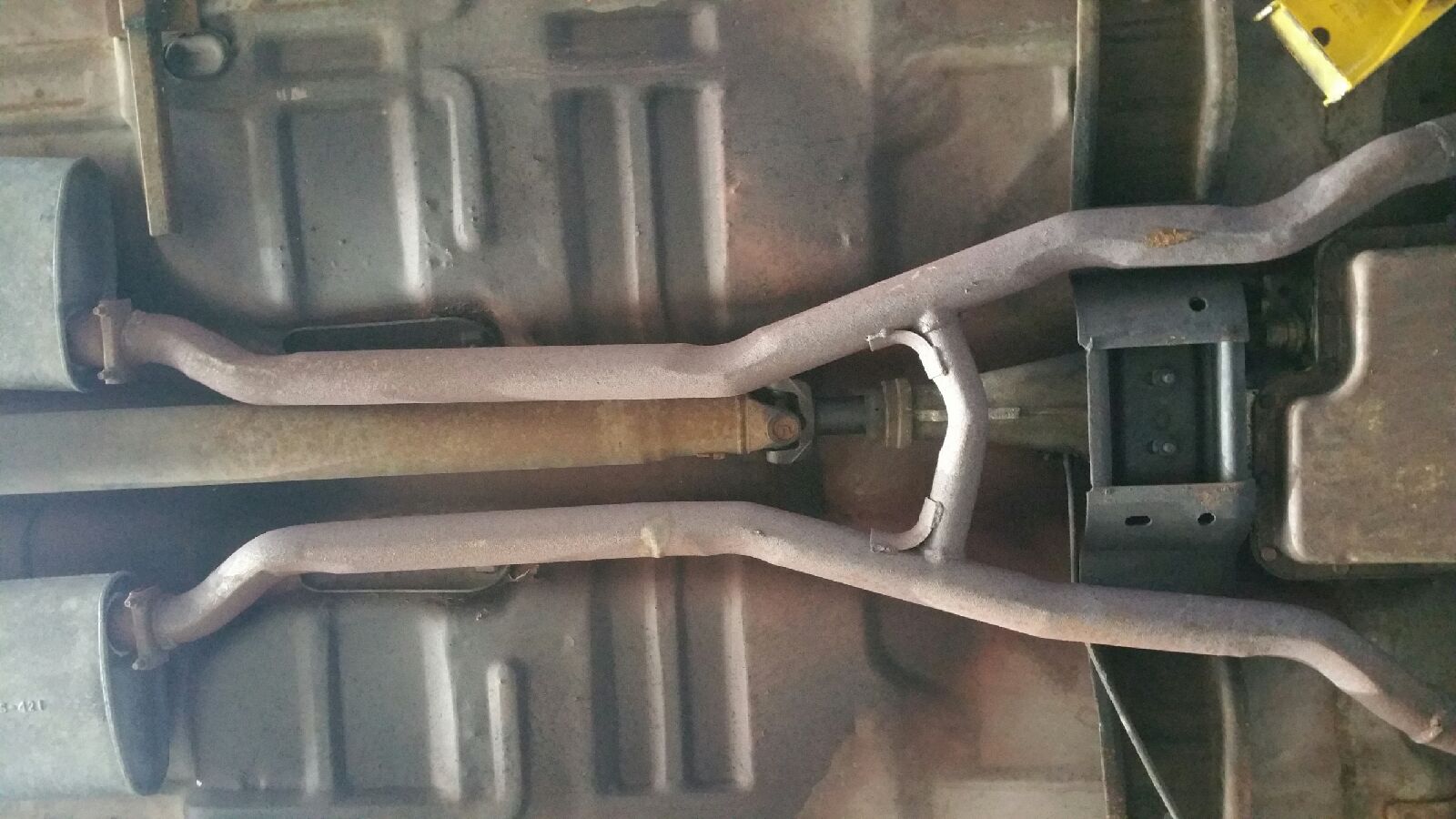

Has anyone ever come across a 460 H pipe like this.............
What I find crazy is the gussets where the crossover pipe intersects the exhaust manifold to muffler pipe. Is this factory????

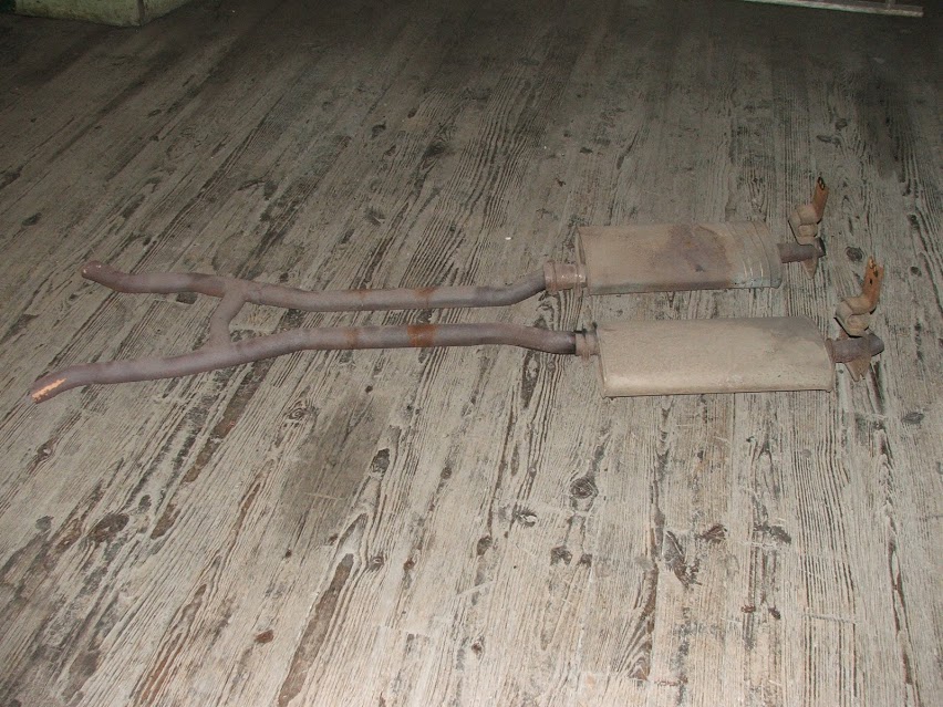

CJ cars in 1972 (at least) had the H pipe. I still have a couple of originals set aside.

My 73 still has the original H pipe on it!
One of Fords better ideas!

Do any of the original H pipes have those gusstes as shown in the first picture??
Post Options Post Options   Thanks (0) Thanks(0)   Quote unlovedford Quote  Post ReplyReply Direct Link To This Post Posted: 06-March-2015 at 6:45AM
None of mine do. However, I would guess as the years progressed, they may have added them for reinforcement.

Post Options Post Options   Thanks (0) Thanks(0)   Quote 73 Baby Gran Quote  Post ReplyReply Direct Link To This Post Posted: 06-March-2015 at 2:17PM
No, mine doesn't. It's all packed away till the snow goes away to take a picture!
