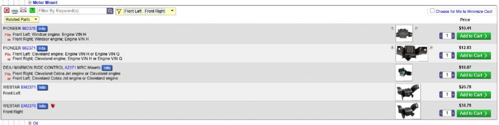

Hi folks, I thought I had bought good motor mounts (just the cheapo Pioneer brand off rockauto), but this forum made me aware that the mounts are not interchangeable side to side for a 351W. I bought two of the same part number (# 602370), does anyone know which side the Pioneer brand bolts to and which part number below would be correct for the opposite side?
Many thanks! Smile
edit: looks like the image uploader is compressing the screenshot beyond recognition, the link to the motor mounts is here
Post Options Post Options   Thanks (0) Thanks(0)   Quote Rockatansky Quote  Post ReplyReply Direct Link To This Post Posted: 02-January-2026 at 9:03AM
there are 2 basic part numbers, 2370 and 2371
you'll need 1 of each for a set of mounts
maybe the Westar listings are correct for orientation?

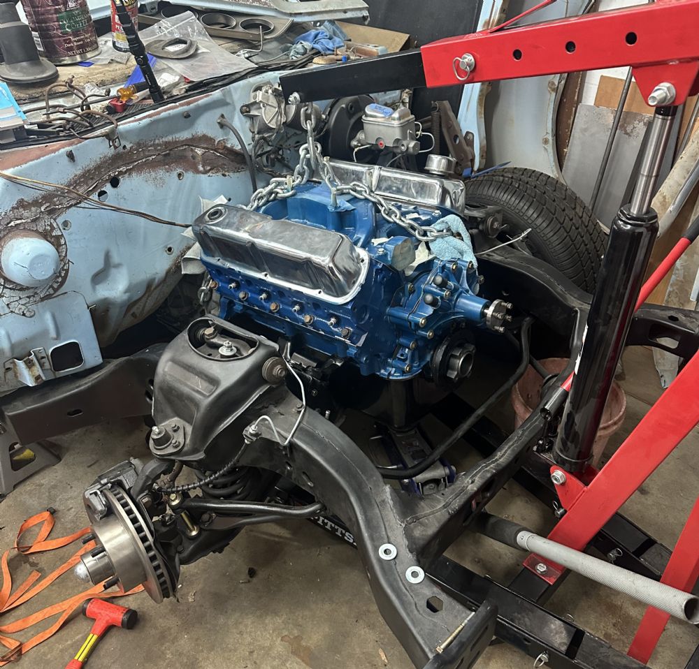

I wanted to give a follow up for future installers of these aftermarket motor mounts.

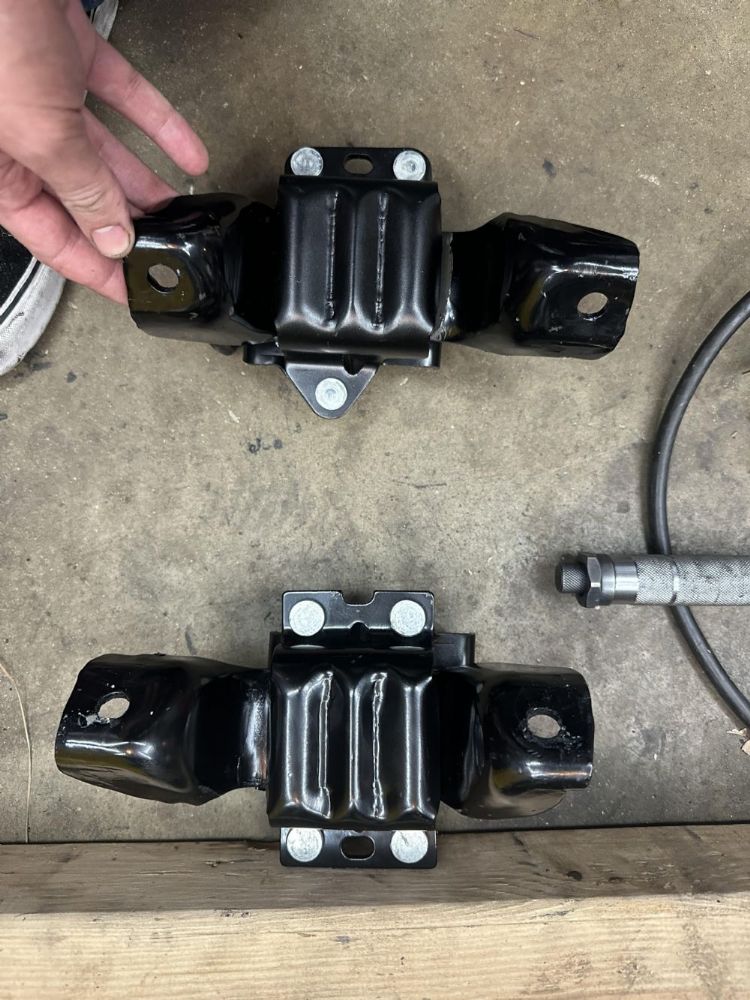

I ended up using Pioneer 2370 on the driver side (4 rivets) and Westar 2371 on the passenger side (3 rivets). Westar 2371 had 7.25" motor mount spacing and had to be ground open to fit the 7" motor mount spacing on the block.
This is the opposite of what the part numbers claim, but I don't think the motor mounts side to side matter that much, at least as long as the holes don't line up correctly enough to actually bolt the motor in. I'm sure if you had two 2370's you could make it work just fine.
The passenger side required quite a bit of modifying (cutting, grinding, eventually tying a ratchet strap to the frame to get it far enough into position) to make work.
From the facebook group, I've learned that these aftermarket motor mounts don't fit correctly on the passenger side crossmember -- the hole exiting the front of the passenger side frame sits about a half inch lower. I've heard that NAPA may carry a set of motor mounts that DO fit correctly, but all that my local NAPA had was upcharged rockauto Pioneer brand.
I think a set of old motor mounts is the way to go. These took a lot of patience with a dremel to fit correctly.
Motor mounts, passenger side (2371) on top:

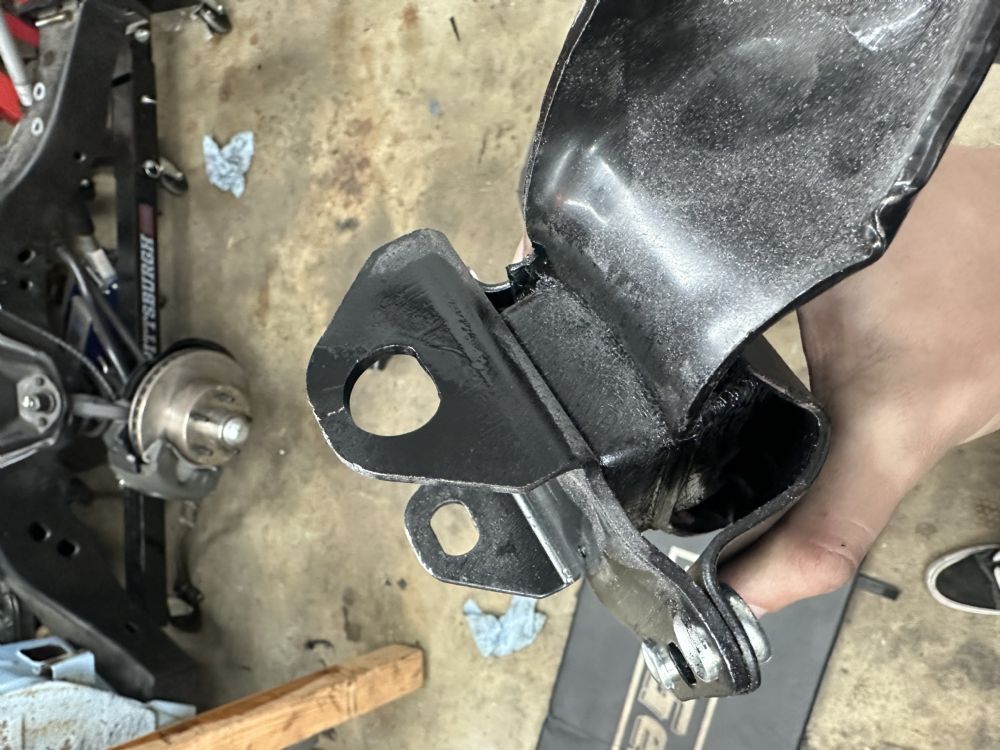

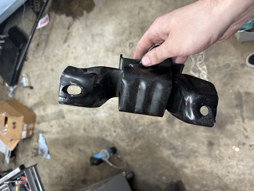

Here's the passenger side motor mount after modifying with the elongated hole:
Just one hole on the frame side of the mount needs to be enlarged to make it fit (the passenger side motor mount facing the front of the car), you can see it here against the stock size hole:
With enough wrestling the motor is living in its new home!
