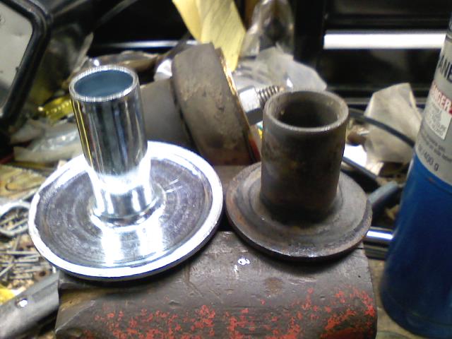

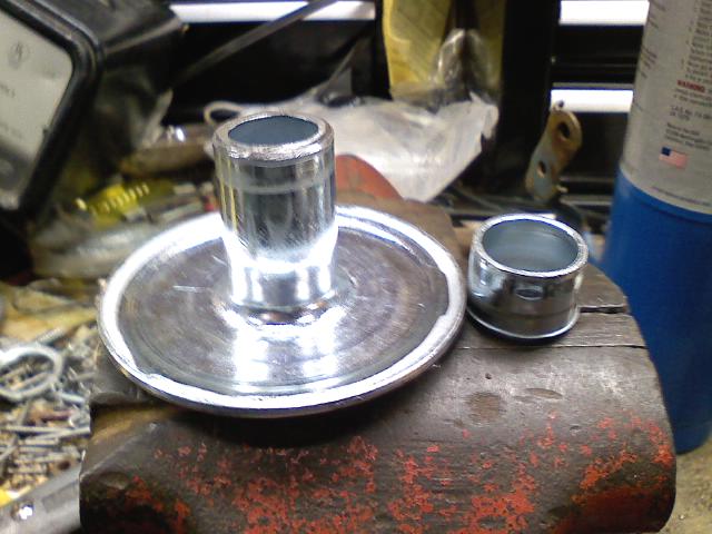

Big smileI HAVE FINALLY COME UP WITH THE PERFECT MOUNT.
Follow this topic and then read my conclusion!
CONCLUSION:
OK, here it is.........................
Buy 10 body mounts for a 2003 - 2009 Ford Crown Victoria with a 2006 part number.
THE PART NO's. ARE (UPPER MOUNT)6W1Z-5400396-A AND (LOWER) 6W1Z-5C155-AA. YOU CAN ORDER THESE PARTS WHOLESALE THRU BOB UTTER FORD OUT OF TEXAS.
Take the center "tube" (shiny one) and cut it down with a tube cutter to 1 1/4". The ugly one is the old one for comparison.
Here is a pic of it cut.
Don't forget to dress on the grinder.
This is why you have to cut the tube...........
The new one on the left is too fat between the body and frame. This will change after you cut the tube.
This is it in the frame and at stock height.
The best part as you can see is I am able to reuse the original bolts. Just clean up and coat with Loctite.

This is the mount on the frame and it is completely tight as if bolted
to the body. You will notice the big washer that I used under the nut
in place of the body. It is the exact size as original. I guess this is the
before shot. I can't do the after shot 'til later down the road.Approve
