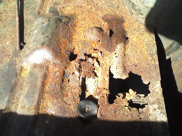

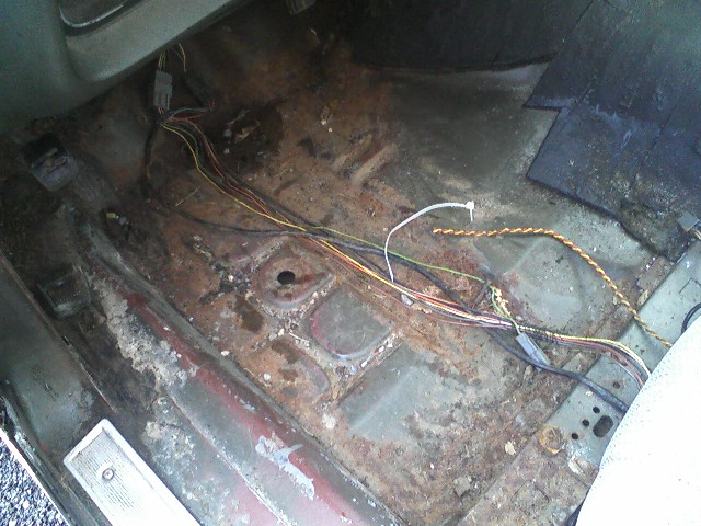

Post Options Post Options   Thanks (0) Thanks(0)   Quote californiajohnny Quote  Post ReplyReply Direct Link To This Post Posted: 03-November-2013 at 9:45AM
this is about the worst of the rust drivers side rear floor

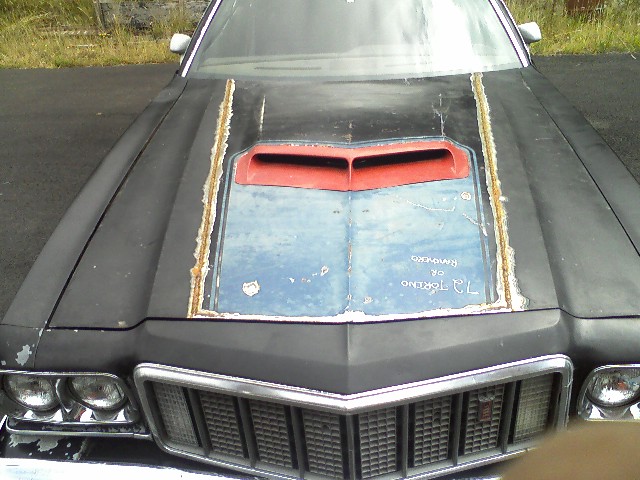

72 gts donor hood
Edited by californiajohnny - 15-December-2014 at 5:48PM
Points: 14215
Post Options Post Options   Thanks (0) Thanks(0)   Quote californiajohnny Quote  Post ReplyReply Direct Link To This Post Posted: 03-November-2013 at 10:07AM
section that was removed to be grafted
Points: 14215

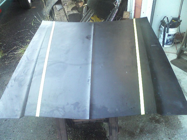

Post Options Post Options   Thanks (0) Thanks(0)   Quote californiajohnny Quote  Post ReplyReply Direct Link To This Post Posted: 03-November-2013 at 10:10AM
my 74 hood marked to be cut
Points: 14215
Post Options Post Options   Thanks (0) Thanks(0)   Quote californiajohnny Quote  Post ReplyReply Direct Link To This Post Posted: 03-November-2013 at 10:12AM
finished graft:
Edited by californiajohnny - 15-December-2014 at 5:49PM

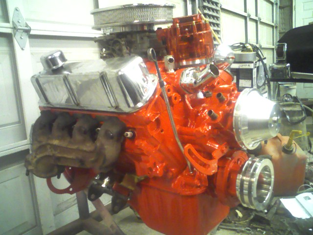

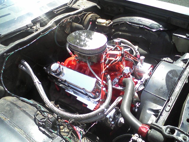

engine ready to go back in. fixed leak in pan, heavy duty oil pump shaft, new performance cam & lifters, roller tip rockers, offy intake manifold, new holley 450cfm carb, billet pulleys, and paintedThumbs Up

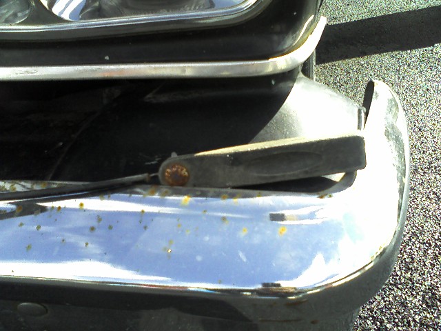

here's a closeup of that"state of the art" hood release when i first got the car (it's a carpenter's T bevel)Confused some people just shouldn't work on cars!

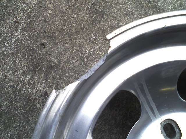

Post Options Post Options   Thanks (0) Thanks(0)   Quote californiajohnny Quote  Post ReplyReply Direct Link To This Post Posted: 03-November-2013 at 12:47PM
this happened while mounting the front tiresAngryAngryAngry

Post Options Post Options   Thanks (0) Thanks(0)   Quote GTW Quote  Post ReplyReply Direct Link To This Post Posted: 03-November-2013 at 12:51PM
Other than security, that's a decent quick fix.

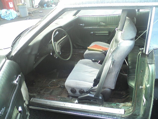

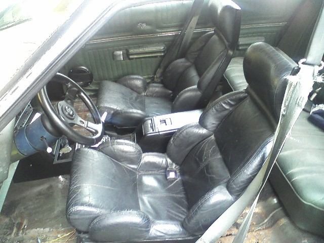

these are the front seats that were in the car, i have no clue what they are out of??
all i know is they are OUT OF my car now.
Points: 5777
Post Options Post Options   Thanks (0) Thanks(0)   Quote GTW Quote  Post ReplyReply Direct Link To This Post Posted: 03-November-2013 at 12:55PM
Looked to be out of a 90's FoMoCo
Retired 60s NHRA Anglia

Post Options Post Options   Thanks (0) Thanks(0)   Quote californiajohnny Quote  Post ReplyReply Direct Link To This Post Posted: 03-November-2013 at 12:58PM
NOT MY HANDYWORK! it has since been changed. but i thought others may fine humor in that

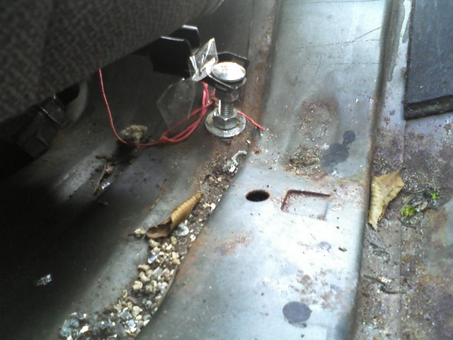

here's how the seats were mounted

this is what i have now 90 c4 power 6 way leather vette seats

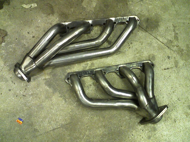

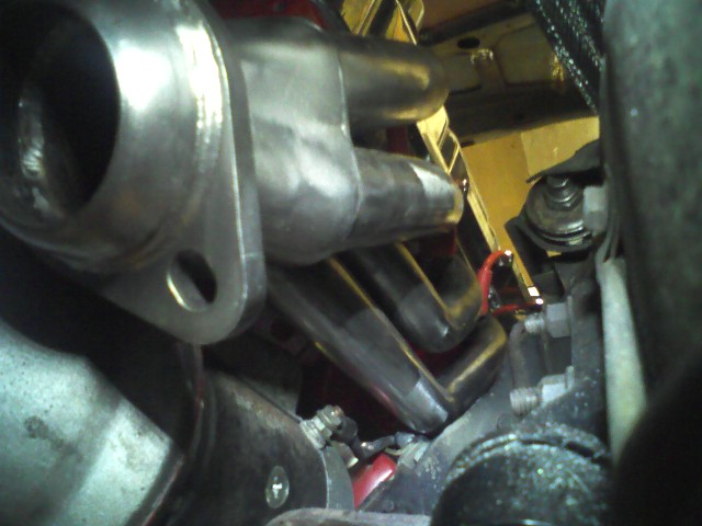

got my headers today! JBA #1653S
Points: 14215

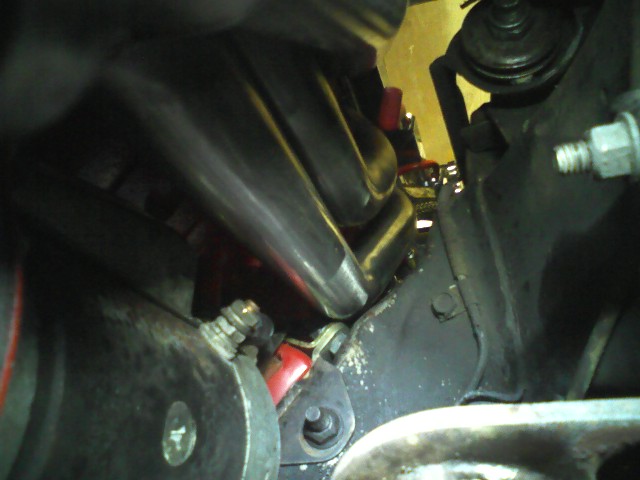

Post Options Post Options   Thanks (0) Thanks(0)   Quote californiajohnny Quote  Post ReplyReply Direct Link To This Post Posted: 26-November-2013 at 4:43PM
time to check the fit. i got them in raw stainless steel 409grade in case i need to make minor mods then have them ceramic coated
Edited by californiajohnny - 15-December-2014 at 5:54PM
Points: 14215
Post Options Post Options   Thanks (0) Thanks(0)   Quote californiajohnny Quote  Post ReplyReply Direct Link To This Post Posted: 26-November-2013 at 4:50PM
two minor mods to the passenger side, not to the header, but to the aod bellhousing by the upper starter bolt area. BEFORE MODIFICATION.
Edited by californiajohnny - 15-December-2014 at 5:55PM
Points: 14215
Post Options Post Options   Thanks (0) Thanks(0)   Quote californiajohnny Quote  Post ReplyReply Direct Link To This Post Posted: 26-November-2013 at 4:53PM
AFTER MODIFICATION, grind off about 1/8" inch of the tab above the  starter bolt, on the side of the tab.
Points: 14215
Post Options Post Options   Thanks (0) Thanks(0)   Quote californiajohnny Quote  Post ReplyReply Direct Link To This Post Posted: 26-November-2013 at 4:57PM
2nd mod, the rear corner of the motor mount  BEFORE
Points: 14215
Post Options Post Options   Thanks (0) Thanks(0)   Quote californiajohnny Quote  Post ReplyReply Direct Link To This Post Posted: 26-November-2013 at 5:01PM
AFTER:
grind the edge corner of the mount by the bolt ( may not need to do this if using stock mounts)
Edited by californiajohnny - 15-December-2014 at 5:57PM
