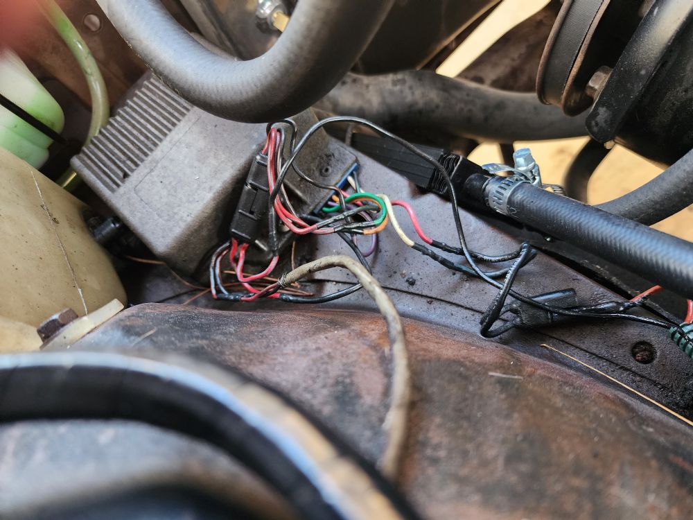

So I was poking around at the wiring to see if I could find the 12V keyed power source. Came to find out that the red and very light green wire was still hooked to the coil (looks like the original yellow top), and wires were run from the + and - terminals across the engine inside a loom down to the Duraspark module next to the washer fluid reservoir, spliced into the wiring on it. The other colors were hooked to some kind of generic four-wire plug, and two wires from that were hooked to two conductors in what looks like a 6-foot length of telephone wire, run along the fender, up and over the brake booster, and up to the front of the engine where it was spliced into the distributor. I thought one would want to run thicker gauge wire than telephone wire to trigger the distributor. When I tested the wire from the ignition, it read over 12V, but I think the resistor wire only drops voltage under a load, so a multimeter checking it with the engine not running will show battery voltage instead of a lower number. So I think the Duraspark system might have been running on reduced voltage AND the distributor was being served by thin-gauge wiring. Am I right in being surprised the prior owner's hack job worked and never left me stranded?

Here is a picture of the wiring for the Duraspark box. The power wires are connected to the + and - terminals at the coil, and come in through that blue wire conduit you can see a tiny bit of at the edge of the photo. The red and white wires come from the box, are spliced into black wires, and run to a plug. It looks like the white-then-black wire just isn't plugged into anything, so I think the timing retard at start just never happened. I don't know what to make of the other four wires coming out of the module, other than that you can see where two wires are spliced into the phone cable and head toward the distributor.

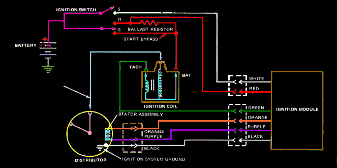

i thought i had more schematics but this should do for a start pun intended. red & White are Ign switch IDK why Dude has them on the coil or why it works like that? if the White is not connected you should have no spark during crank but it's getting power during crank from the Re wire off the coil

So as best as I can tell from tracing the wires, the black wire coming from the coil - terminal is hooked to the green wire from the duraspark box,  and the orange and purple wires are the ones hooked into the phone cord to head to the distributor. The black wire is connected to another wire that is eventually grounded to the screw that holds the box onto the inner fender. Other forums have said that the white wire is just a sensor wire, that when it sees voltage applied to it, it'll retard timing. Since it's not hooked to anything, I'm just having it start on the same timing as when it runs. If that were something I were going to fix, I could run a white wire to the I terminal on the starter solenoid. (I'd need a new solenoid because mine doesn't an I terminal. The prior owner that installed all this sold it to a junkyard, who sold it to a guy whose wife then told him he had too many projects, so he sold it to me. All the guy I bought it from did was get it to start before he sold it, but he had to put on a solenoid, and the one he put on lacks I terminal.)
So as hacked together as this is, other than not getting retard at start, my only worries are voltage drop between the distributor and the box due to a long run of thin wire, and having too little voltage at the box because it's being fed through the resistor wire, which I'd think would have ruined the box. I believe the resistor wire is still there because the 1972 yellow-top coil would have burned out if it were fed the entire 12V full-time for this long.
But once the new distributor shows up, I'll use the resistor wire to trigger a relay, remove this other stuff to clean up the engine bay, and hopefully enjoy good timing and a hotter spark from the 40,000V coil.

This is exactly what I was going to suggest.  I'd scrap that mess and start from scratch.  Running the relay you can get a clean 12 volts to the ignition.  I have used the setup on both my ignitions, first with the Pertonix and now with my Duaspark/HEI hybrid.
And yes, a 1972 would have a resistor wire because the coil and points needed to run on the lower voltage.  Only when the ignition switch was in "start" did it get the full 12 volts.

this might be what i was looking for, Duraspark 101, retrofit schematics inside
Post Options Post Options   Thanks (0) Thanks(0)   Quote Rockatansky Quote  Post ReplyReply Direct Link To This Post Posted: 22-February-2024 at 3:46PM
George says somewhere in the link in the above post that some resistance is needed
here's more info ...
