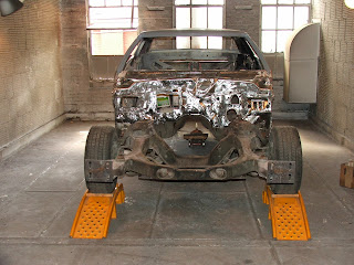

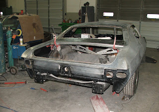

Got a text from the guys at F3 today asking if I was ready to bring the Tomato home this Saturday! YIKES, I'm not ready.... so I told them we would shoot from next Saturday, Feb 16th, so I could go this weekend and get the area at the dealership ready to receive it's old friend back to the fold.
I swung by on my way home from work and they have her about 75% ready to prime. A few more welds to dress out, a bit more prepping of the body and she should be wearing her first coat of epoxy primer on Friday!!
Here are a few shot to document her progress since the last installment.....
She has come a LONG way since I dropped her off around the end of April! Not quite are far along as we had hopped but she is being done right and you can't rush quality. Hope on Friday to have some primered shots!
The plan is for me to stop again next Tuesday for a final inspection to confirm everything on the Stage 1 list has been completed prior to bringing her home temporarily for chassis and engine compartment detailing before taking her back to the boys at F3 for Stage 2..... FINAL BODY WORK AND COLOR!
Stay tuned....

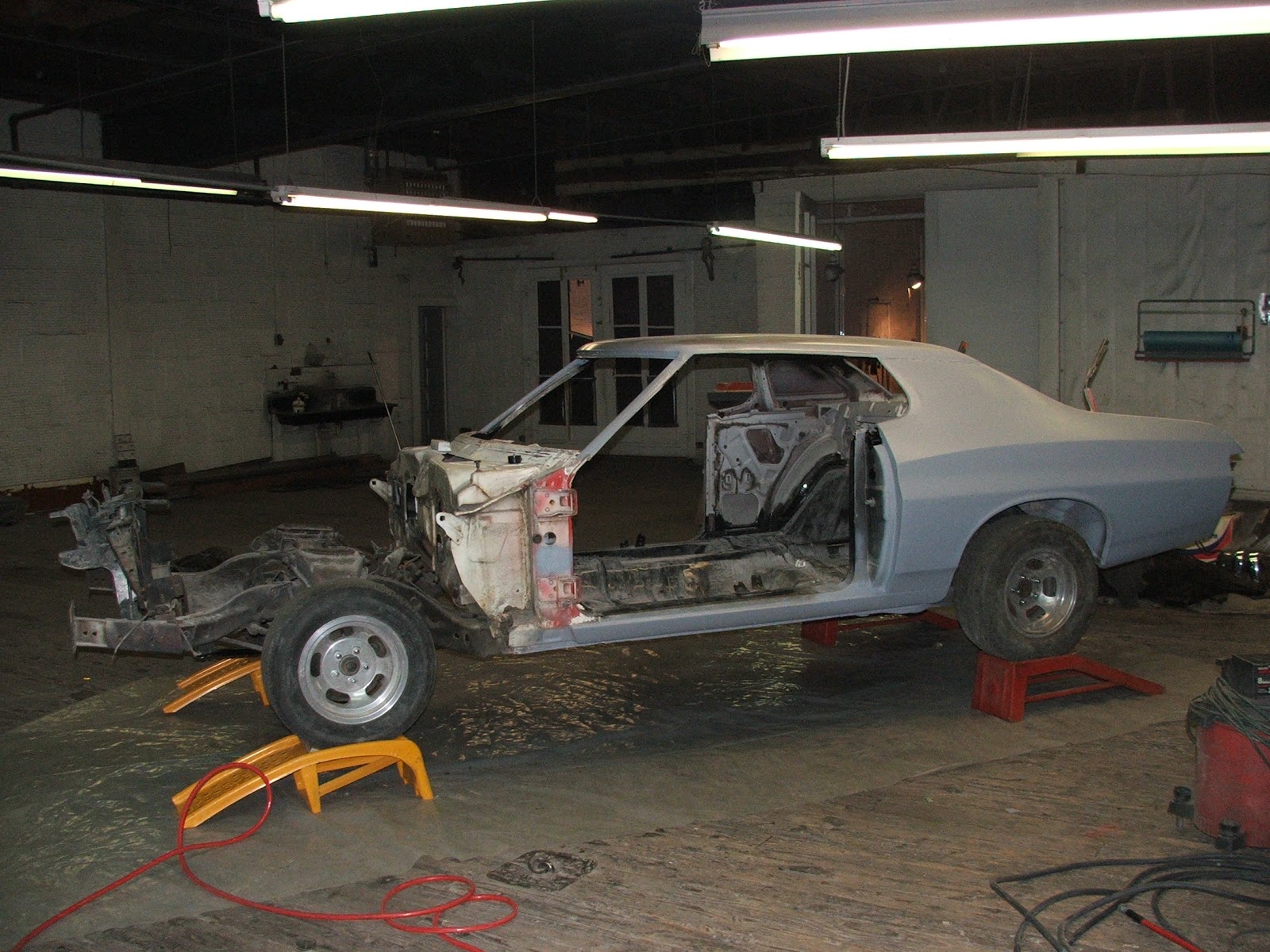

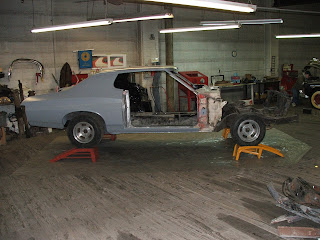

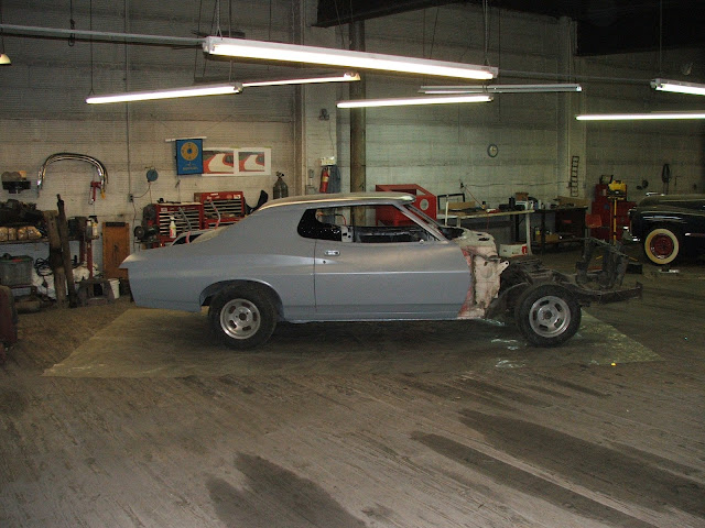

She's BAAAAAAAACK!!!
The day I've been waiting for finally arrived and the boys at F3 finally got Phase 1 of the Tomato restoration completed and returned to me. They did such a fabulous job repairing the inner structure that it's a shame it has to be hidden away again. Here is a before and after shot of the repaired inner structure...
The Sikkens epoxy primer was applied to the doors and body to give them a level of protection as well as a solid base for the coming bodywork...
and they returned the Tomato to the dealership....
so I could modify a couple things that need to be done and get the Torino up in the air to sandblast and POR15 the chassis and firewall and return it back to them for final bodywork and paint.
The guys also got the front frame reinforcement bars added while there!

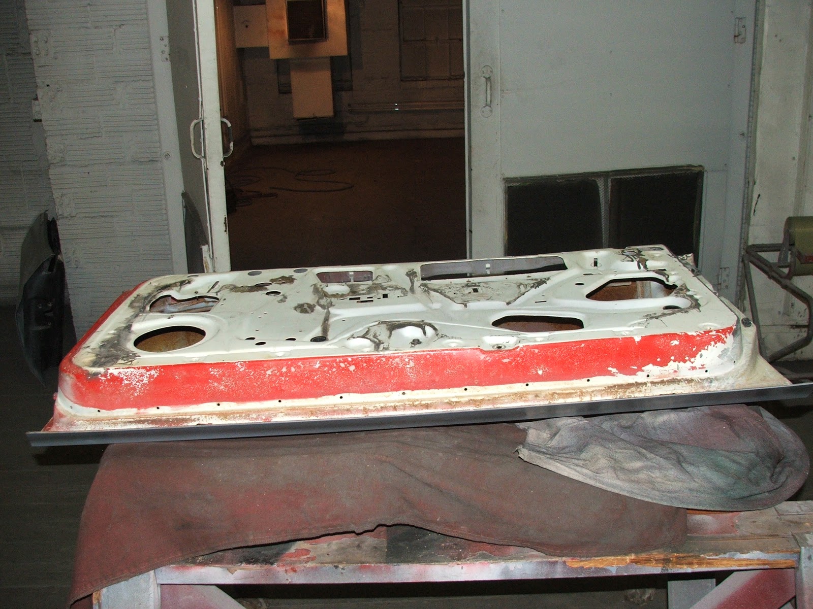

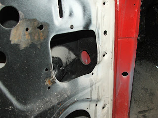

Blowin' the doors off....

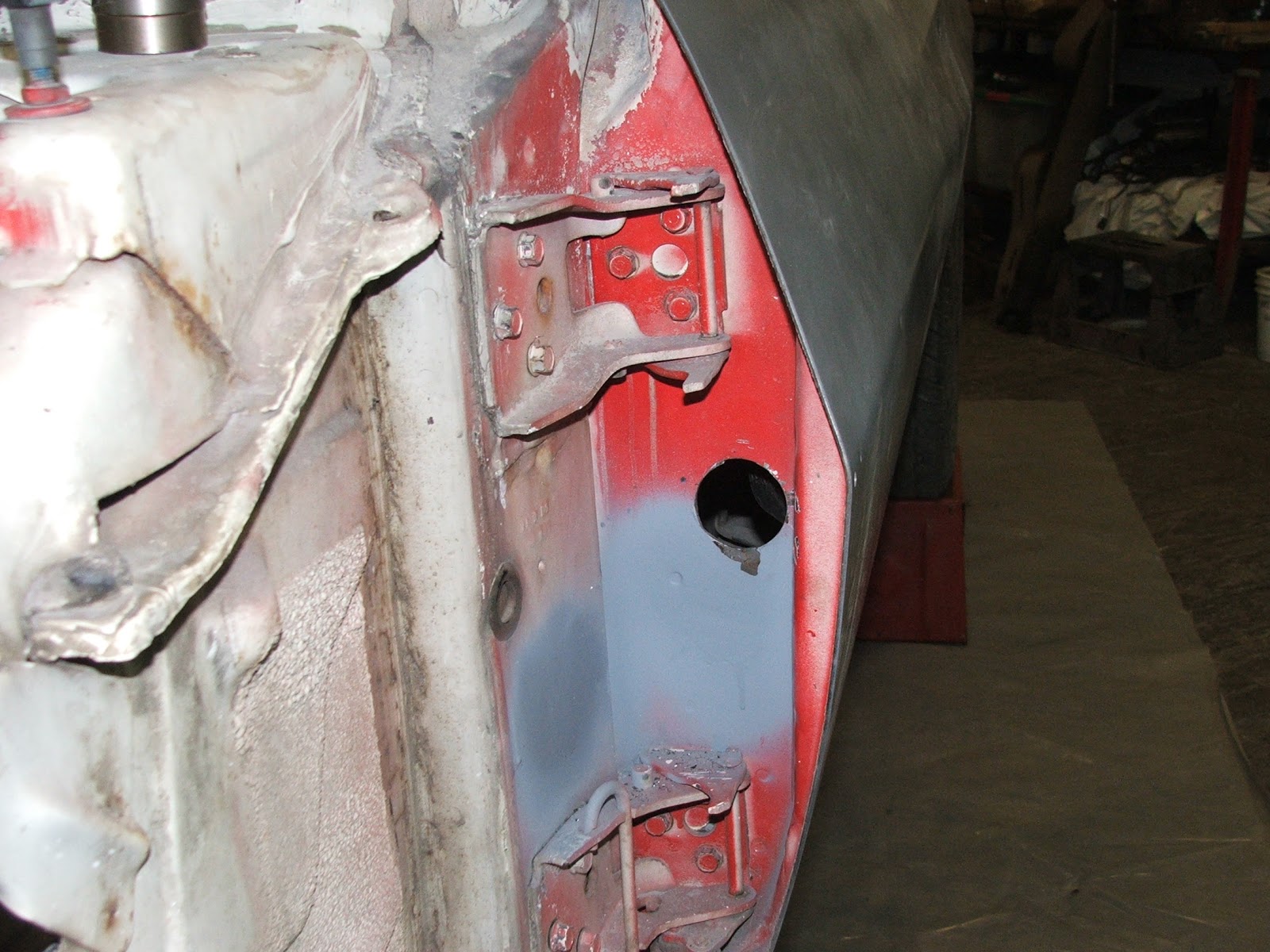

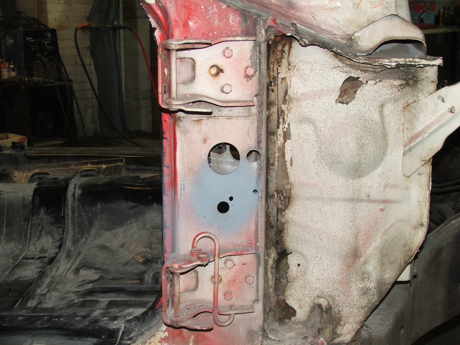

Well was a short day today working on the Tomato. The tasks of the day were getting the holes pulled for the door power feed harnesses and get the doors removes. When I purchased the power window assemblies from Jeff Munn, I had him to also send the the leading edges of both doors so I could locate everything as shipped from the factory. This also allowed me to know the exact sizes of the holes I needed to put in the doors and hinge posts so the harness bellows would seal correctly. The factory openings measured roughly 1 7/8" in diameter and I knew that would be a tough job cutting those with a hole saw so I checked at work and found the Greenlee punch for 1 1/2" conduit was 1 15/16"... close enough.
I used my step drill to cut the 1/2" pilot hole for the draw stud and with the help of my buddy Jim maneuvering the punch into position to clear the side impact bar in the door, it was a simple matter of pumping the hydraulics to pull the punch thru the thin material of the door skin and voila.... nice smoothly cut round holes in the leading edge of the doors in less than an hour......
Next step was to remove the doors so we could access the necessary location on the hinge post of the body to pull the opening cabin of the car....
With the harness holes in place we laid the first door on the sawhorses so I could begin the task of cleaning, prepping and painting the insides of the doors as well as getting the interior side prepped for paint.....
Until next time...........

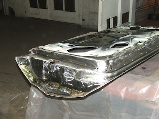

A DATE WITH THE STRIPPER
I've had the Torino back for a few weeks now and haven't gotten to spend much time working on her for one reason or another, but I am making some small gains. I now have the paint stripped off both doors...
I need to wash the paint stripper off them really well and then protect the naked sheetmetal with some POR15 PREP & READY as well as cleaning the interior of the doors and painting them with POR15 to protect them from any future rust.

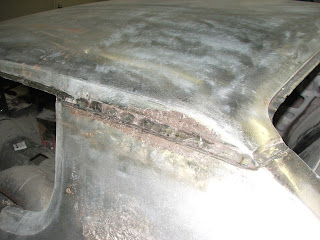

Well after several weekends doing other things, I finally got to go over and work on the Tomato again today. I now have both front wheelhouses blasted.....
I changed the 6 foot media hose on my Eastwood sandblaster to a 12 footer and it made things a whole lot easier by having more ability to move around the piece without having to drag along the blaster!
I also came to the conclusion that sandblasting is NOT a summer friendly task! Once you get all garbed up, you have to contend with your body heat rising, your hood visor fogging up from your hot, moist breath exiting your respirator as well as moisture in the air line semi-clogging your media! Not to mention the sand in your crack.... FUN FUN FUN!! LOL
Next major component to tackle... the core support. Then the fun of blasting the chassis will commence!!!!

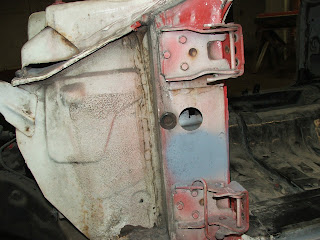

Well, got the ole girl back on the ground in preparation of rolling her into the booth to start sandblasting the frame and firewall...
I pulled the hinges so I could prep the hinge posts and strip the hinges and got about 75% of the driver's side post prepped.... (sorry for the poor image quality. Deb has the digital camera with her on her trip to Vegas!!)
Just not a lot you can get done working only 4 or 5 hours a week (if you're lucky) on a project of this magnatude, but baby steps are better than NO STEPS!

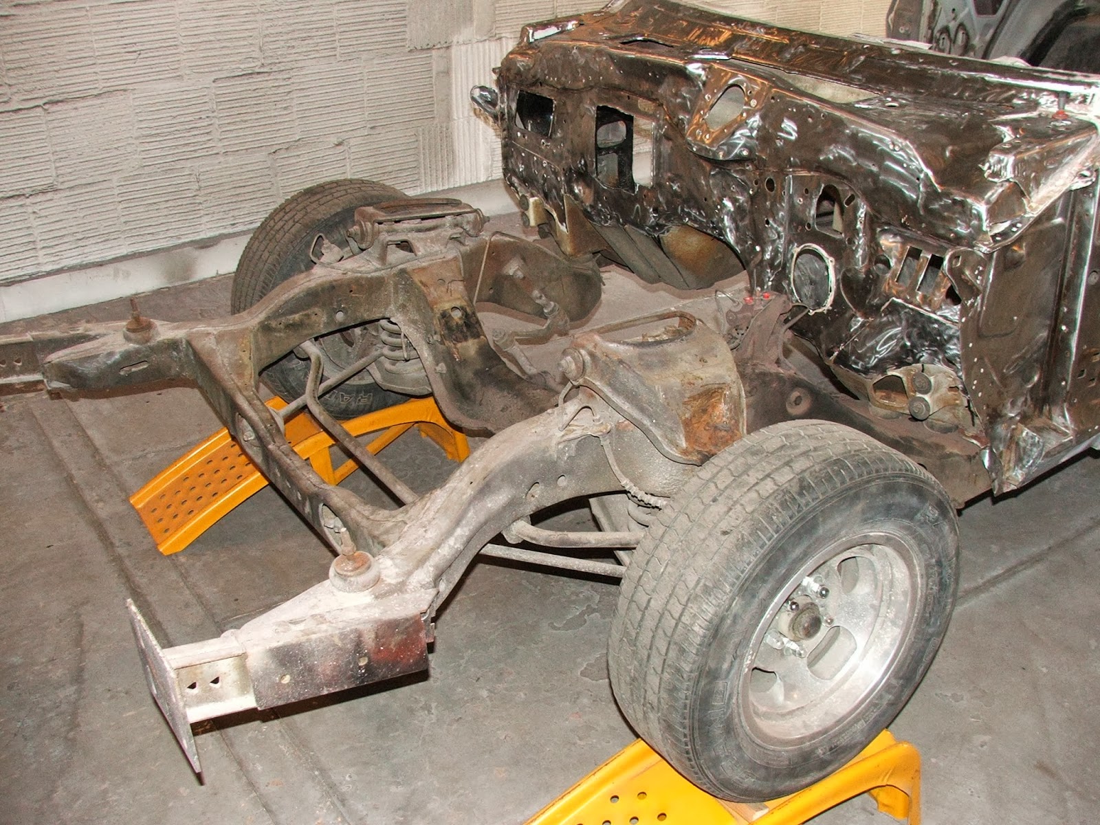

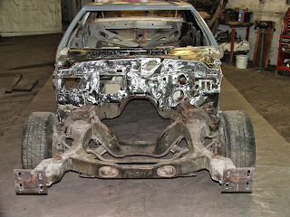

Have made some progress since last installment. I got the firewall and door posts stripped....
and also got the ole girl moved into the booth and up in the air so the sandblasting of the chassis can begin....
While she's in the booth, I'll drop the front and rear suspensions from the car so I can get the chassis blasted really good and rebuild and detail everything as necessary as I put it all back together.
