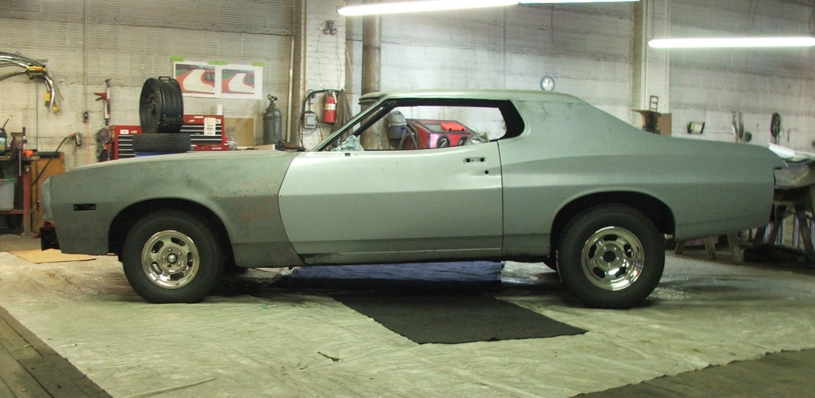

Post Options Post Options   Thanks (0) Thanks(0)   Quote TV 2M8O Quote  Post ReplyReply Direct Link To This Post Posted: 21-March-2021 at 9:53PM
Here's mine.... wagon springs and 15" tires in the rear and CVPI springs and 14" tires up front.
She is a bit high but I'll wait until I get the car reassembled to see if the rest of the components brings it down where I want it.

Post Options Post Options   Thanks (0) Thanks(0)   Quote the_waywrd_way-76 Quote  Post ReplyReply Direct Link To This Post Posted: 12-November-2023 at 11:56AM
also new to the forum I'm building a starsky GT. your picture shows some pretty big wheels in the back what size are you running currently I have 10 inch wheels with 275-60/15s stretched on them even though they fit under the well they rub on hard bumps.

Post Options Post Options   Thanks (0) Thanks(0)   Quote TV 2M8O Quote  Post ReplyReply Direct Link To This Post Posted: 12-November-2023 at 10:56PM
Wayward, yep, using a 10" wheel you will experience lip rub. On my LE back in the day I had 10" ET's with LR60-15 Goodyear's and if my air shocks weren't up all the way, the lip would hit the sidewall leaving a little cut along the path.
I'm currently using 8.5x15 American Racing slots on my tribute build with 275/60-15 Cooper Cobra's and no air shocks this go around.
