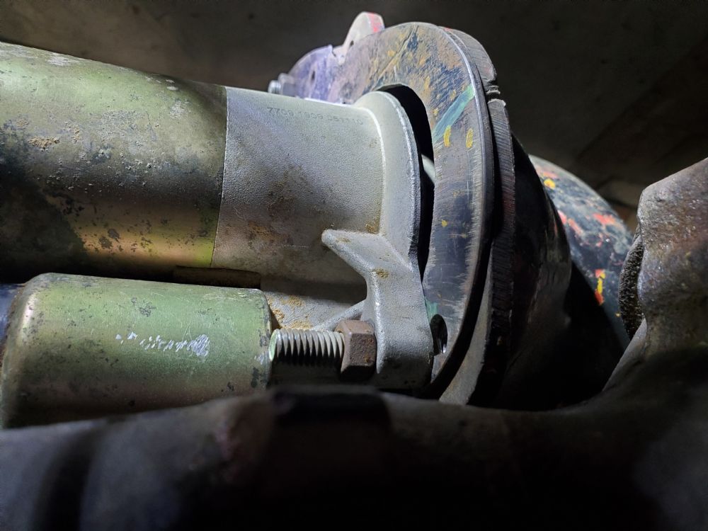

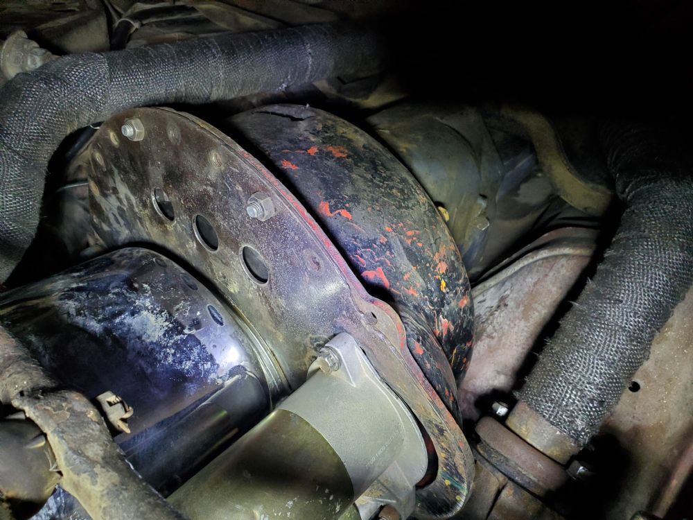

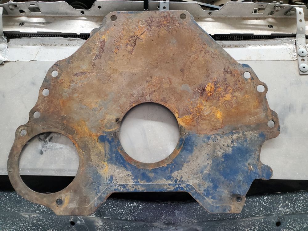

Post Options Post Options   Thanks (0) Thanks(0)   Quote RacerJames Quote  Post ReplyReply Direct Link To This Post Posted: 08-March-2025 at 12:00PM
Resurrecting this very old thread.
I have a 351C in the Torino race car with a3 speed toploader 157 tooth flywheel and an aftermarket scattershield with a custom made 3/16 thick engine plate which is the starter mount. The PO had installed a high torque starter and after I replaced the broken engine, I couldn't align the starter. after hours of pulling modifying and re installing the starter and mount plate without success, I chose to pull the trans and inspect the flywheel. I verified that it's 157 teeth, and it was holey, like someone balanced it with the other engine. I replaced it with a billet unit I got a smoking deal on.
While it was out I laid an oem 157 tooth engine plate over the custom plate and scattershield in order to align the starter (modify the mounting) one final time.
Put it all back together, and when I hit the start button it cranks, but grinds like the GM cars I remenber hearing in the 80s, when the shims weren't right.
So I perused the interwebs and Google's AI says that an AT starter is 3/8 of an inch deeper into the bellhousing than an M/T one.
So I must have an A/T starter? Anyone have measurements available?
'73 Torino Stock Car
'71 Mustang Stock Car
351C powered
Post Options Post Options   Thanks (0) Thanks(0)   Quote 72 RS 351 Quote  Post ReplyReply Direct Link To This Post Posted: 08-March-2025 at 12:08PM
Is there any chance you can use a 164 tooth flywheel? I'm presuming that late model starters will be easier to get with many more choices. I'd try hard to make a common late starter fit, then you could great options to choose from. I had heard the manual starters were different, but it's been ages since those memories were lost.

Thanks for the quick reply.
Most of my stuff has historically been AT and the block plate I used for aligning the custom block plate on the car is for an AT.
As you can see I've modified the custom plate quite a bit and the mounting circle probably isn't the problem.
I do not want to put a 164 tooth fw on it because the clutch wouldn't fit and I'm too much into the conservation of personal finances to buy another new one. Not to mention how I'm also into the conservation of personal energy. Wink

Originally posted by RacerJames RacerJames wrote:
when I hit the start button it cranks but grinds like the GM cars when the shims weren't right
the AT plate and the MT plate share the same starter bolt hole locations, the issue comes with the register hole which yours can't possibly be accurate (if it's there at all)? the difference in the registers is only .050" but the slop in the bolt holes has to be much more. just the small register starter in the large register plate will cause issues as in a wiped out starter bendix and ring gear. FWIW have you measured the register on the mini starter? what's the bendix throw? all i can tell ya is it's the precise fit of the starter in the plate that locates the starter
this was originally posted by RobbMc to the old 351C.net forum which no longer pulls up, all the links are fubar but i saved the text in my secret stash. here's the lowdown on Ford starters as RobbMc sees it
"Ford starters are a little complicated. I started working for Tilton in the 1980's and have been designing starters ever since and I still get a little confused at times.
Since the 1960's, most Ford V8 engines (except maybe the new modular motors) use one of three basic starter mounting designs .
The all use the same 9 tooth, 1" diameter gear.
Some use three mounting bolts (such as FE) and some use only two, but fortunately 2 of 3 mounting holes are in the same place so they can be interchanged.
There are three different ring gear offsets (the distance the ring gear is from the starter mounting surface).
SB's and Clevelands with automatics use an offset of 3/4". All FE engines (as well as 5.0L with T5 trans) also use a 3/4" offset. The starter register diameter (ie. the diameter of the hole in the starter mounting plate) is 4.09".
SB's and Clevelands with a 3 or 4 speed manual trans use a 3/8" offset. The starter register diameter is 4.14".
351M/400/429/460 engines use a 5/8" offset. The register diameter is 4.09". The starters for this application are easy to spot as one mounting hole is tapped.
Yes, there are several different ring gears with different tooth counts but this is taken care of by the starter mounting plates. The starter mounting plates for the larger ring gears have the register diameter further from the center of the engine.
I am sure there are exceptions to all the above, but these are the general rules for Ford starters.
If you measure the distance from the mounting surface to the ring gear and measure the starter hole in the mounting plate, you can usually determine which starter you need." ~ RobbMc
