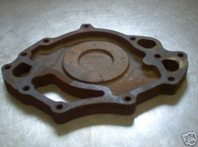

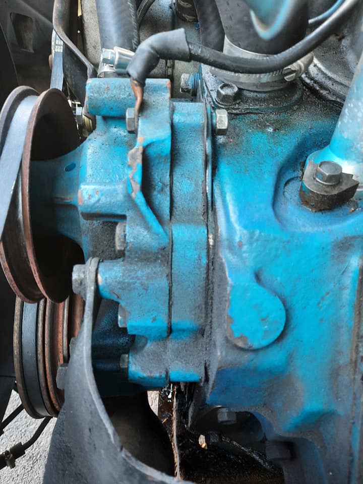

Post Options Post Options   Thanks (0) Thanks(0)   Quote Rockatansky Quote  Post ReplyReply Direct Link To This Post Posted: 12-January-2025 at 8:35AM
does your 400 happen to have the water pump spacer between the timing cover & the water pump?

Post Options Post Options   Thanks (0) Thanks(0)   Quote JBR-3 Quote  Post ReplyReply Direct Link To This Post Posted: 13-January-2025 at 4:22AM
Thank you gents.
That spacer thing is news to me, never seen that. I wonder the reason ?
