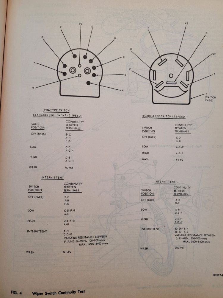

Post Options Post Options   Thanks (0) Thanks(0)   Quote 72FordGTS Quote  Post ReplyReply Direct Link To This Post Posted: 01-March-2024 at 5:47AM
I would start with the wiper switch. I attached a continuity test procedure for the different types of switches.  The ground for the motor is through the body.  There should be a ground strap that is visible from the plastic cover to one of the mounting bolts.
Post Options Post Options   Thanks (0) Thanks(0)   Quote californiajohnny Quote  Post ReplyReply Direct Link To This Post Posted: 02-March-2024 at 12:16AM
  on a 2 speed all the way counterclockwise is off,1 click clockwise is low, 2 clocks clockwise is high, thats it!
 if you can turn it counter clockwise from the center OFF position then its an intermittent switch!
 the connector on the back of the switch will be red!!! if its black then it only 2 speedWink

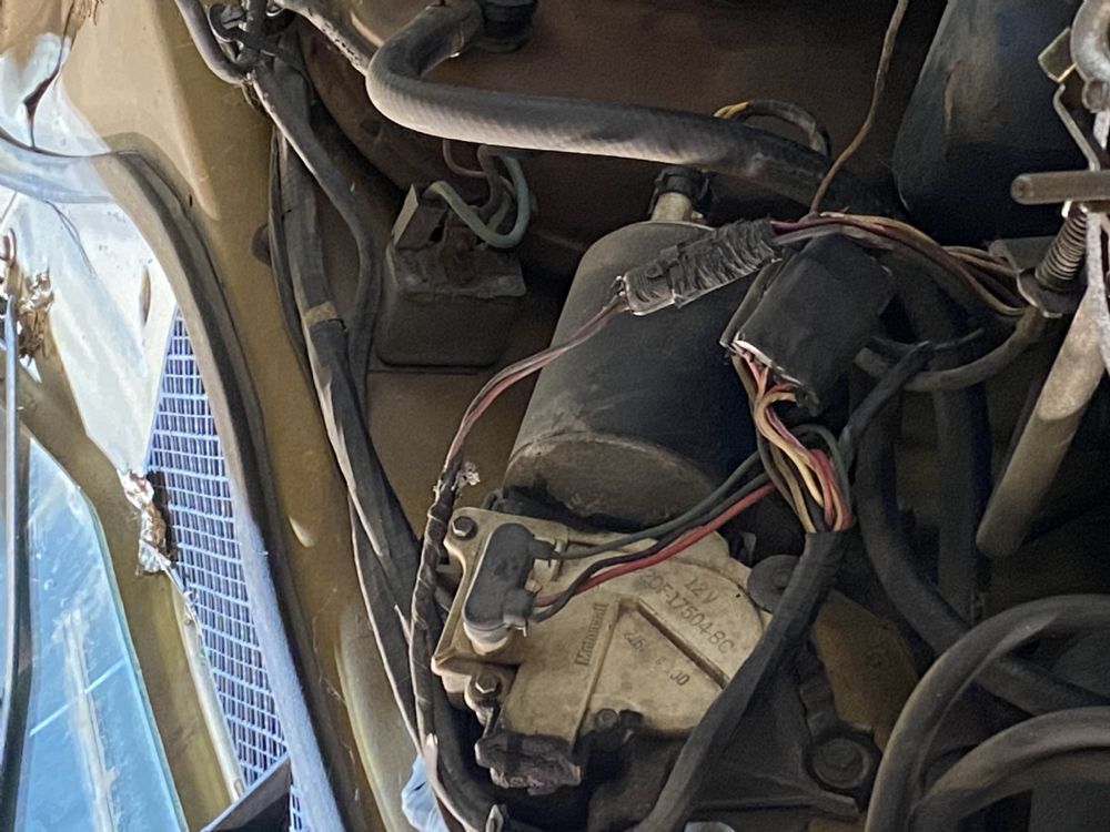

Post Options Post Options   Thanks (0) Thanks(0)   Quote aquartlow Quote  Post ReplyReply Direct Link To This Post Posted: 02-March-2024 at 5:37AM
I'm thinking(uh oh), that the governor cover(white cover in pic) on the wiper motor needs to be inspected to look at electrical contacts inside. These determine operation and park features.
Post Options Post Options   Thanks (0) Thanks(0)   Quote Eliteman76 Quote  Post ReplyReply Direct Link To This Post Posted: 17-March-2024 at 3:16PM
Likely start with the white cover on the wire motor.
Pull it, and clean the contacts with an electrical cleaner. Odds are the points of contact on the copper strips are all corroded. You can take a red scotch bright pad and gently clean the contacts off.
Other item could be the ground path for the wiper motor. Check the ground strap. Clean off the contact points on it.
